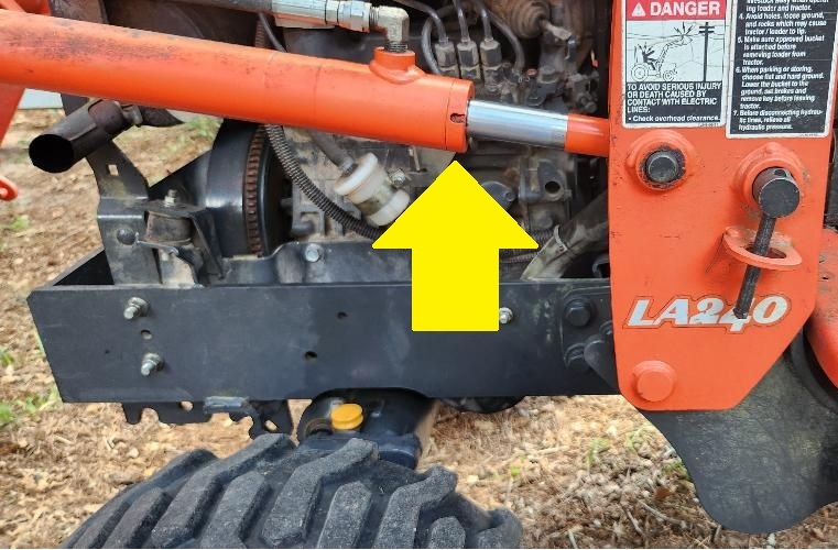

Looks like there is a serial number break on the boom cylinder kits. I assume it is referring to the loader serial number.
