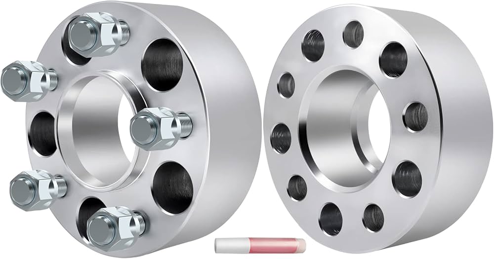

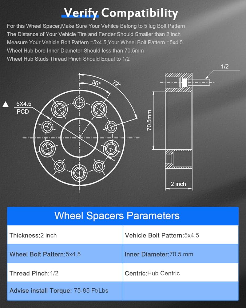

Look for bolt pattern 5x4.5 with an inner diameter 82.5mm. Several have purchased spacers for cars at greatly reduced prices. Ford Ranger and Edge of certain years fit as do some Jeep models.

Double check the inner diameter on that.
82.5mm may or may not be correct for the BX2680.

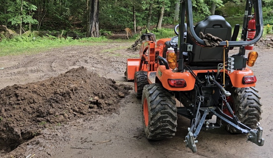

I have a BX2370, I *think* the wheels are the same as on a BX2680 but check on that.
My spacers are 10% the cost of Bora and have worked great so far. Quality is important to me and I'd buy them again in an instant. The spacer lug nut size is the same socket size as the BX front wheels (smaller than the OEM rear nuts), so I have to be mindful to not use the large socket on the smaller nuts when changing wheels and spacers.

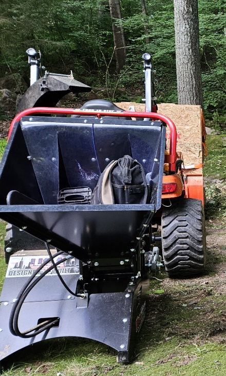

I don't run spacers when I don't need them as it's harder on the axles. I run two sets (4" per side) in the woods because the (rather large) chipper shifts around (a little) on the 3-point, and on hills that's a bit precarious without spacers.
Remember the front axle pivots so do not add spacers up front.

Thank you for your information and example. I ordered that size and bolt pattern in 2”. I think that should work well for me. Thank you again!
