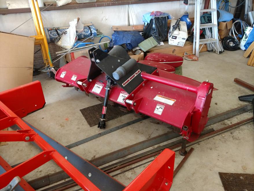

Maybe something like this?

I've had 3, forward rotating ones.For 20 years I've always added a GENEROUS amount of compost into the veggie gardens. Don't know if a reverse tiner would be any better....
6,056
3,341
Unless you are an avid gardener and plan to till the soil every year I’d beg/borrow/rent one instead of own it.
When I first got a tractor big enough to run a tiller I also bought a near-new (used one time on 1/4th acre plot when the owner died of a heart attack… still had paint on the tines)…. virtually new tiller.
It was not a “toy”…it was a heavy-duty, serious gear-driven tiller.
I found it to be near-useless on hard, never-before-plowed or tilled soil. It wrapped up so much grass the tines became clogged and it hopped on top of the soil instead of deep-tilling.
I sold it to a man in East Texas who found it perfect for his purposes (food plot for deer). I thought I’d bought it right. because the widow sold it well-below original price…but I still lost $1K in the deal before I could get rid of it. (Sold it here in the classifieds.)

Forward spinners tend to bounce out if you hit rocks or roots.
Garden tillers tend not to get a lot of use, I wouldn't hesitate to look at a used one that wasn't sitting outside rotting all its life.
Crash277
BX23S
Jan 17, 2021
844
621
i prefer the forward spin. i have the LP one for my 23s. if it picks up a rock, the rock gets pushed out the back and doesnt jam up the tiller. also a slip clutch PTO shaft is awesome. no sheer pins to screw with. takes me about 10-15 min to loosen the bolts, give it a spin (on the the tractor) then re tighten the bolts. i do that 2x a year. The clutch pto shafts can rust weld themselves together and we all know nothing welds better than mother nature.
