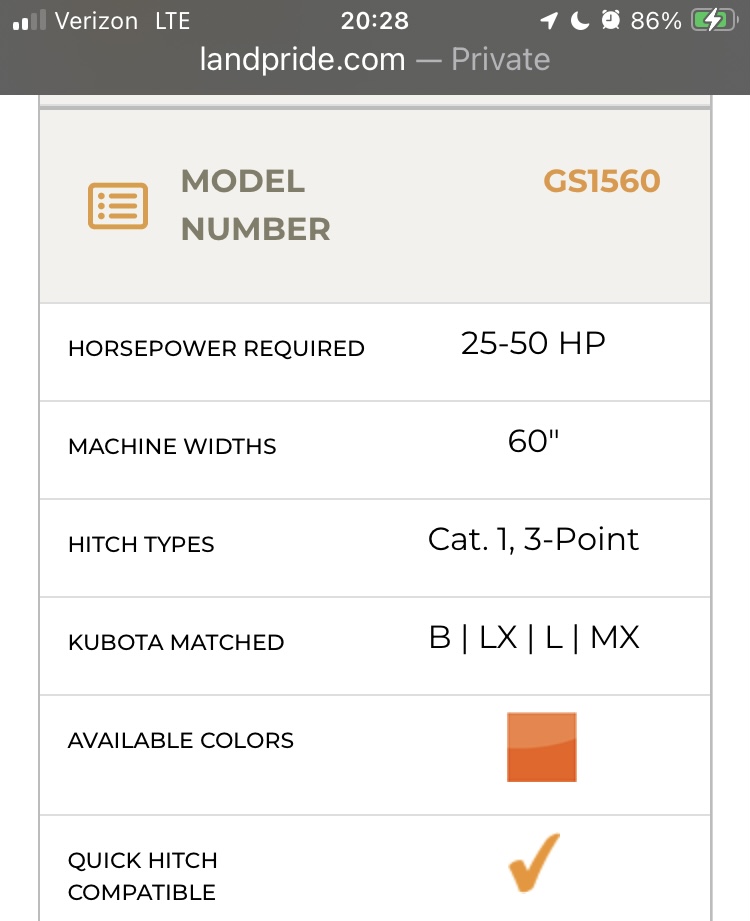

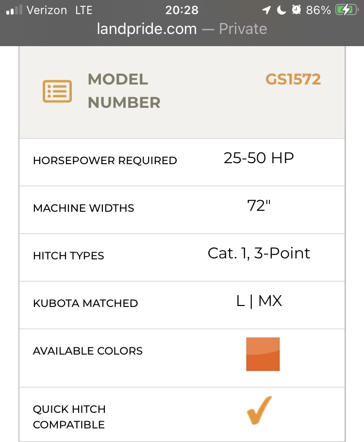

The Land Pride Kubota matched implements suggests their GS1560 or GS1572.

A couple of ways to look at these. Get the GS1572 and maybe have to baby it a bit. Get the GS1560 and go to work.
Another recommendation, get your rear tires filled if you have not already.
Lots of people figure bigger is better, that is not always the case.
Good luck with your decision. :)

I do have filled tires luckily, I ran out to the shop and measured rear tire width, and lug to lug on rear tires was around 61 1/2" not sure if it'll contact the ground on the outside but makes me think the sales guys recommendation on the 72 was maybe the correct one... I just dont wanna buy an attachment that'll constantly overload my kubota, figure it might be the right one for me though
