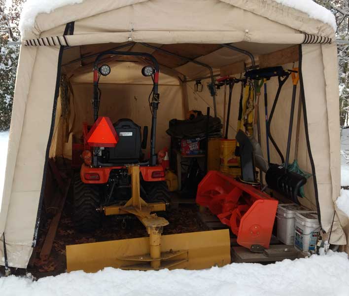

I use a 5 ft blade on my 2370. I keep the blade on all winter, and a blower on the front. Light snow falls works good, also nice for cleaning up ice that builds up over the winter. In heavier snow falls it grabs the blade, and can suck the tractor right off the driveway. In heaver snow when the wind is too high to blow, it works pretty good to push in reverse, the extra ballast is also nice when running the blower.
