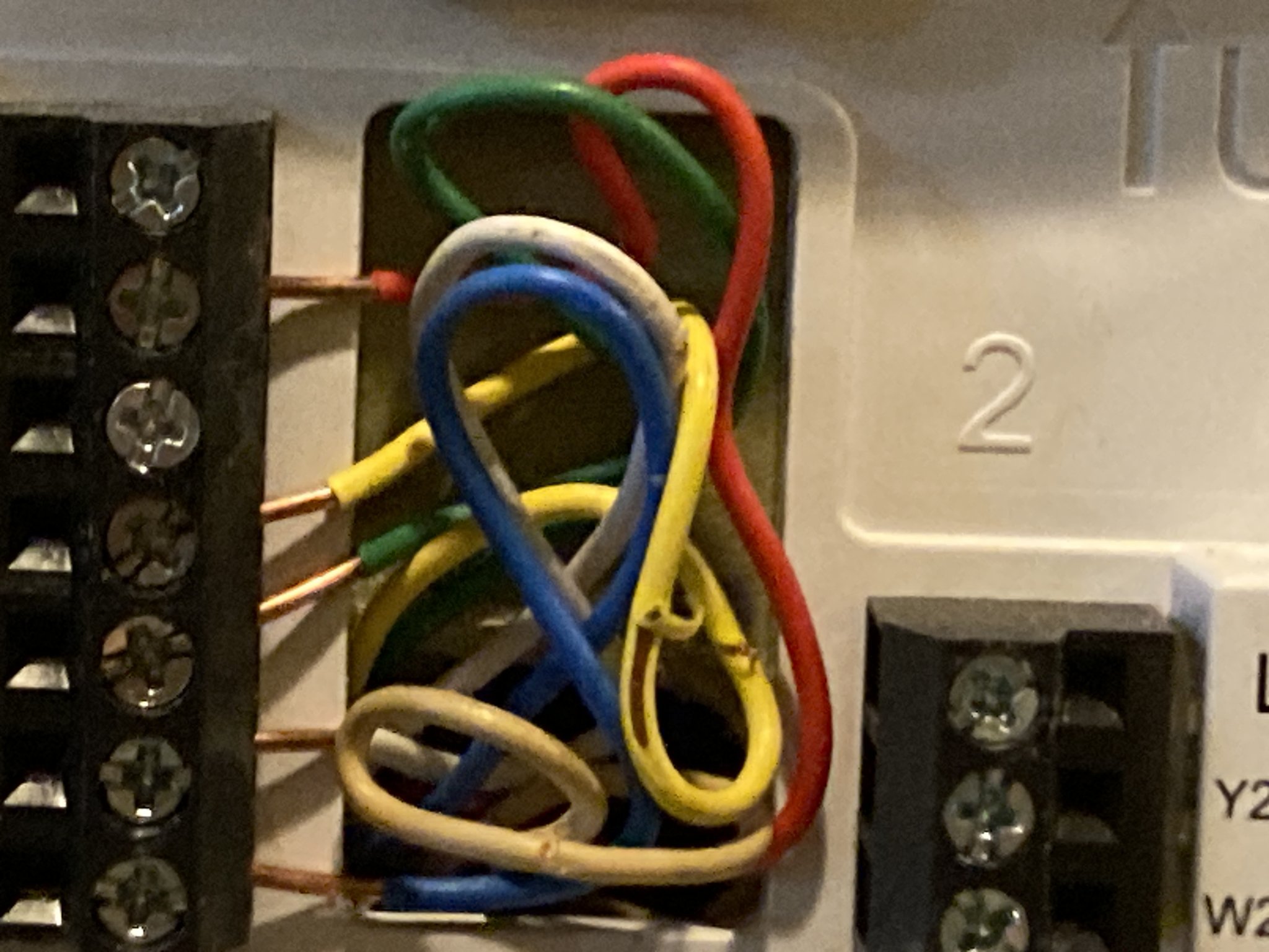

Easy enough……..I go to “The Depot” bright and early, shell out my 100 bucks and when I return, about 30 minutes later, I am the owner of a brand new Sensi T-stat (I replaced it with the same model)
I take a pic, so as not to accidentally “cross” a wire

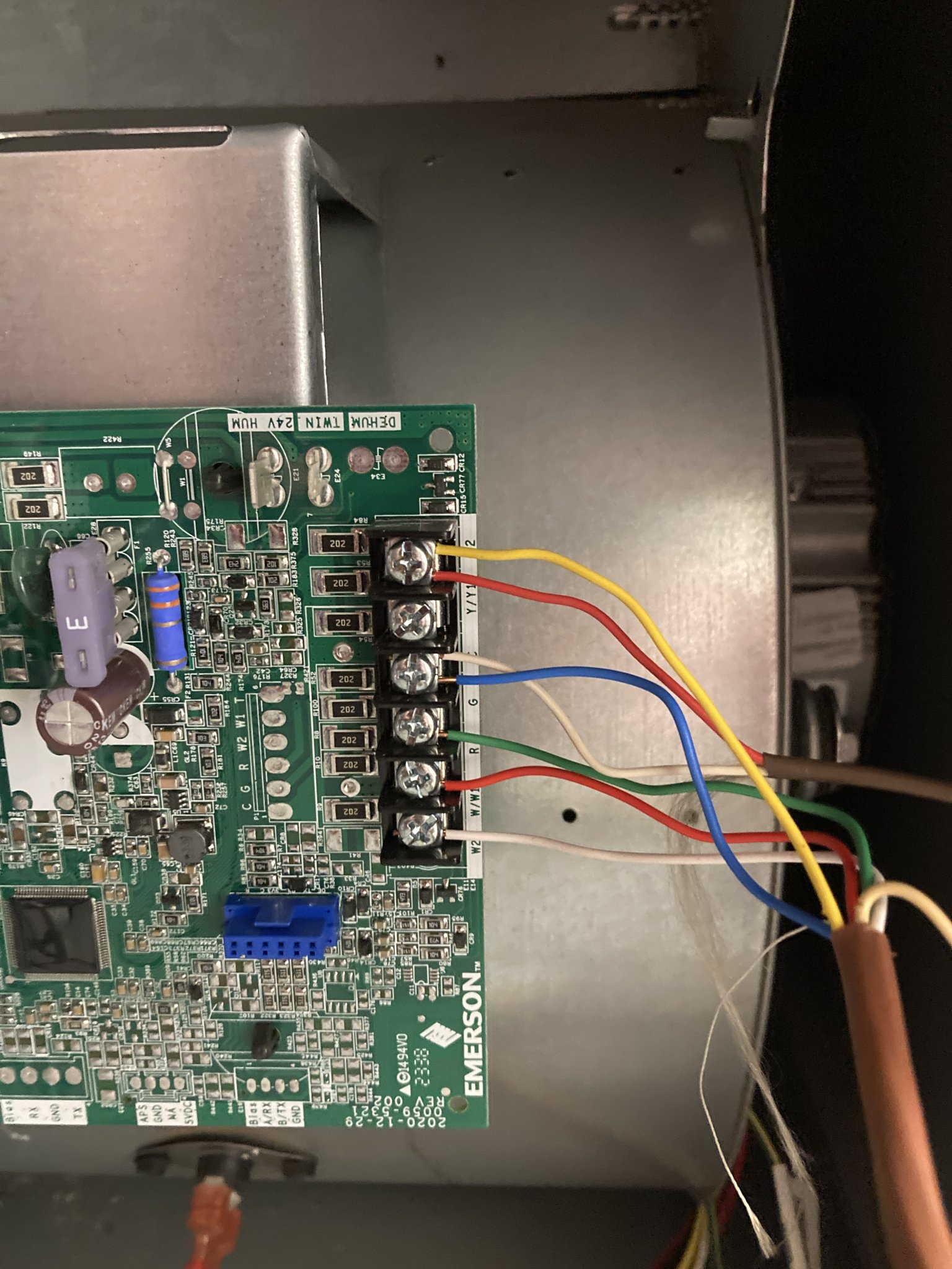

I look at the circuit board
As I put my screw driver to the board, on that bottom red wire, the furnace starts it series of “clicking” and fires up.
Well I be a “monkeys uncle”……Hmmmmmmm…..a loose wire?

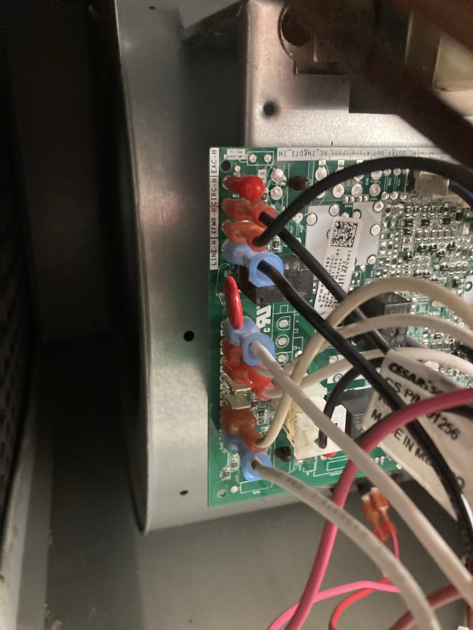

Then I spot these “relays"
Just for “kicks and giggles” (and maybe a wee bit of frustration) I tap that relay on the left with the back of my screwdriver……………….and I hear “ ClICK…CLICK….Click” and the furnace fires up.
Well “Blow me down” ……..My confidence level is nearing 100% at this point, but “once bitten, twice shy” rule is applied here.
The next morning, its again…………64 F’ing degrees BUT, I calmly walk down, tap on that relay, and the furnace fires right up…….
I test my theory the next morning, by tapping that relay, and it fires right up.

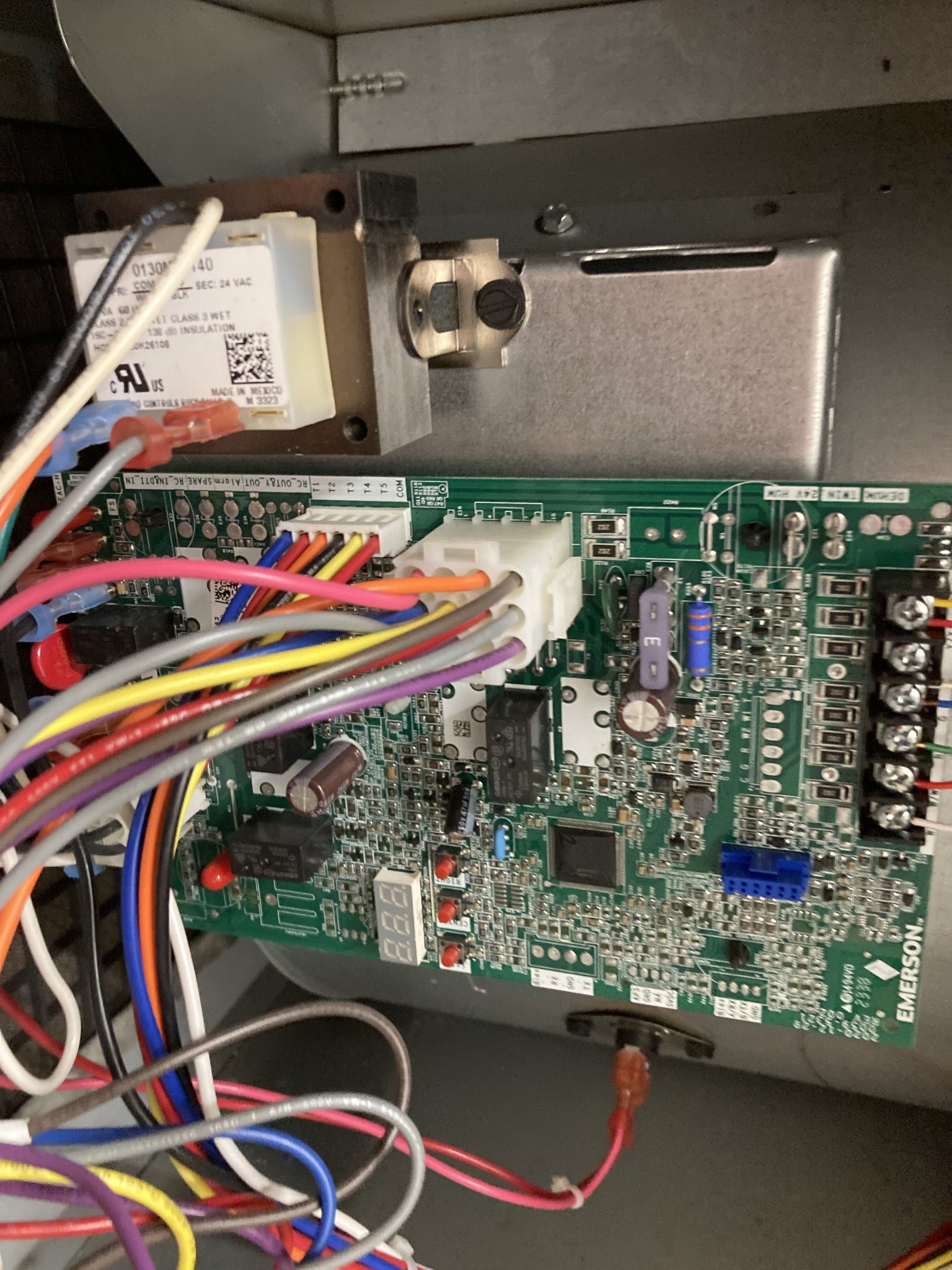

It takes 3 days to get a new board, but I take a photo of all the wires.
It takes me about an hour or so to swap all the wires, and replace the board, but she has been running good ever since.

You may find that on the original PCB, one of those 1/4" tab is not properly soldered onto the PCB. It's a bit of 'magic' to get BIG tabs and itty bitty SMT devices to be properly soldered by machines.If you wait too long, to properly solder the big tabs, some small parts can fall off. If you go too fast the big tabs don't get soldered properly.
One of my remote energy control panels had worked for months,then winter came, PCB got real cold,ONE pin hadn't been soldered,so pin was NOT connected to the pad as PCB had 'shrunk'. A 10 second soldering fixed it...plus 2 hours of roadtrip.....
also... be sure to clean out the various hoses on the 'pressure' switch plumbing ! Over time they can become clogged with 'furnace combustion debris' and give a FALSE signal of why 'NO HEAT'.
