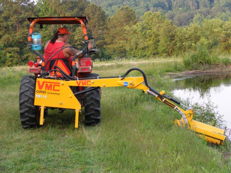

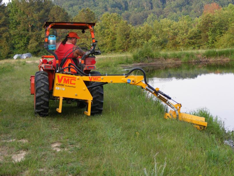

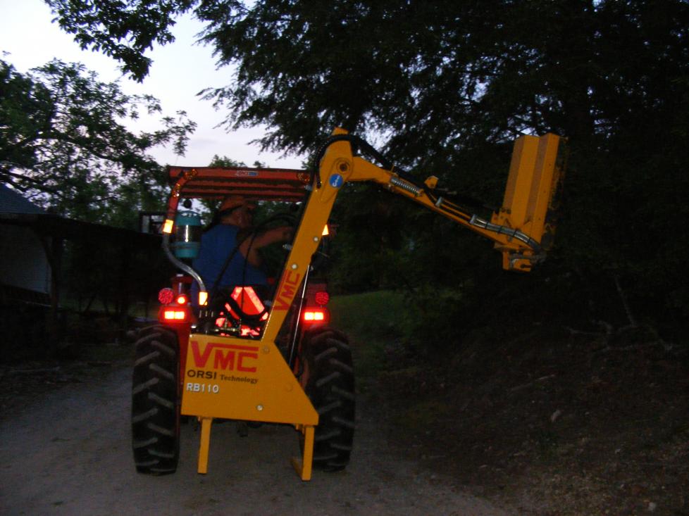

This one is a 3pt self contained unit. It's powered by the tractors pto. The flail's rotor is powered by a hydraulic motor and can be run in either direction. Clockwise for cutting grass and counter clockwise for brush. The reason for that is it slings chucks forward at the tractor so it's much better to run it backward when the cutter head is off the ground.
It doesn't really compair to a bushhog as far as the power requirements go. Even though the tractor is only running a hyd pump it's under a constant load the entire time the rotor is being powered. When I get in heavy grass or small trees the load will increase. I'd be willing to say this makes the tractor burn more fuel than anything else I use it for. My L3000 has 32 hp and 27 pto, it handles it just fine.
It doesn't really cut like a finish mower. There's hardly any grass clippings left. The flail mowers chop everything into fine mulch type pieces.
I'm going by memmory so I may be off just a little. The model I have has 10' 6" reach to the side and 14' straight up and has a 30" cut. I don't have a lot of pics but I'll send some of the better ones. By the way, if you do get one I would suggest fluid filling the rear tires if you don't already have it done. If you have any other questions about it I'll gladly do my best to answer them.
