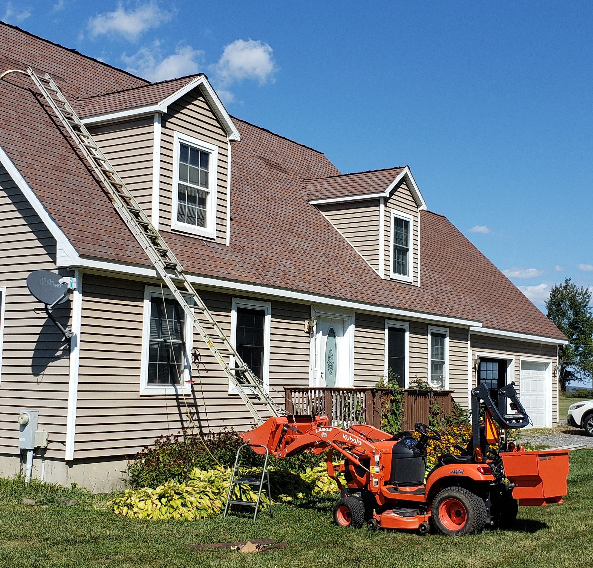

Here's an example of having to use the lock. :rolleyes:
Okay, this makes me laugh. Yes, please lock out your loader during such a maneuver, but don't count on that locking your hydraulic system. A pile of cinder blocks under the bucket and some chocks behind the tires might be helpful but could inflict unfortunate injury in case of equipment failure..... o_O
Jokes aside, one thing I've found the lock good for is to lock the stick in case you *need* to exit the right side of the tractor and have the bucket in a critical postion. It's hard not to bump the stick on the way by. No story here, just observation.
