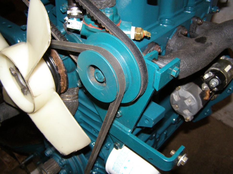

Yep , dual belt pulley wheel.
All versions that use the top mounted alternator such as this have a dual belt pulley from the factory as standard, but i dont think other spec machines destined for other markets may have them.
rob
Can you post a picture of the duel belt pulley?

Sure can, give me a little while to go back through my pics.

Here is another pic of the dual belt pulley.
This is the fitment on my B8200, Its a D950 based engine and uses a very similar bracket as that on my B7100 with a D850 unit, but same pulley wheel in both cases, just a slight variation in bracket designs allthough all use the same fitting/bolt points.
Over here a lot of B6100,7100 use the same brackets, with the D650/750 engine, i have th 850 unit but all are 70mm series engines so share a common layout.

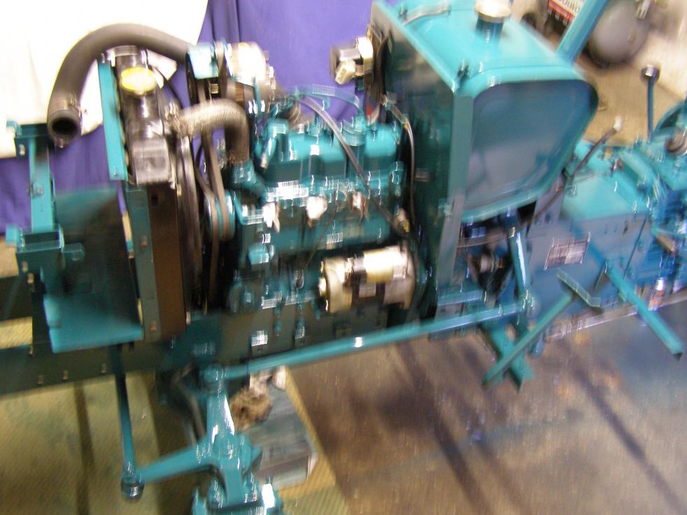

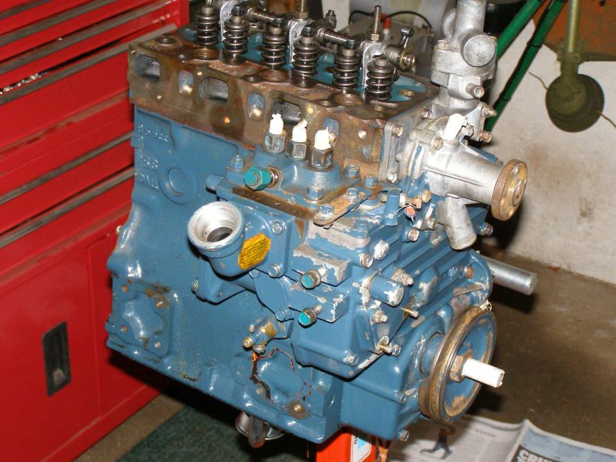

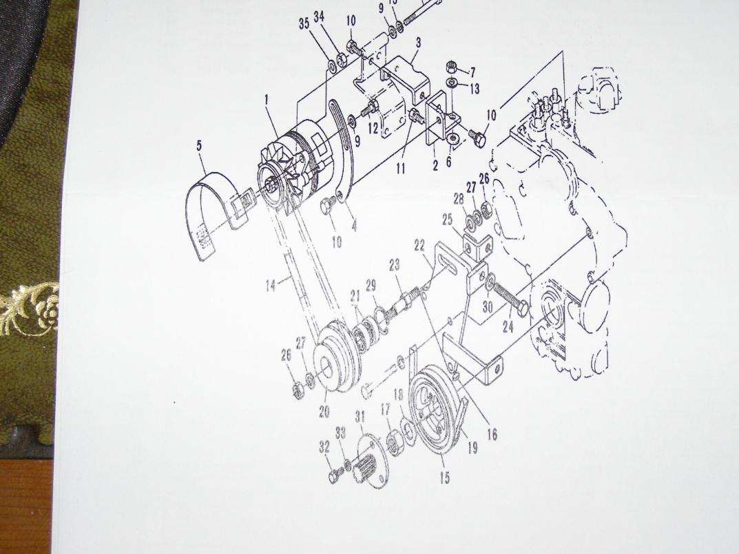

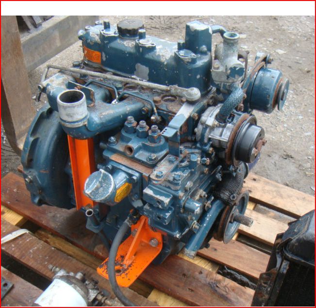

also diagram of 70mm series engines cooling setup attached and a pic of the D850 before i overhauled it and put in my 7100, dynamo was mounted on the side, i removed that fixing setup and used the fixing method that was on my original 750 engine.
There were a few issues that were not obvoius to start with, such as bolt lenghts differ etc, some fixings were with studs and nuts instead of bolts.
all worked out in th end.
last pic is of the rebuilt 850 with the top mounted alt setup from my original B7100 (d750).

Your last pic, the crank pulley, where or which model did that come from? I'm looking at the bolt-on snout with the larger splines, does this slide over the splines on the crank? What is the size of the splines? Is this an adapter?
I'm looking for a drive for a front mounted attachment. As you may know the 22 spline 27mm pulley is impossible to find.

In the last pic, the pulley wheel itself is the standard Kubota B7100 fitment, and the bolt on adapter is also the original fitment, it slides over the crank splines and then fixes with the bolts.
removed the pulley wheel on the 850 (pic 3)I then carried the 7100 items over from my D750 engine and onto the D850, just a straight forward fit as the crankshaft is the same unit in both engines.

I may have made that sound a bit confusing Sir.
The last pic is a D850 engine that i fitted into my B7100, the pulley wheel and adapter splined plate bolted to it are the original items that i removed from the old B7100 (D750 engine).
Pic 2 is the same D850 engine , but, with the original pulley wheel that was fitted to it, it didnt have the mounting bolt holes to facilitate the fitting of the smaller adapter , so was of no use to me.
Forget the fact its on a 850, all you need to be thinking is that those pulley wheels are a B7100 original fittment.
