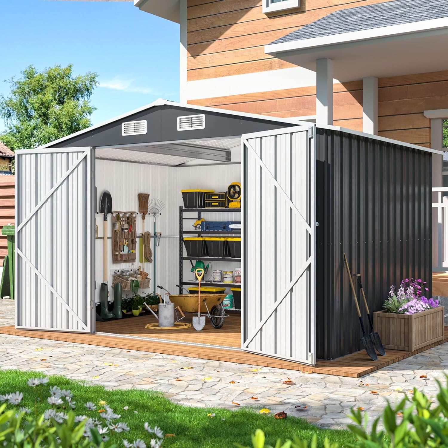

Is a metal shed an option for you? The one below is $250 on Amazon.

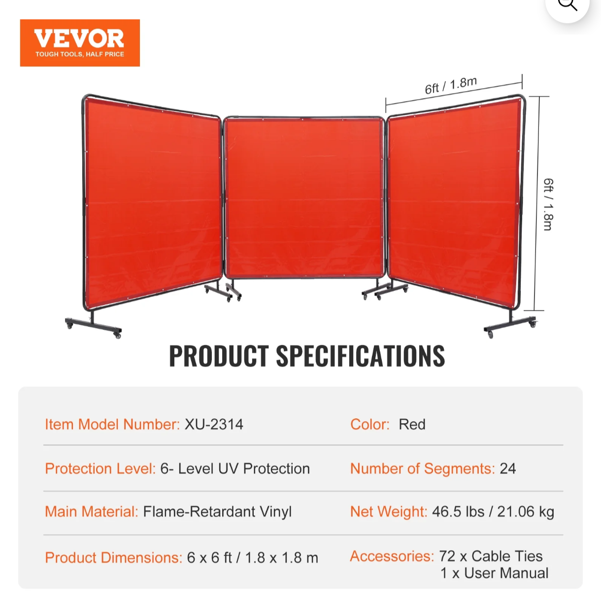

How about welding curtains? I've seen them used to contain sparks, block the wind and protect bystanders from flash. This set is less than $200US, can't vouch for the quality.

So it looks as if it will be a wind screen outdoors. That Vevor screen looks promising, thank you for the link, had not come across that in my search. Not suitable for the 24m/s wind speed (average) we had today, but I would not go outside in those conditions anyway.
So a movable, collapsible weld booth for outside seems to be my best solution.
I've bought an exhaust fan from Vevor, and something else I don't recall. Quality is not impressive.
However, with something that simple (no moving parts), it's probably okay, and the price is right.

Yes, you are right, I would not expect top quality. But typically the chinese made things are generally ok, just need a bit of modifications to get it right. And for something like the screen it would probably ok.
I thought about using boards or corrugated sheet metal for a shelter, but the screens would be much lighter and easier to move when I need then.
I will also have a look at the shed type that @lynnmor suggested. I would not even need anything that size, so maybe there are smaller ones available that can be quickly assembled. I like that it is fully enclosed, so the wind problem would be definitely gone.
