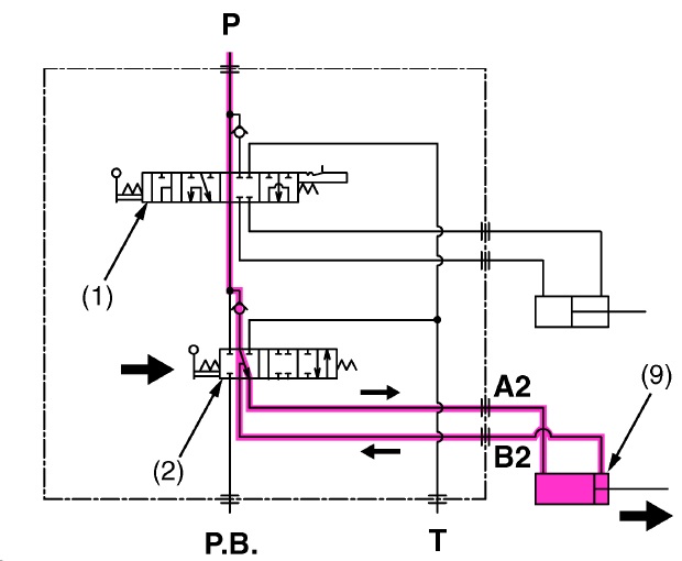

From Loader WSM:
Return oil from the bucket cylinder (9) flows from the B2 port to the passage 2 (8), and flows to the A2 port together with the pressure-fed oil from the P port.
As a result, the dump speed is increased
Dave

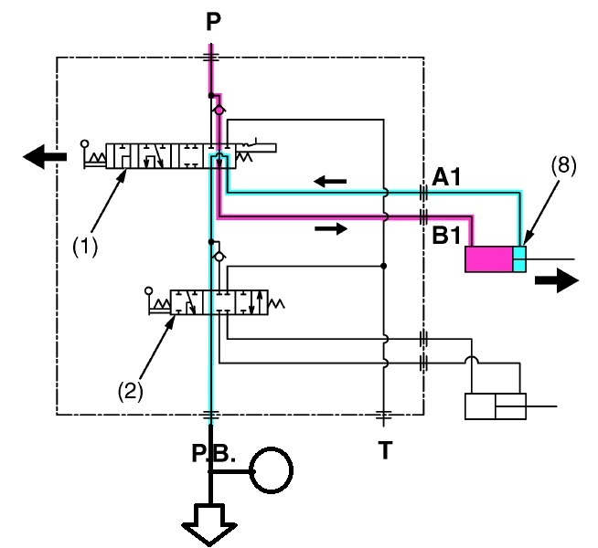

What's bothering me is I cannot reconcile that description of the regen flow and the described behavior. I have the WSM for the LA525 and it has the same flow description. The flow diagram also shows P disconnected from PB and connected to A. If a downstream valve is affecting the cylinder circuit PB must still be at least partially connected. And even then the unequal piston areas should still actuate the rod.
The curl function in my WSM shows P disconnected from PB and cylinder connected to T. Again , no way for a downstream device to block the cylinder.
I have included pictures of the flow diagrams for boom cylinder and regen. The boom actuator is in series with PB and will be affected by any downstream load. The dump function appears to be completely disconnected from PB and should not be affected by a downstream load or device.
In any event my original diagnostic suggestion stands. Put a pressure gauge on the PB circuit coming out of the loader valve as I have sketched in on teh boom diagram. Looking at the parts breakdown for that tractor it should be easy to insert the tee on the PB port on the hydraulic block. With all valves in neutral the pressure in that circuit should be pretty low - 100 PSI or so. If it is not something downstream of the gauge is obstructing the path to tank.
Regen Circuit
Boom Lift Circuit
