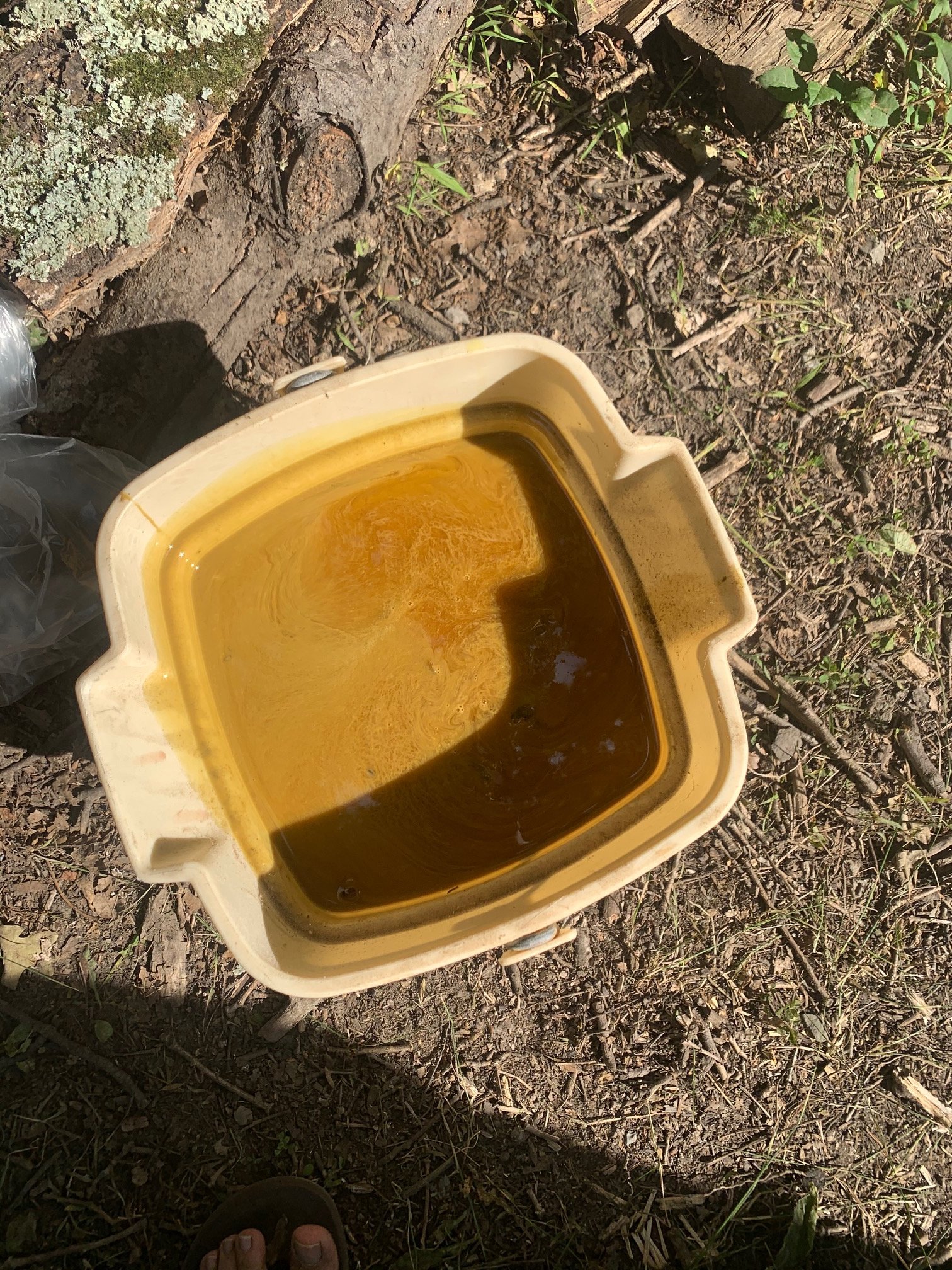

I posted a few days ago about two B6000's I purchased in this thread. Today I greased all the fittings on both , cleaned the air filter bowls of sludge and did a hydro flush on the B219 Loader. It was pretty decent aside from clogged screen and old ATF in it.

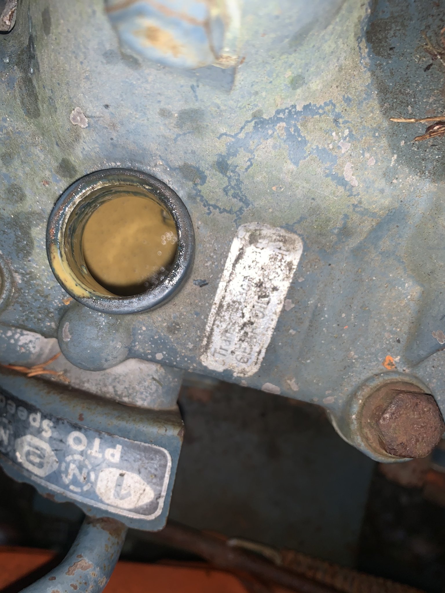

Then I took a look at the trans case... mustard yellow.
So I guess I know what I will be doing tomorrow. Any concerns or advice on it? Is there a screen in there as well that is serviceable?
Manual says 80 gear Oil but I have seen people mention UDT in there now, any suggestions?
Thank you!

You had 32 views & no replies...I'm no expert but what I would do is a flush...Drain, change filter if it has one, clean the screen if it has one.....fill it with the cheapest oil you can find, run it a bit, drain, & refill with the fluid as recommended in the manual....I don't think you can do any more harm than already happened, if it did....I did a service on a "B" model with an HST that the cap was missing for years & the fluid looked much like yours.....I changed the fluid & filter, filled it back up with the recommended fluid, sent it on its way, & never heard a word about it....I think you'll be OK.......Good Luck......

The loader has a separate reservoir that is the right vertical upright of the frame. I pulled the low pressure hose, took off the breather and screen and took out the drain plug and screen. Cleaned the screen and put it together and refilled with fresh hydro oil. Ran it for a few minutes cycling the new fluid and drained again. 2nd drain was slightly pink with ATF still , but close enough so refilled and it operates great now.

Going to NAPA and picking up 10 gallons of gear oil for both machines trans, 4x4 front diff , and 5 gals of 10w30 for the engine oil change shortly to get these both cleaned up lol

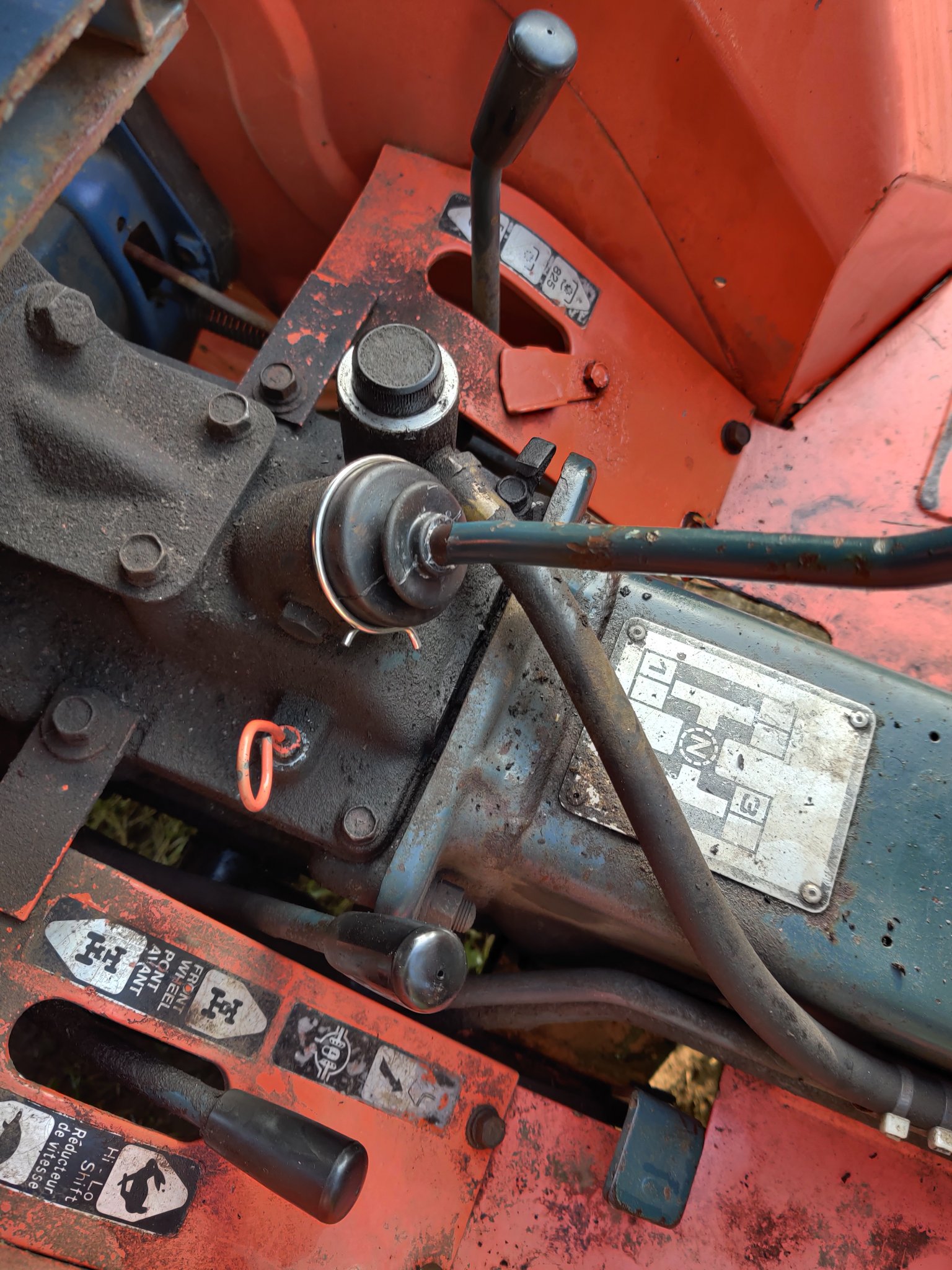

Are there any gear levers on top of the transmission? Is so is there a boot on it to keep water out?
^^^ This is how I got water in mine. Boot is cheaper than the fluid so it doesn't happen again. I bought 5 gal of Universal Tractor Fluid and 5 gal of Utility Tractor Fluid (Utility fluid is cheaper). I plan on changing the fluid 3 times. 3 gallons per change. Starting with the cheaper Utility fluid to run it through until warm and immediately changes it again with the remaining cheaper fluid and a gallon of the universal, run that for a few days to a week then the 3rd change with just Universal. I'll check and change it once more before the winter.

Confirmed the boot had a tear in it on the backside. ordered two from Messicks. In the meantime I drained the trans....
Looked like a newborns diaper. Took 6 gallons of Gear oil to fully flush it from all drain ports before it was clear. Topped it off with UDT and now moving on replacing radiator and belts for FEL and fan.
