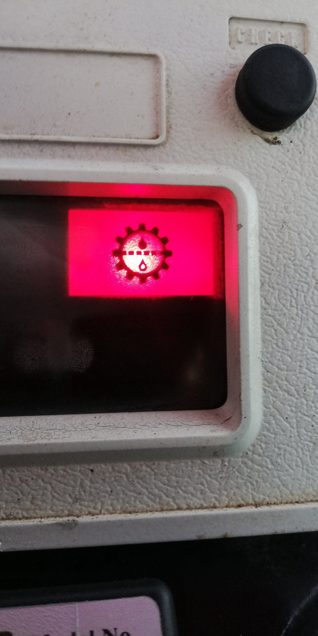

I have a kabota L2402DT tractor and don't have a manual for it.. Looked everywhere on the Web and can't find my answer..
My question is I have a dash light come on and stays on.. It's a symbol of a cog with two water drops inside it, can anyone tell me what's the warning for..
Cheers in advance

Check your transmission oil level. If the light is on, I wouldn't operate the tractor until the light goes off. Call Kubota technical services and ask them 1 (888) 465-8268
