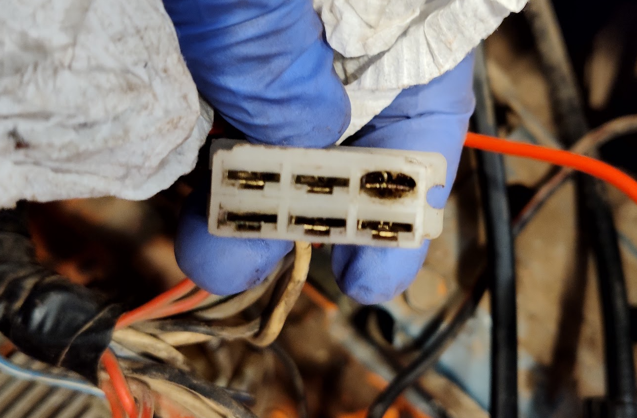

I've having some intermittent loss of power on my Kubota B8200 after doing some wiring work. In the process I see that one of the contacts is corroded and has overheated in the wire harness connection to the voltage regulator. I'm trying to determine if that is my issue, or just another one to add to the list. and want to see what symptoms it might cause.
Your description of the connections will be helfpul as I muddle through the wiring diagram and troubleshooting. I was planning to at least depin that female quick disconnect and crimp on a clean one, but haven't yet been able to get it out. I may try to find a new connector and remove all the pins.
