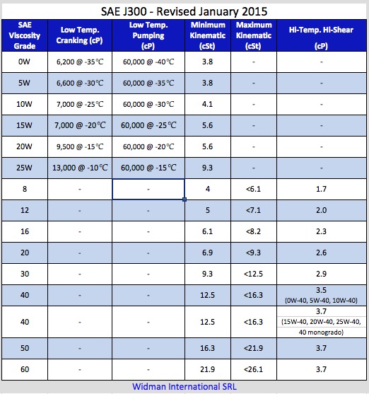

Odd.... I'd expect both 5W to be the same at room temperature. Got to be something off with that test.
A better test would be a drip test. A quart and a tiny hole for each sample and time to drip a quart. Oil rating is viscosity, 'thickness'/ability to flow not film strength. Do this test in a freezer, then again at room temperature then again heated to 180f.
