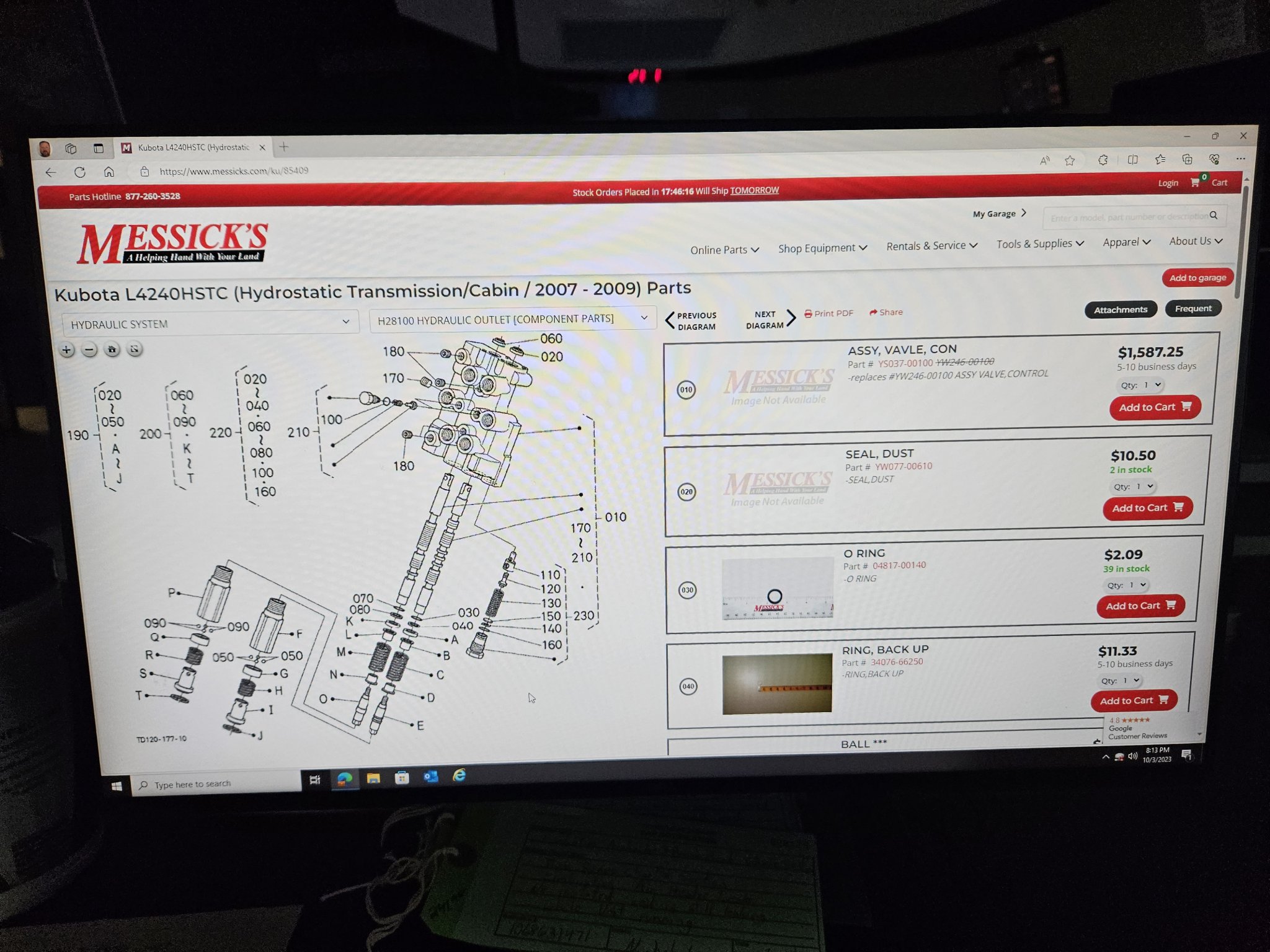

I finally had time to do some more looking into the problem. The part "O" apparently is broken off and the bottom half came out and the upper half is stuck in the valve body according to the mechanic. It seems to me that the part it would be threaded into is the spool that moves inside the valve body right?

Could be. That's not inside the valve body. it's part of the detent mechanism inside the cover on the back of the block. Bad news is that is not an ordinary bolt and based on what I can see in the diagram other than the balls and a few seals those parts are not available.
