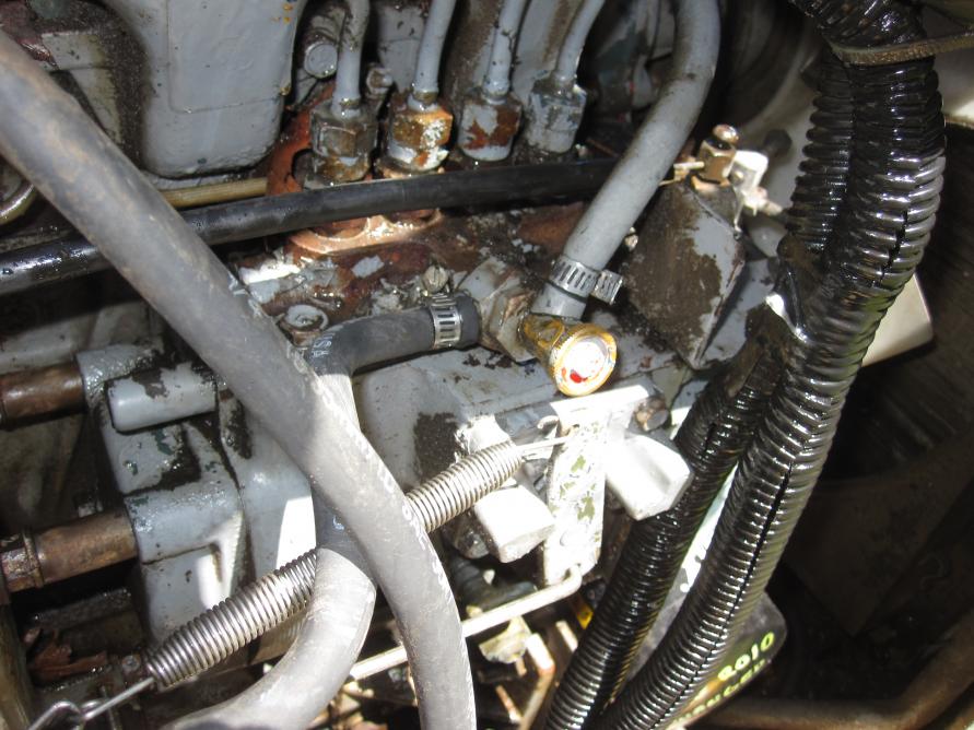

Pictures?
mntoys
Jun 20, 2017
Mahwah NJ
This is the injection pump.
I don't see a fuel lift pump. I think that is a block off plate where the lift pump goes.
