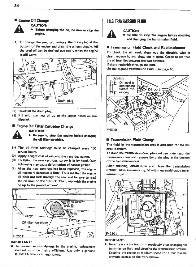

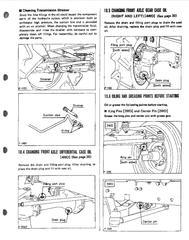

I need advice, not condolences. Most forums members usually serve up more suggestions than can be tried.
I attached the owner's manual pages, since the shop manual does not have much for maintenance. Pretty straightforward. I know about the screen cleaning. Anything *else* I should do or check out while I have this gear tractor transmission drained? Do I need to do anything special to drain the power steering system? Anything to look for in the old fluid, like chips or filings?

View attachment 44015 View attachment 44016
Sorry Lloyd, sometimes we get sidetracked, just how we roll here on OTT.
The 'power steering' is hydrostatic and operates from the same fluid in your transmission so following your OWNERS MANUAL and removing the drain plugs and renewing the filter (use a genuine Kubota filter) will drain all the systems.
On the front axle, you can use the Kubota fluid or 80-90 gear oil. I run gear oil in my FWA axle because I shock load mine and the 80-90 gear oil provides better shock load characteristics than the UDT (any flavor does).
