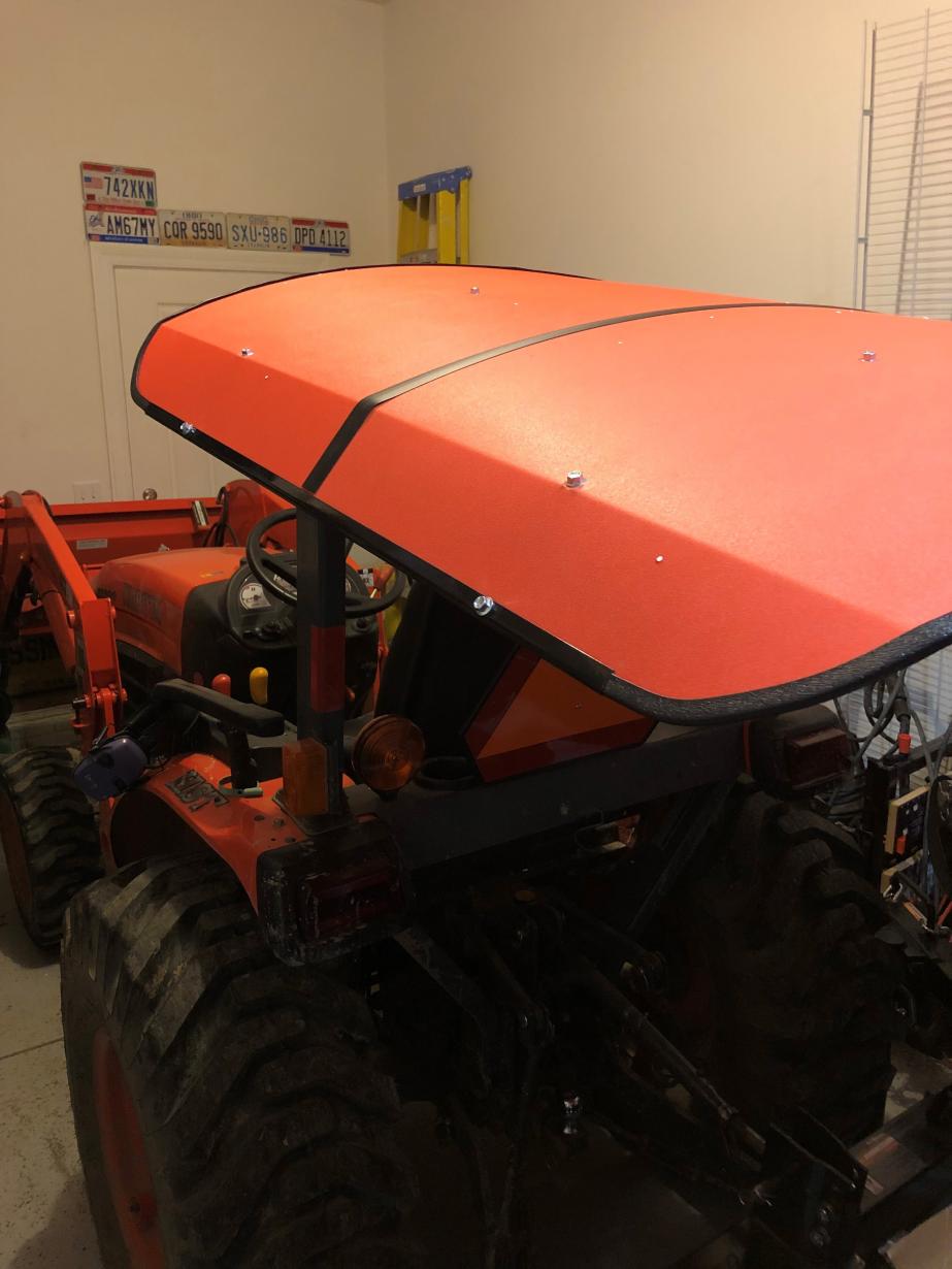

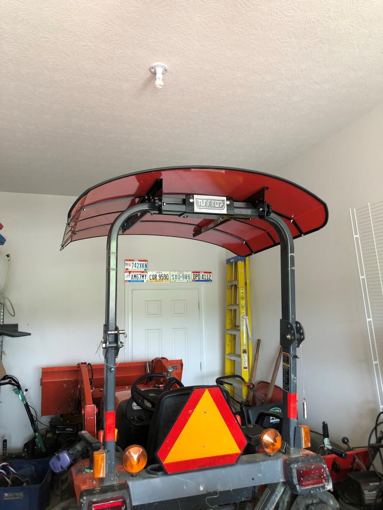

This time I went with the Femco Tuff Top 48x52 size. I got it off Amazon, Farmer Bob's Parts. I can say that I am very pleased with the quality of the shade, the ease of assembly and overall fit and finish. Bonus in that it came in Orange. All metal parts are nicely powder coated and the system fit together without much fuss. Total time from out of the box to pictures was 1.5hrs. Tools were minimal with a couple wrenches, pliers and a clamp to help bend the edges over to attach the ribs. The exploded diagram was helpful when you had questions. No parts were missing
I was up against graduation parties and thunderstorms this past weekend so I was unable to get it outside for some additional photos. I'll get a few more and post them here this week.
The underside supports offer me options for mounting a mesh shelf that I can use for my cell phone, hearing protection and other small items. The top itself attaches with 4 knobs. Loosen them, pull to the front and the top swings down or lifts off. You can also adjust the pitch of the shade if needed. Using different holes in the supports offer you different angles for different tractors as well. The top is a bit heavy and slightly awkward to remove and step off the tractor. I found removing it, setting it on the seat, dismounting and then removing the shade from the seat works best for me.

Vibration is minimal. The knobs on the shade need to be tightened once upright. I'm getting a bit of noise from where the top of the ROPs is knocking against the pins at the hinge. I'm going to glue on some rubber strips to see if I can't silence it a bit.

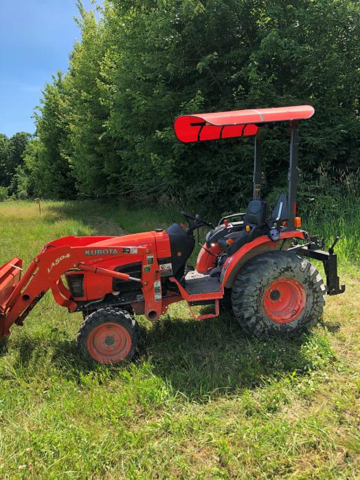

My guess is the one shown here.... being higher.... is why they choice a curved design. Helps block the sun from the sides compared to it just being flat. Other companies stay flat....... but have it sit lower for same reasons. to block sun from the sides. Lower type may be better if your working around trees, branches ... tall brush though

I am happy with the height. Easy to get on/off and not whack your skull. I would not want it lower. The color does not absorb heat like a black one would. Folding was key for me having to park in a standard garage. Not having to remove it every time is a bonus. It is easy to remove (just a few twists on 4 knobs and lift off) but if you don't have to, then why. I added a few outdoor shots after brush hogging this past Friday for 3 hrs. Very happy with overall coverage and cooler temps.
