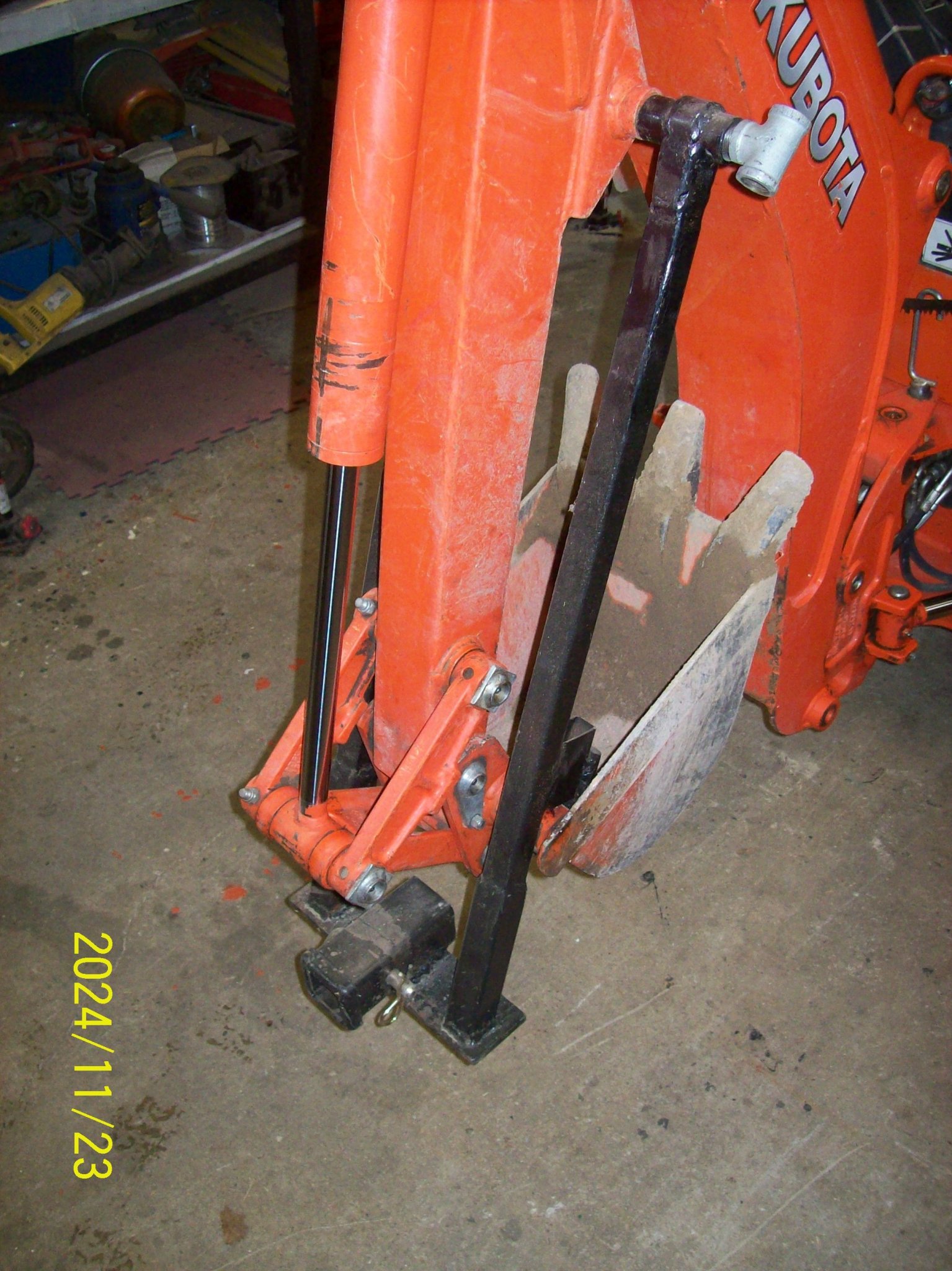

here's what I did, it's version 2 point oh. Actually moves my empty 6by10 tandem dump very easily.
takes 30 seconds to install.. hard to see ,but there's 'hooks' that are in bucket to keep units 'solid'.Not fancy or store bought, just scrap laying about.
the problem with a 4' long bar in a 2" receiver is that when you put trailer onto it, it'll probably bend down and touch the ground ! I have one of those official 'bed extenders' and had it dragging when loaded up with few 100#s of steel sheet. same 'math' as pallet forks don't lift much 3' out from loader....
Your device looks wonderful, Greensville,Jay. I don't think I could make one of those.
And, having the 4' bar touch the ground...I was thinking of that after posting. Good catch. Maybe I could use some pipe strapping or some kind of chain set up to go around the bucket and under the 4' extension. Then, I suppose there would be trouble with turns. A woman can dream, can't she? :)

hmm, the receiver and 4' 'extension' will work IF you support it from the bucket. You'll have to keep it from moving 'left-right' though ! maybe use a chain 'crisscrossed' to limit movement to 1" or less?
heck, even 2by4s cut and screwed together, 'as required' will work

Thinking about bolting this to the bottom of the bucket?
Tractor Gal
BX23D MLB
Oct 30, 2020
524
176
NC
No, I'm going to try to use U bolts to attach vertical 2 X 4's and then figure out a way to attach them to the top of the dipperstick somehow. It's a non-welded Greensvillejay device! Right now I'm just thinking. It's cold and I haven't done any measuring or looking at the actual backhoe yet.
I wouldn't want that on the bottom of the bucket as I believe it would compromise the use of the bucket! I don't think I would want anything attached/welded to the bucket for that same reason.
