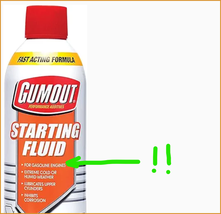

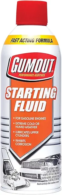

Just a precautionary note:
Do not let your tractor get visited by the "Ether Bunny".
More than one person has made this mistake and it costed them an engine.
12,779
5,569
hmm, even though that gumout IS 'kubota orange' it does say 'for gasoline engines' !!
Agree though, never EVER use ether on ANY Kubota diesel..near instant 'kubota killer'
