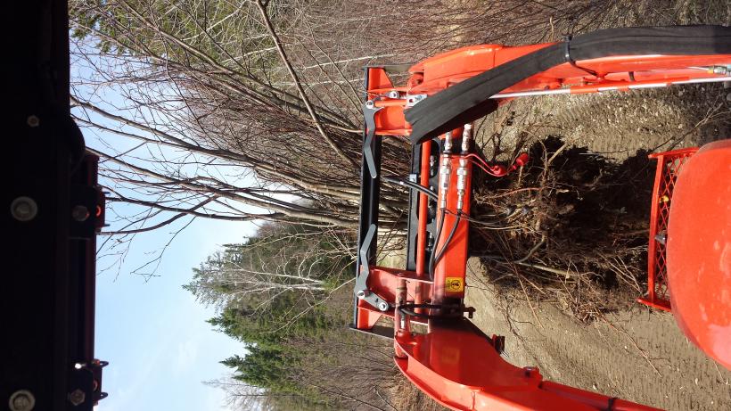

That's fine if you have a big enough machine or you are not worried about the rubble sticking up. When I use my 5 foot Landpride rotary cutter it leaves 2" to 4" tall spikes sticking out of the ground- not to mention a lot of debris laying around. What I'm trying to do with the grapple is to reclaim the gravel road surface that has been overtaken by the small trees. I pull the trees,then rake the road surface with my landscape rake. Then I can drive on that surface with car, truck, ATV etc without worrying about flat tires.

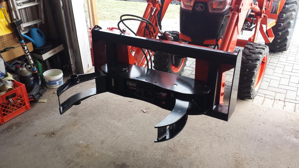

I have the L4701 HST and I bought the Titan Tree Puller.
It has the SSQA.
I have been pulling Honey Locust trees with it and really put it to the test!
The long root system makes for a tough pull!
I would grip the tree and then rock back and forth while lifting.
Anything larger than 4" diameter had to be removed in another manner.
BUT A WORD OF CAUTION!
On the first tree I pulled I tried lifting straight up to no avail so I pushed forward to loosen the tree.
Tried lifting and it came up a little.
So I thought backing up while pulling would loosen it some more.
As I backed up I throttled up and was giving a good tug when the rear end of my tractor lifted in the air and started to tilt.
I immediately went forward to prevent rolling over!
Now I have both rear tires filled with fluid AND a three point ballast box with 1000 pounds hanging on the rear, and it still lifted in the air!
Leverage is a curios act!

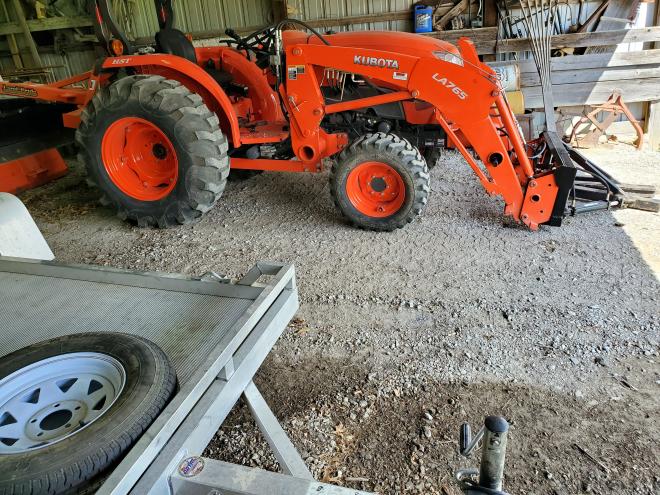

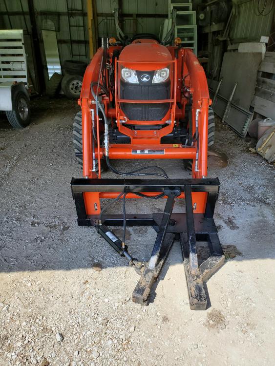

I had one built but haven't had a chance to use it yet ... back tires have 48 gallon each washer fluid ... I figure mine will need modified as I go, I'm thinking the pinchers need some points on the them to do some digging if need be ... Lots of good thoughts and knowledge here ... I'll post some pics of mine when I get some.
