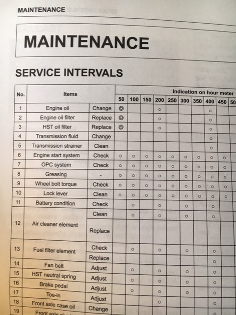

FYI,
I just bought my BX2380 this spring and just completed my 50 hour service....and this is what my owners manual says......sooooooo I guess they changed it.

It would appear so.
My strainer was relatively clean at 50 hrs but I've seen pics on here of heavily occluded strainers featuring blue RTV sealant.
