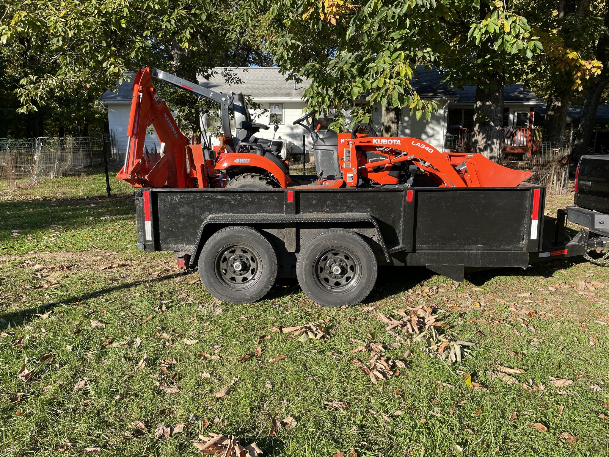

I have a Load Trail Dump Trailer and they have welded D-rings on the floor at each corner inside the walls of the trailer. That should work just fine for tie downs. The walls of the dump trailer is also a fine containment system which is totally lacking on the flat bed trailers many people use for hauling their tractors..
In short, I think a Dump Trailer could be a great way to haul your little tractor and is a good dual-purpose. As long as the overhanging items are within the confines of the tailer (like the FEL/Bucket in the pic) or flagged or lighted (such as the backhoe over the rear) there should be little problem.
As for balance…. if you look at the pic above it’ll be obvious the vast majority of that tractor is ahead of the dual axles and will therefore have plenty of tongue-weight.

I trailer my BX23S with a 12’ dump trailer. In regards to weight distribution, I would have a difficult time getting too much weight BEHIND the axles in the rear of the trailer. There is not much trailer behind the axles for the weight of the machine to get a bite on. I would also imagine most manufactured 10’ dump trailers are more than capable of hauling your machine.
I will post a picture of my setup for reference later
EDIT: Here is my setup. Works well
