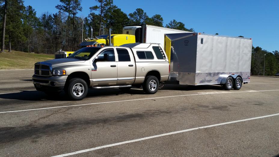

I have a 7 x 16 enclosed cargo trailer with twin 5.2k axles. It has a rear ramp with a 7' opening. I carry my tractor in it.
I run Hartland tires load range E and speed rating of N (87 mph). Have used them 4 years and nary a problem.

Actually neither my Allis Chalmers nor my Kubota have ROPS. The Allis is 1980 version so ROPS didn't even exist then, and my Kubota B3000HSDC has a cab which is built in roll over protection. The highest part of the Allis is the stack and it is 80 inches high.
The highest part of the Kubota is the cab and it is just under 84 inches. The clear opening on my cargo trailer is 86" so I can drive either of the tractors up into the trailer. The ramp is rated for 4.5k and I have multiple 5K rated tie down tabs on the inside trailer floor so I can anchor down the tractor when loaded on the trailer.
