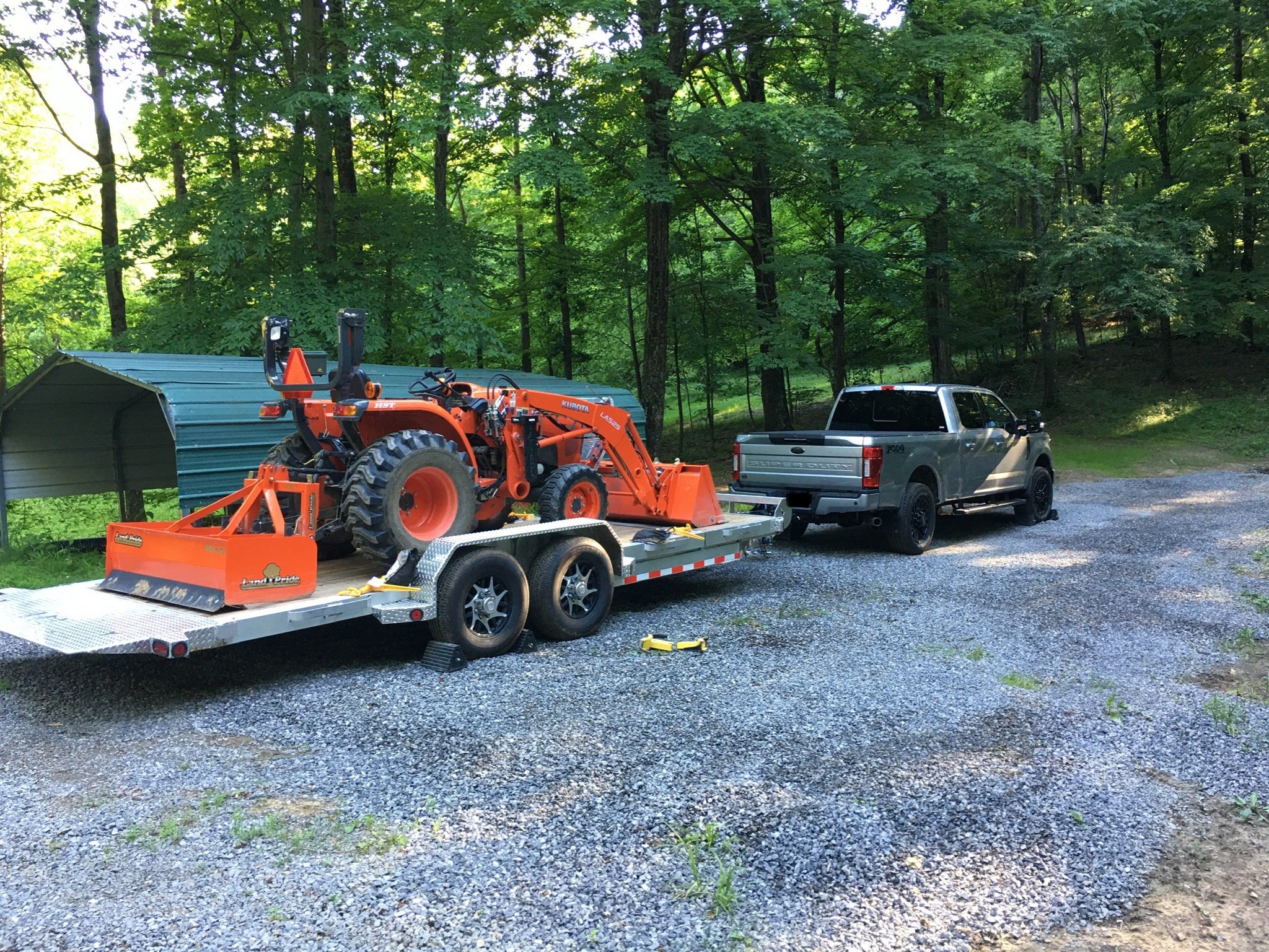

Have the trailer long enough so you can get the proper tongue weight by being able to move the tractor a little forward or rearward as needed. I went with a 20’ for my L3301/FEL and sometimes had a blade on the back, sometimes a rotary cutter. Didn’t have much ability to position it the way I wanted to on the 16’ trailer I had previously. Yes, it fit—but tongue weight wasn’t ideal.

I have an 18' tandem axle trailer with 2-7000lb axles. Trailer empty is about 2000lbs. Loader with a L3301 with loader, bucket & 5' RCR has the mower overhanging about 2' off the rear.
