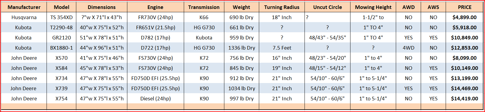

Good morning guys!
I was looking for additional information about a few tractors which might help my buying decision. I'd like to compare the turning radius, uncut circle and verify the cutting height. Any help would be appreciated!
Note: The GR2120 spec sheet says the minimum uncut diameter is 48/43" for the 48" inch deck and 54/35" for the 54" inch deck but that must be wrong. For example the John Deere X584 with all-wheel-steer specs out at 48/15" and 54/12" respectively.
Kubota T2290-48
Turning Radius: ?
Uncut Circle: ?
Mowing Height Range: 1" to 4".
Kubota GR2120
Turning Radius: ?
Uncut Circle: ?
Kubota BX-1880
Turning Radius: 7.5' feet.
Uncut Circle: ?
Mowing Height Range: ?

Things are slow at work right now, so I took advantage of the downtime and played around with Excel. I do have a Kubota dealer just two miles from my house and the John Deere dealer is about twenty minutes from my house.

Do you have the transmissions right on that? I thought the BX would have a Kubota transmission, the GR perhaps not.
May make sense to include the BX2380 if you're including JD tractors in that price range. The JD X series are quite different than the JD 1-series, surprised they're that expensive. They should be more in the GR price range I'd have thought.
Good catch, I corrected that. Only the T2290-48 uses the Hydro Gear G-730.
