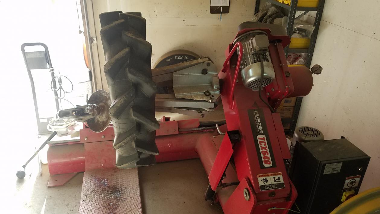

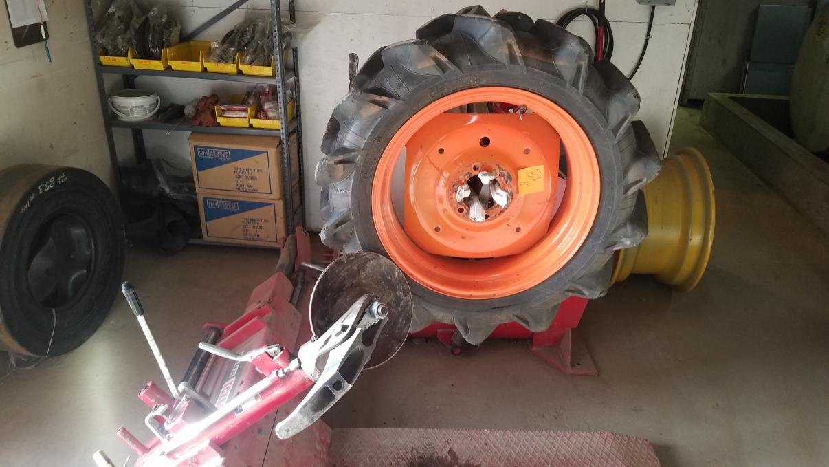

Finally got around to dis-mounting the old tractor tires, the Hunter TCX 640
made short work of it about 10 minutes each. :D Thanks work. :D
Here are some photos of the process.....
here is a video of the machine in use.....
https://www.youtube.com/watch?v=7cZBRuyatbA
Used the standard tire machine to do the fronts.
