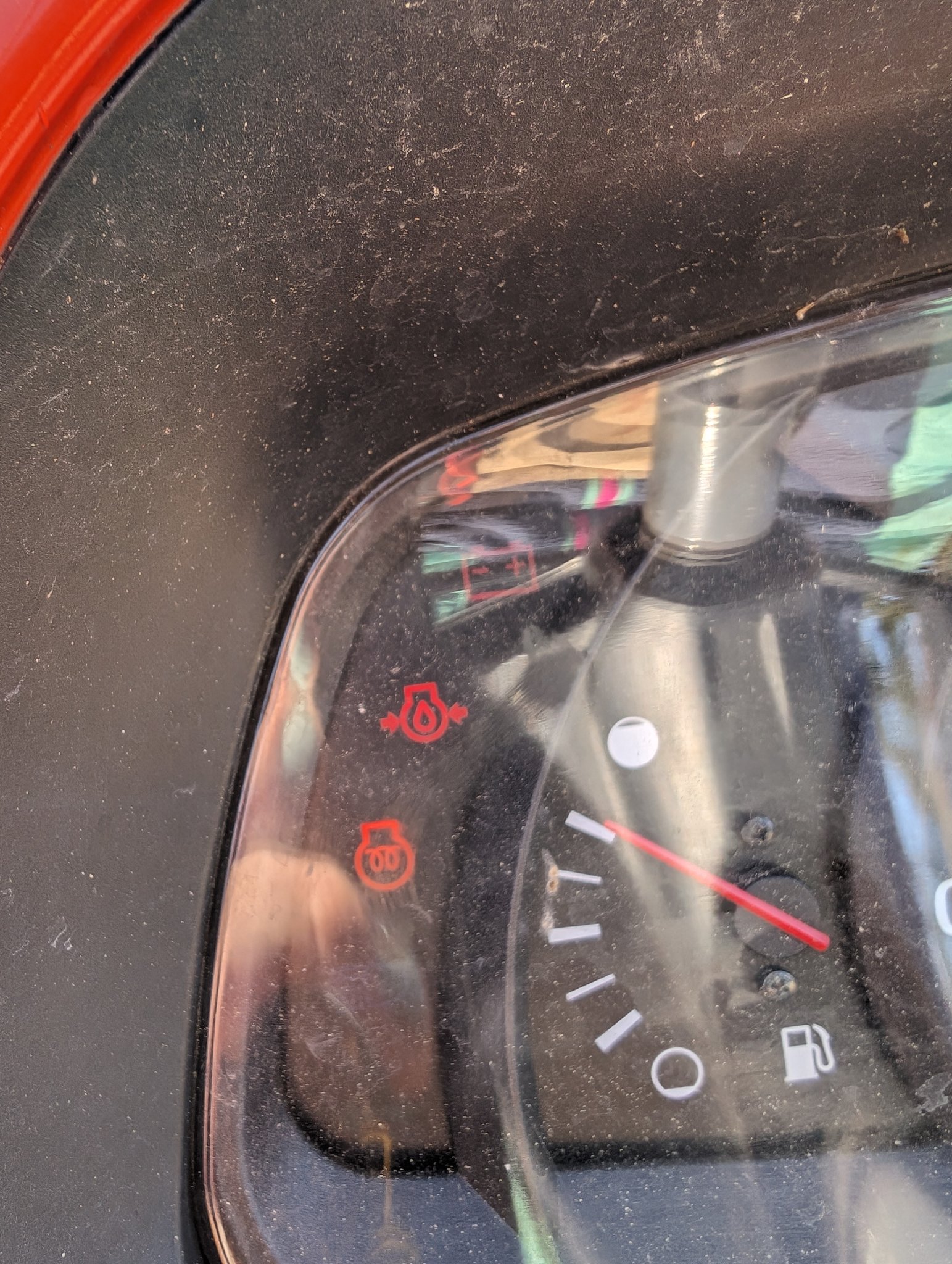

Lights with ignition on

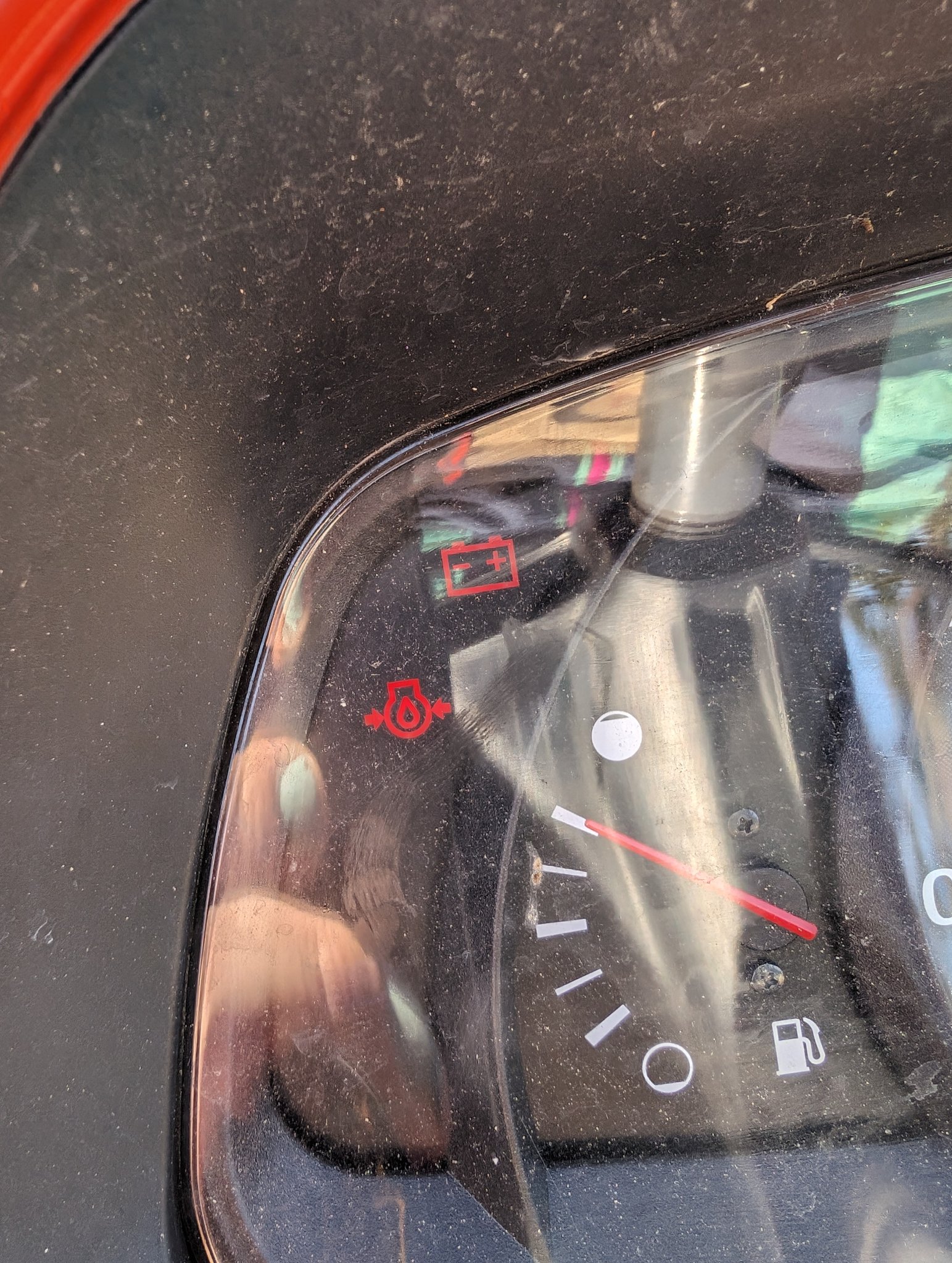

Lights while "starting"
