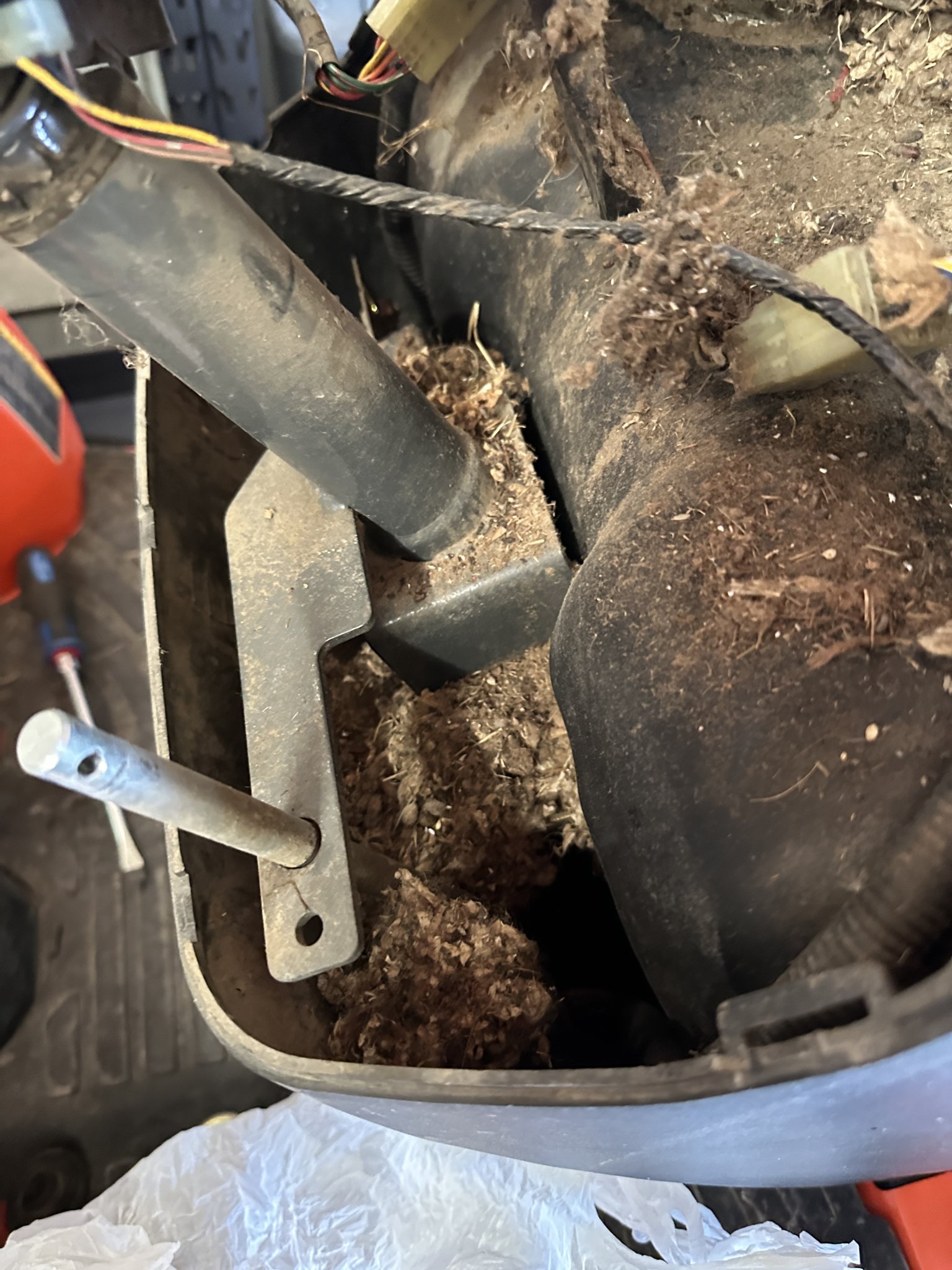

Working on another project and I looked under the B3200 and saw a couple dead infant mice. Crap. Sidetracked again. I was counting on the FEL and the forks to move the project and get the fuel transfer tank in and out of the truck.

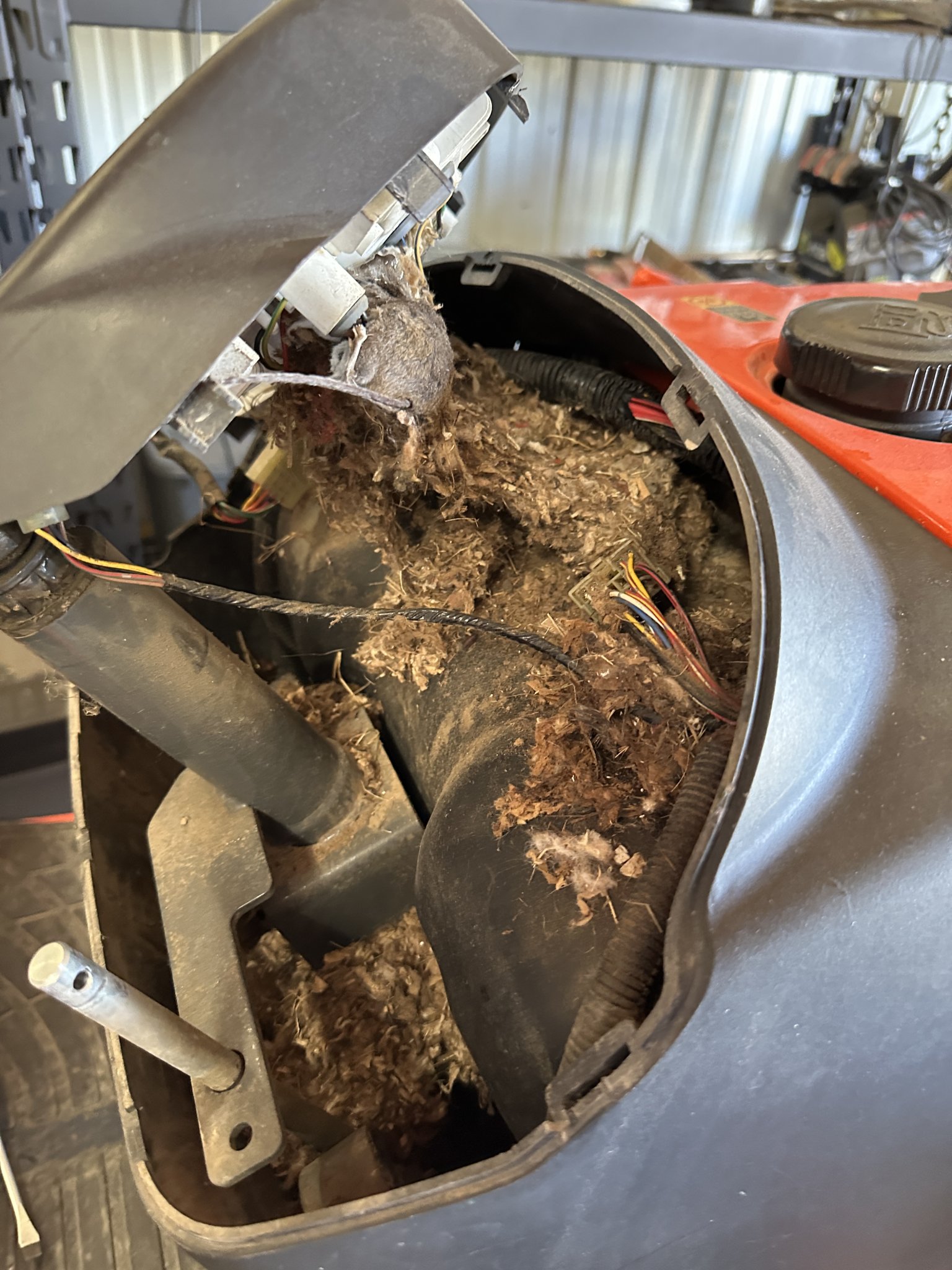

On closer inspection I could see shredded insulation poking out by the parking brake. Quick disassembly showed that the main mouse was there and dead. I guess it got in to the poison I put out in traps around the perimeter. Good!

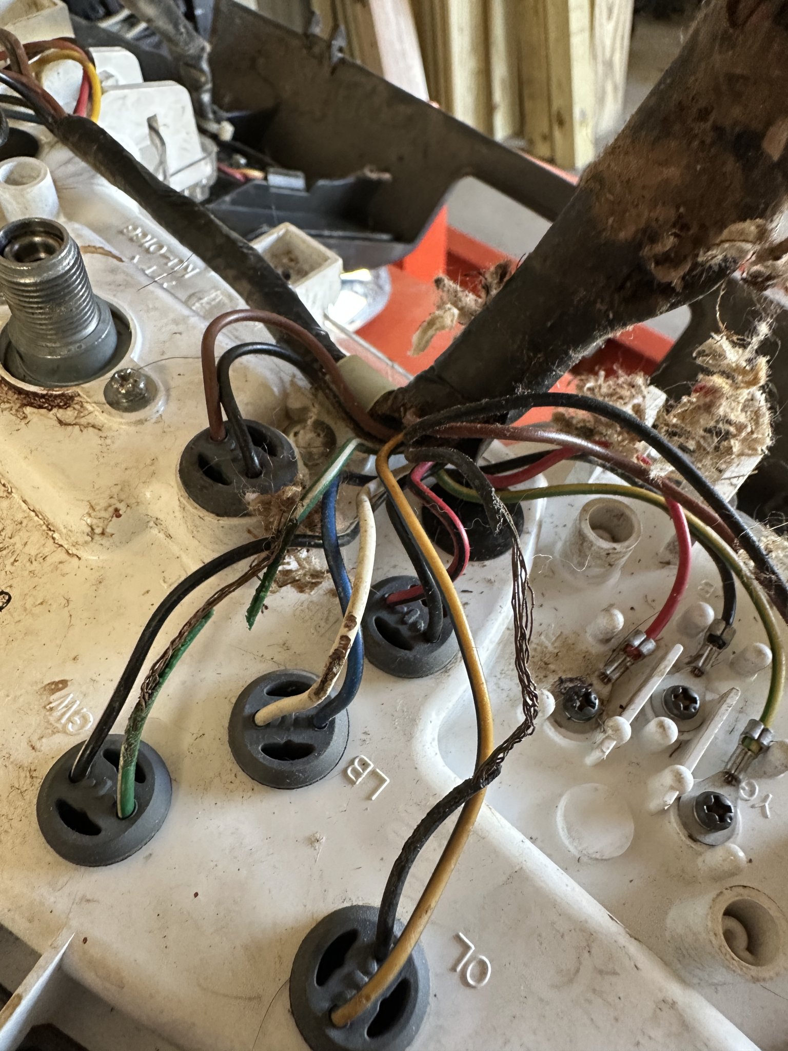

What a freakin mess. Mouse house, turds and seeds everywhere. Worst of all they got the harness in a couple places. Stopping for lunch and the to RuralKing for wire to fix the mess. I took off all the shielding where they chewd and found bare wires down in the covered area. Great. Just got a bunch of this no crimp solder connectors in so I will try them out. Thank goodness I didn’t try and start it and cause a fire. Pictures for your enjoyment. Any tips as to what I can use to keep the out of the dash? IMG_5939.jpeg IMG_5938.jpeg IMG_5936.jpeg IMG_5935.jpeg IMG_5934.jpeg IMG_5933.jpeg

Well cables are cut out and repaired. Time to go see if it all works. Most of the damage was to dash bulbs and not gauges

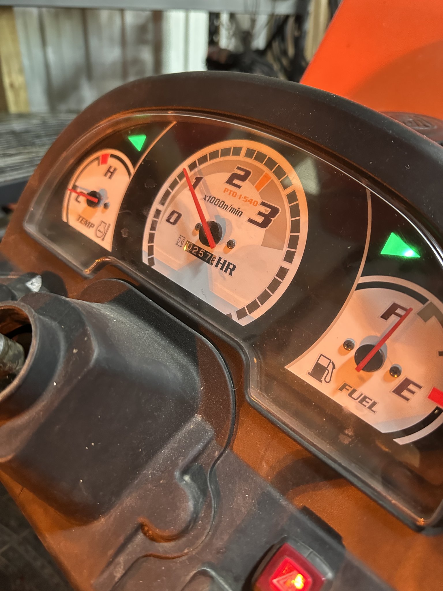

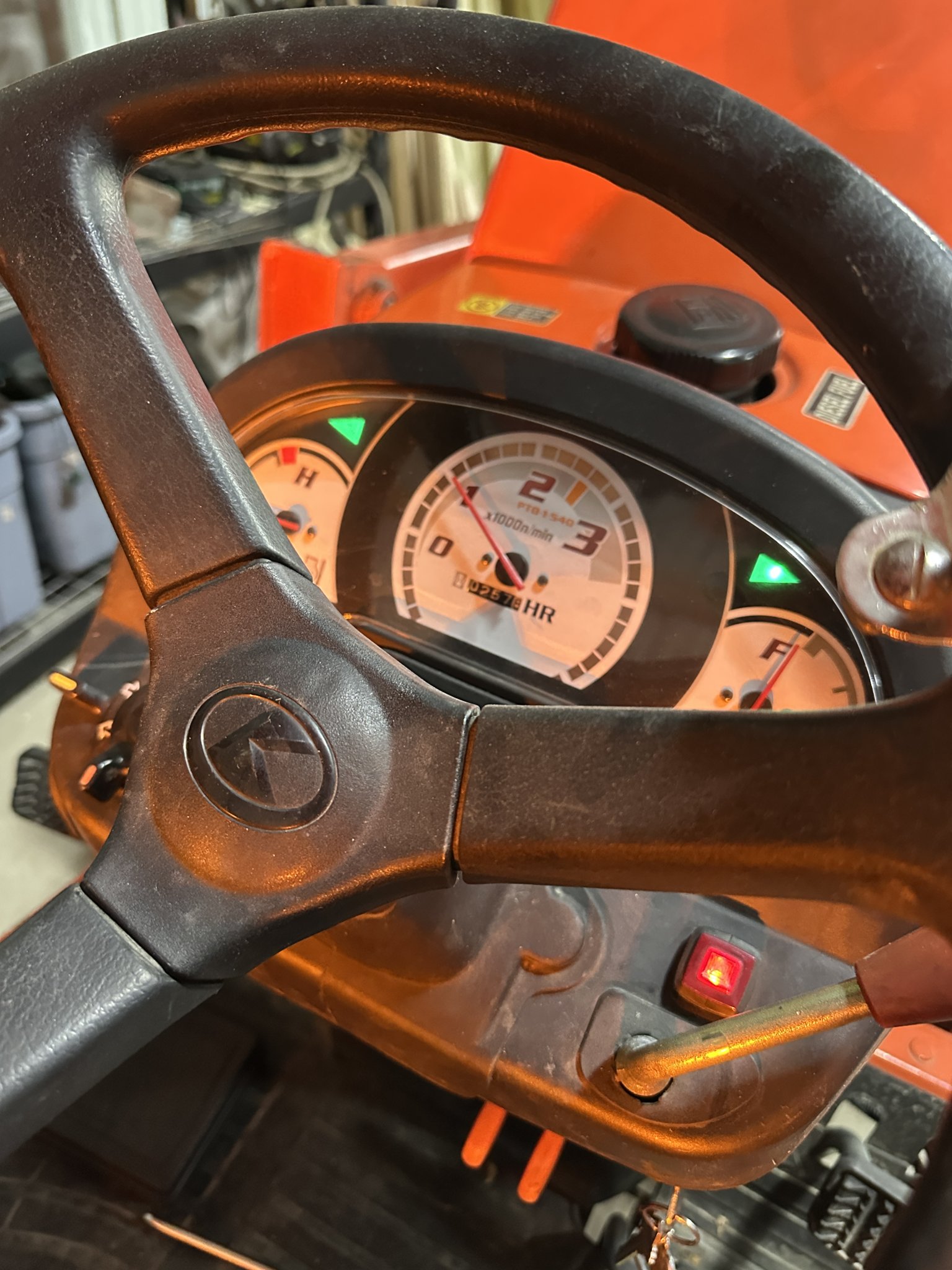

Success. The B3200 is up and running. Worst part is getting the tach cable back in and then the gauge cluster bezel attached to the base.
