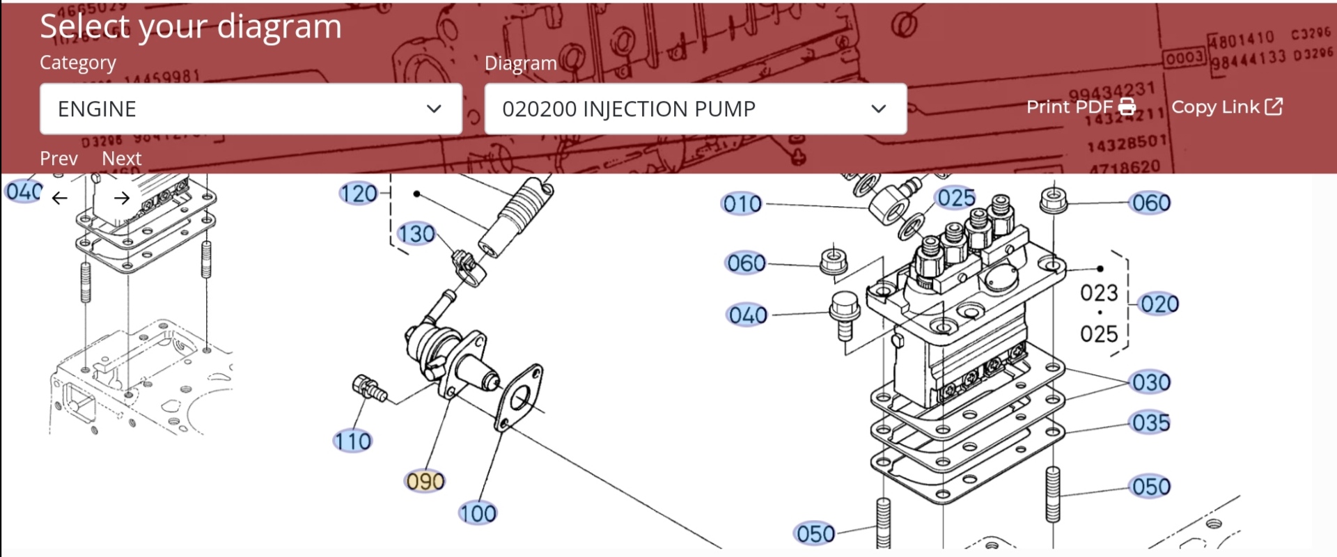

What else do I need to look for? The fuel system diagrams on Messick's show no fuel pump on this model. What am I missing?
Hi, the fuel pump is only shown in the fuel parts diagrams. With part number it is included in the injection pump diagram (number 090). Looks like a mechanical fuel pump.
Filter bowl filling in a minute sounds slow to me. You may have dirt or Diesel pest in your tank. Blowing back the pipes with pressurised air will only be a short term remedy, the dirt is still in the tank and will block it again. Disconnect the tank hose from.the filter, there should be a good flow of fuel coming. If this is the case go forward in the fuel system until you are at the injection pump.

the fuel pump (lift pump) and injection pump are shown under the "Engine" assembly drawings vs. the "Fuel System" drawings. The lift pump is shown in the fuel drawings but is not called out.
So here is the plan:
- Tank to filter flow - remove fuel line and check for obstructions. Likely very low since the fuel filter assy filled so fast. Note: I wrote this before seeing or reading post above #6.
- Fuel filter to lift pump - check for obstructions.
- Lift pump to injection pump - check line for obstructions or failed lift pump (~$30).
If the lift pump is flowing well - then it's *probably* the injection pump. :eek::eek::eek::eek::eek::eek::eek::eek::eek:
