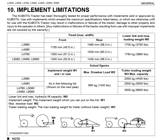

I know this chart isn't your tractor, but thought it may give you a little guidance:
The max according to this page in the manual is 6,600lbs which is the 47, 50, 54, and 60HP Grand L tractors.
