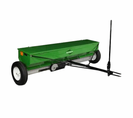

So I am in the process of researching my options for a spreader/seeder that I can use on my property. This will be fairly light duty use for the most part. I see a need for annual ongoing grass seeding and overseeding along with basic grass starter fertilizer. I also will likely want to use it seasonally for deer food plots. And I will need to stay on top of lime application to stay not too far behind in the soil pH dept. This is on variably rugged and hilly land with some thick grasses that makes hand pushing not only strenuous but also means I have had more seeder/spreader tipovers than I would like.
I have started looking into tow behind seeder/spreaders - both broadcast and drop - that would be easily pulled by either my B2620 or my RTV400. However, that research has led me more often than not into territory occupied by the dedicated 3pt mounted spreaders. These 3pt spreaders are not too much more cost than a good tow behind broadcast/drop spreader and seem to be a good option.
My question is.... how does a big 3pt spreader deal with fine materials like grass seed, fertilizer granules, and lime? Will it do an adequate job on a variety of sized and shaped material? Anything to watch out for as I watch the CL and FBMP options popping up around me? Are some more "controllable" in terms of seed density and distance thrown?

I use a 500# Cosmo 3pt broadcast spreader like the one in your picture for those exact tasks. Works fine for grass seed and granilar fertilizers/herbicides. It puts material down fast. I have had it for a couple decades.
A drop spreader is more precise but a lot slower and harder to maneuver.
Whatever you buy poly is your friend.
