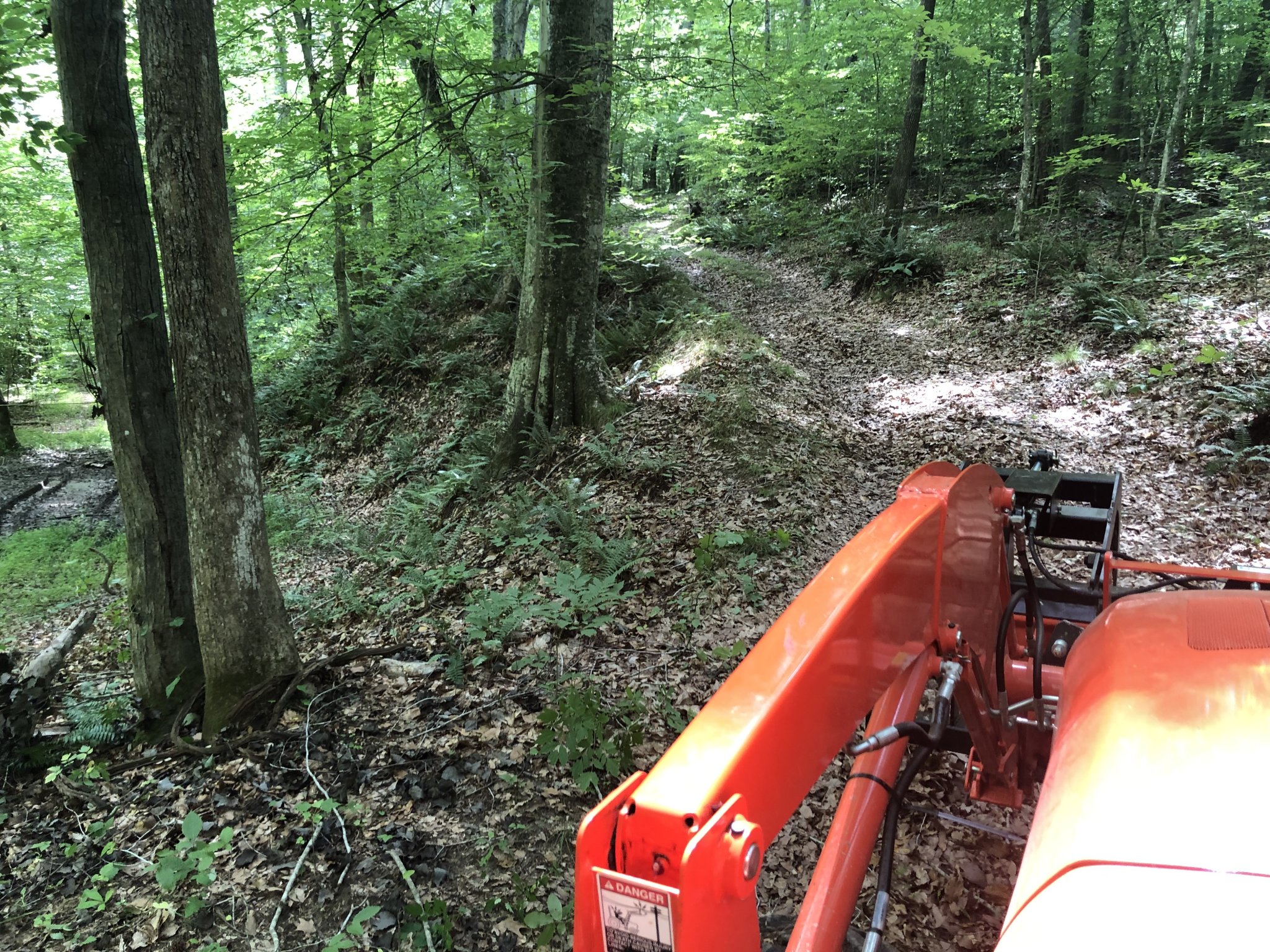

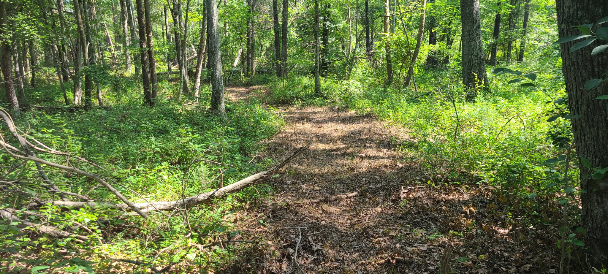

I have about 1 mile of trails to build. A bit is done / partially done. See pics.
Before i get too far into this job, help me decide if I have the right tractor tools - assuming i continue to use the L3400 i have.
Skeleton bucket and backhoe has been doing the work so far.
I might pick away at it as a project or high a big machine to come do the heavy lifting.
Any suggestions for
1) building the trails
2) Maintaining the trails
3) If i could only get one implement which one would be most helpful long term.
I was thinking land plane once the land is cleared of roots/rocks. Does that only work for an established trail or would it help in building / leveling.

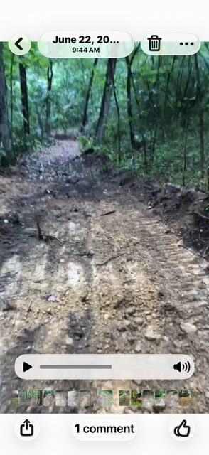

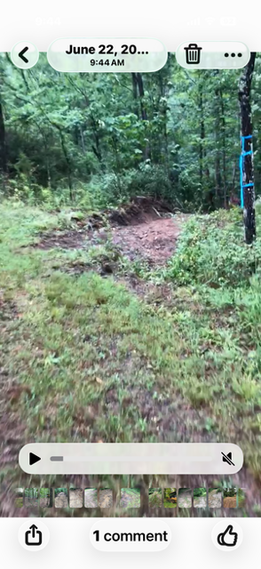

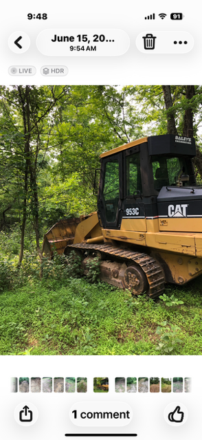

We had our hunting camp select cut two years ago. The logging company hired a fellow who used a Cat 953 C track loader to build a mile and a half trail through woods on a sloped hill that did not have a trail.
Took that fellow a day and a half. Moved a lot of dirt, shale and trees.
If I need trails through the woods in the future, I will hire the heavy equipment to rough in the trail and then maintain with tractor, box blade and loader.

What planning to do with the property and trails? To me that’s a big factor in tools/implements/suggestions.
I find a grapple to be pretty helpful, but if I could only have one implement I would not trade my forks for a grapple. However for woods work grapples are awesome IMO.
Depending on your timeframe and plans for your machine, I would politely encourage consider having someone with either excavator or dozer or compact loader / mulching head come in and get the trails done and save abuse to your machine. Sure not cheap, neither is a new machine.
Also depending on your uses I would politely question if those trails are really wide enough. I think you will be amazed at how quickly brush and overhead branches will encroach on the single track you have there.
if planning to trim branches regularly overhead, a work platform on a set of forks is a game changer for overheard cutting. (With that width of trail my forecast would be overhead branches will need regular attention. )
what you did so far looks pretty nice and even groomed in the pics. Keep the rubber side down.
