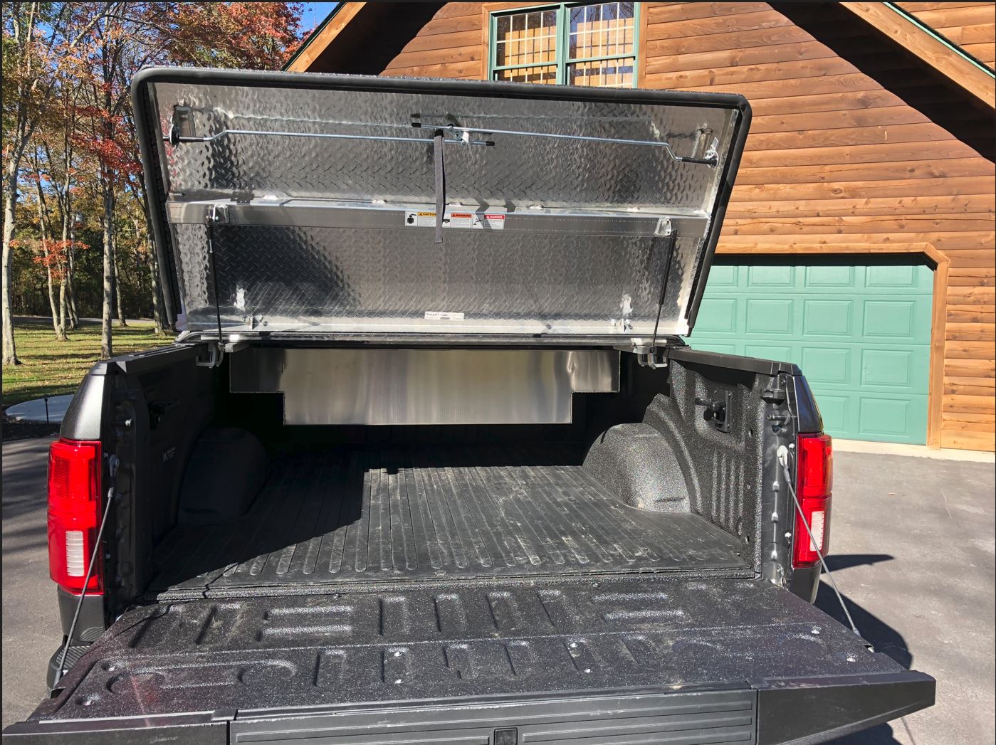

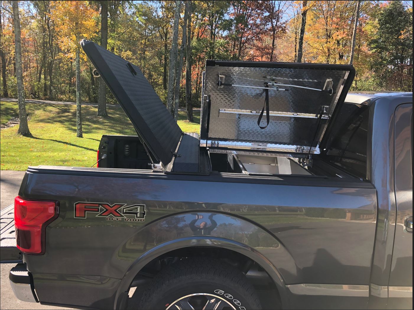

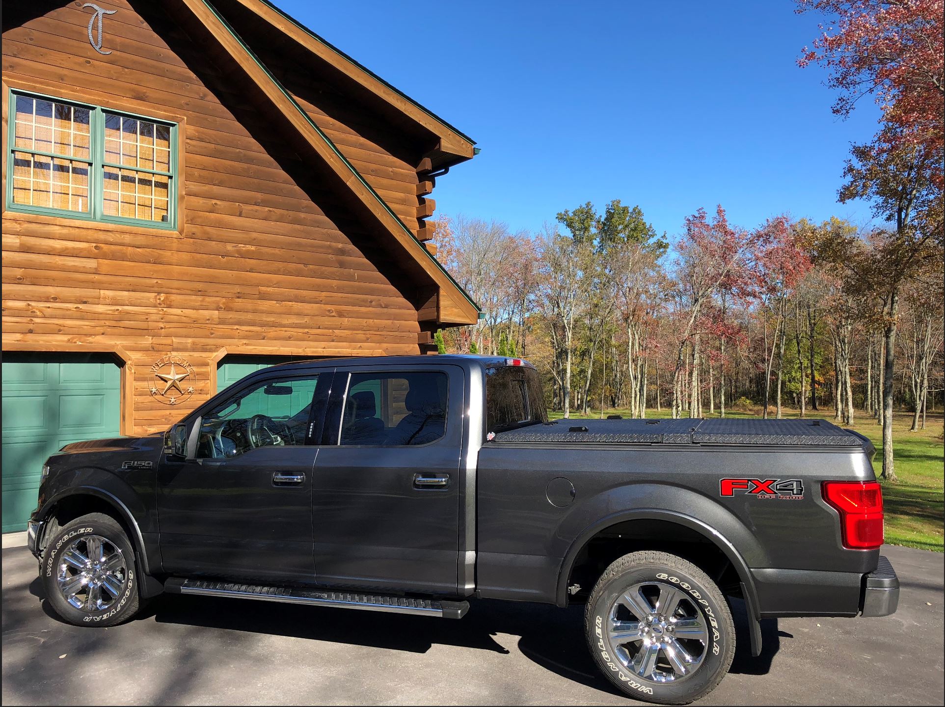

I got a diamondback for my truck about 6 years ago. They are pretty much indestructable.
The heavy duty models will carry 2 ATV's on top of them. Mine isn't like that but you certainly don't have to worry about snow load.
I got it here,
https://diamondbackcovers.com
direct from the manufacturer. Check out their "outlet" link. That's where I got mine for a large discount. They do have different styles depending on how you need to use the bed. No leaks at all.
