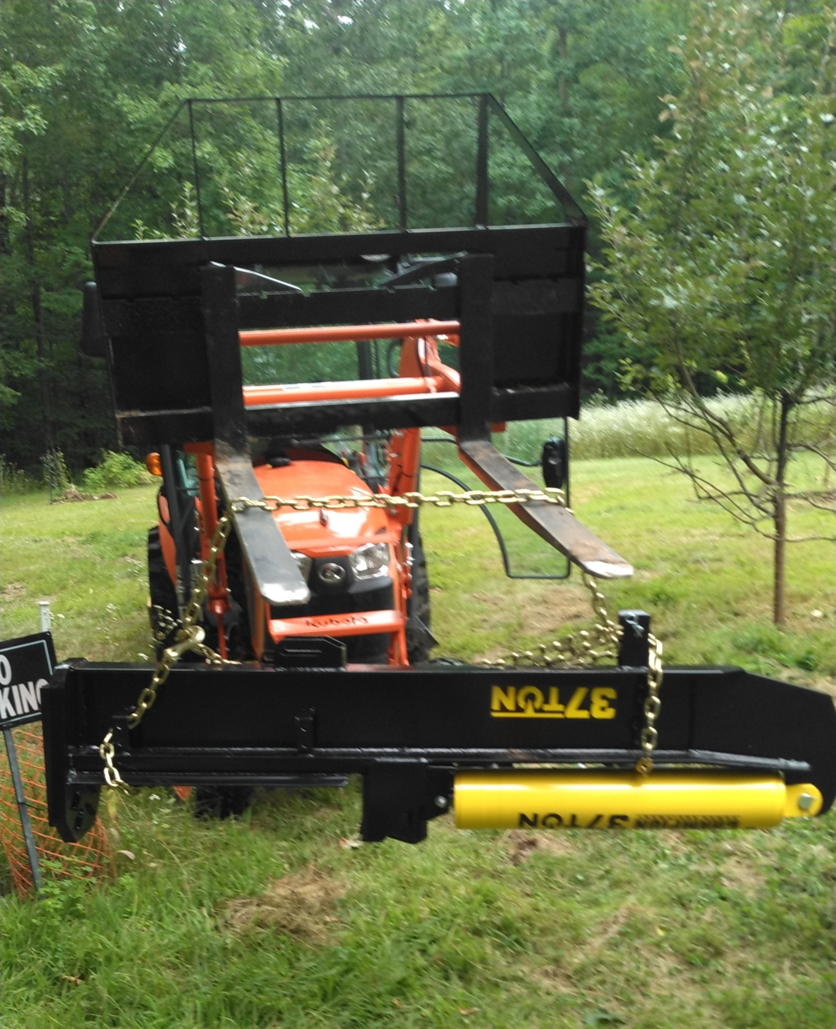

I have the Land Pride forks... 48 inchers.
They'll lift 37 Tons! 🤔😆
I always paint the fork tips white or orange... it helps to see it. But it wears off fast.
Lifting my37 ton log splitter out of my truck a couple years ago.

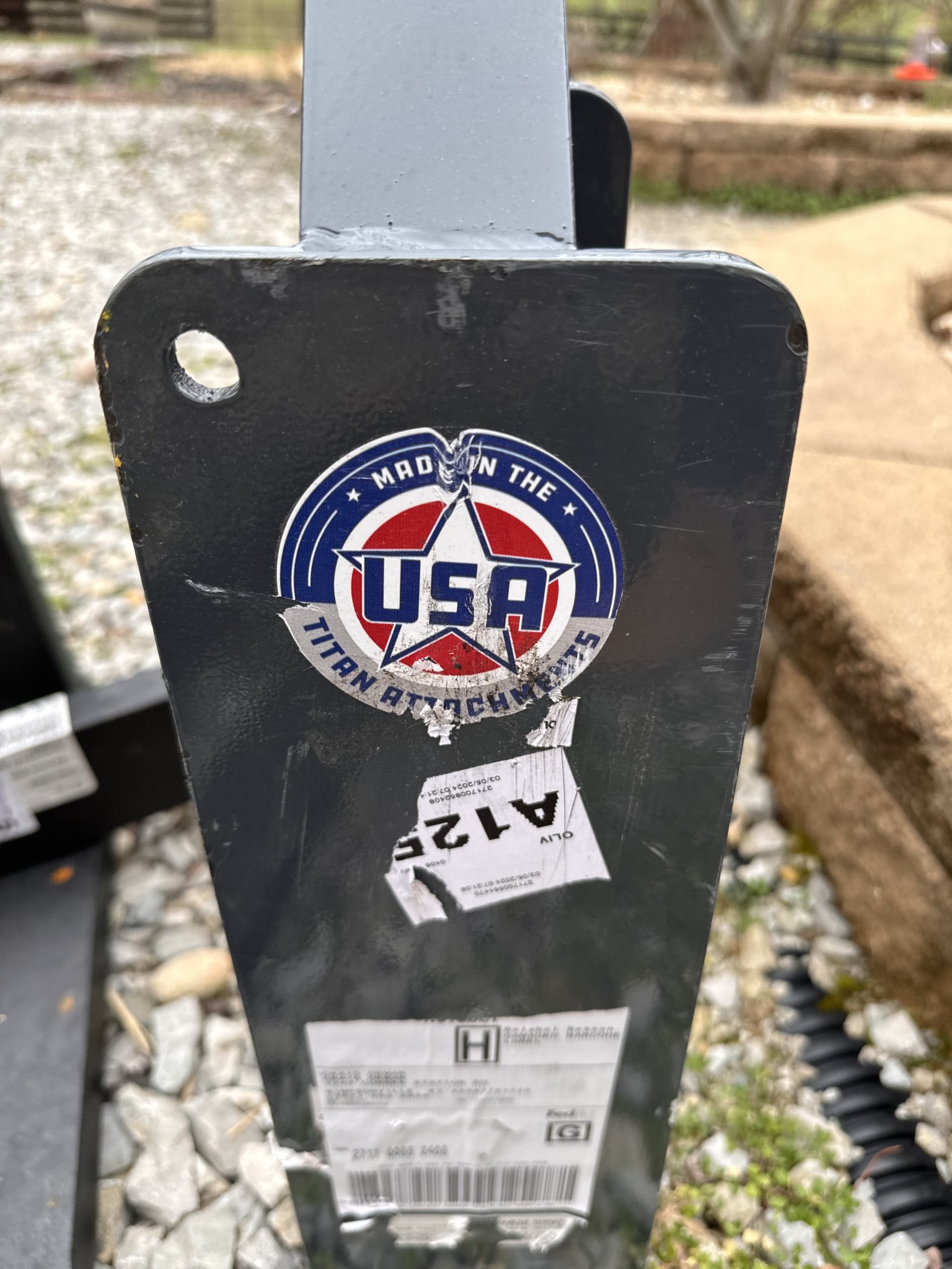

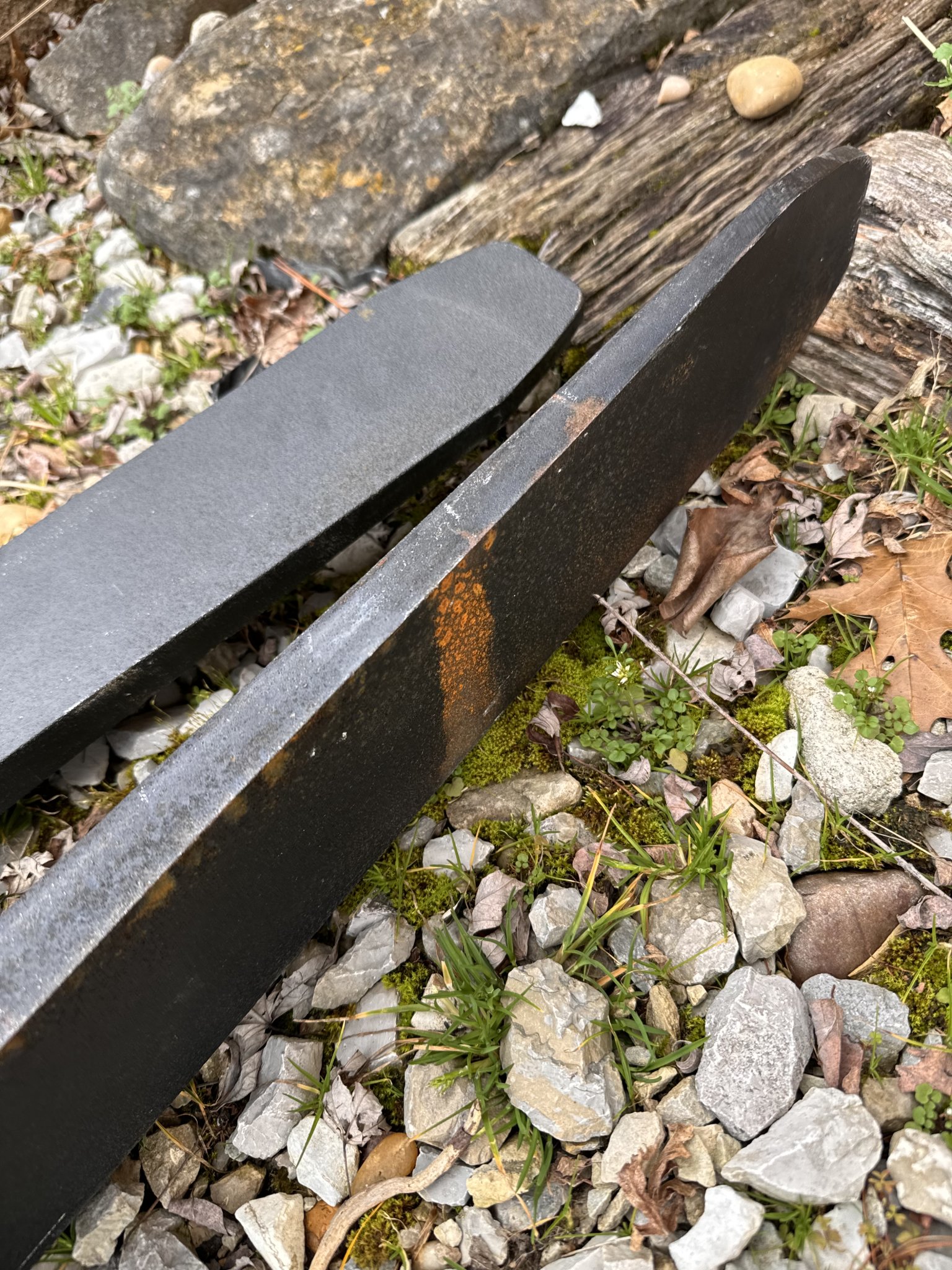

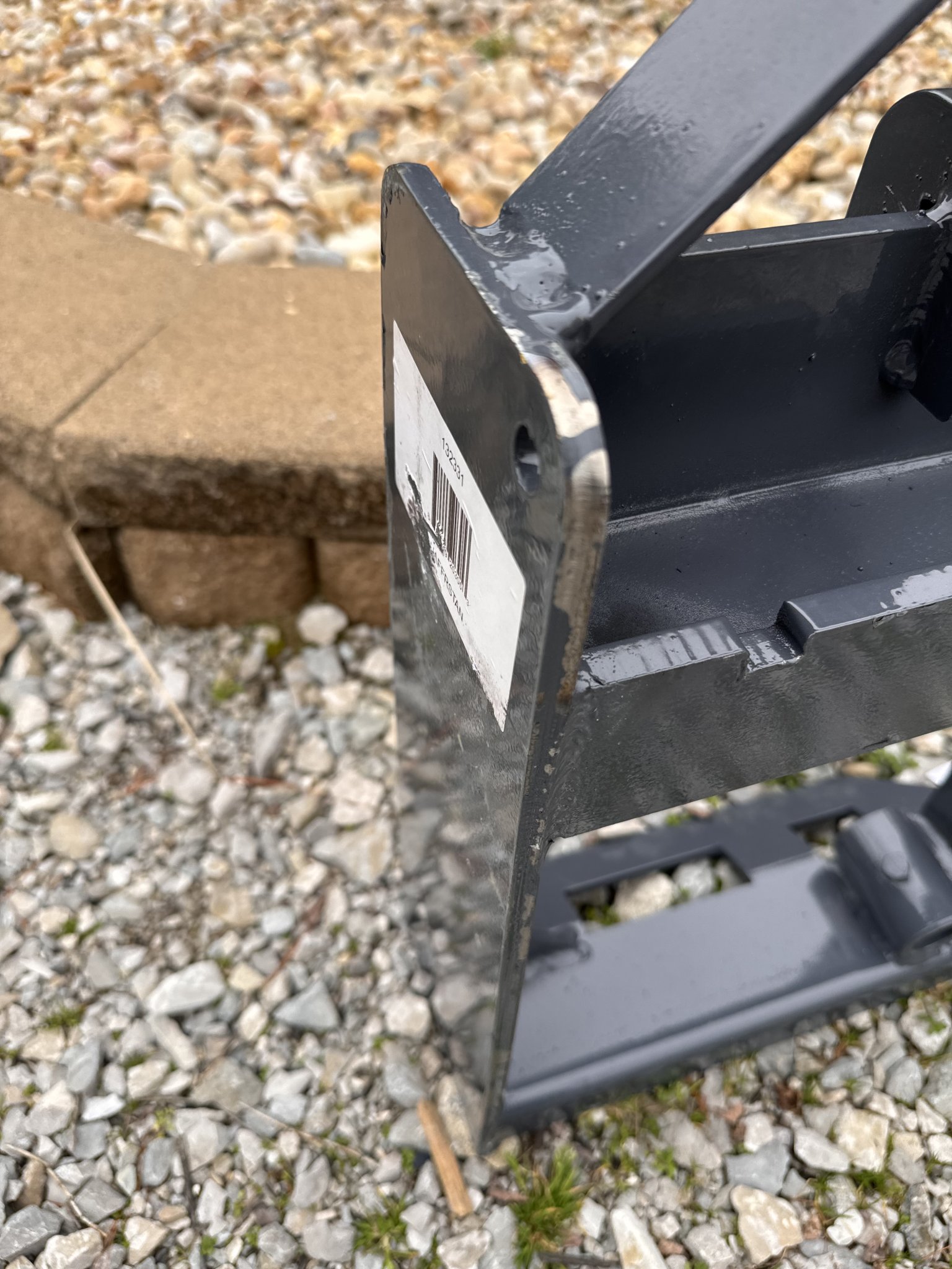

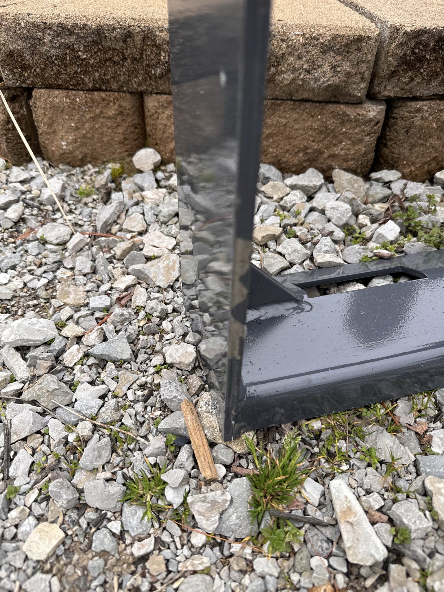

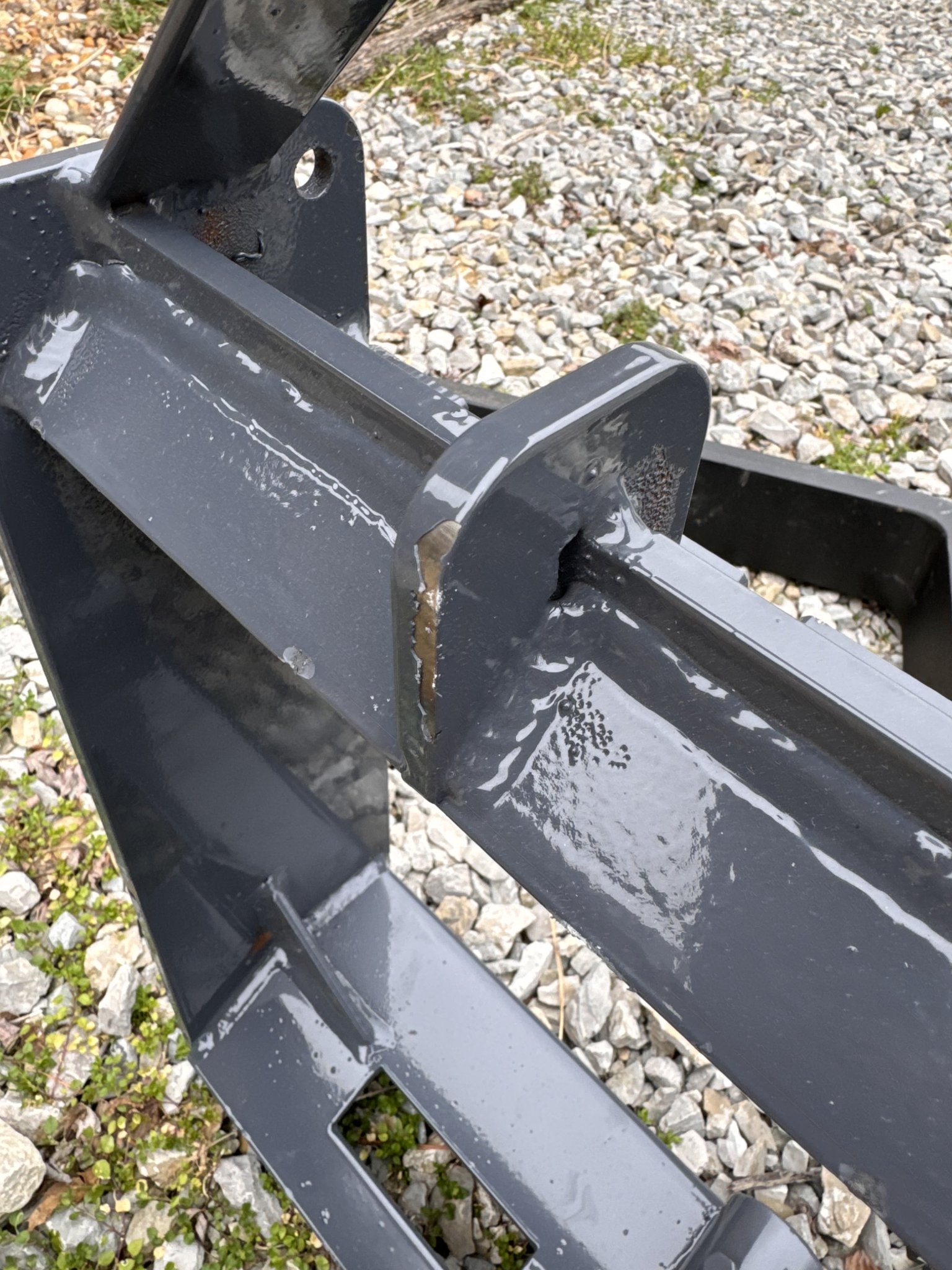

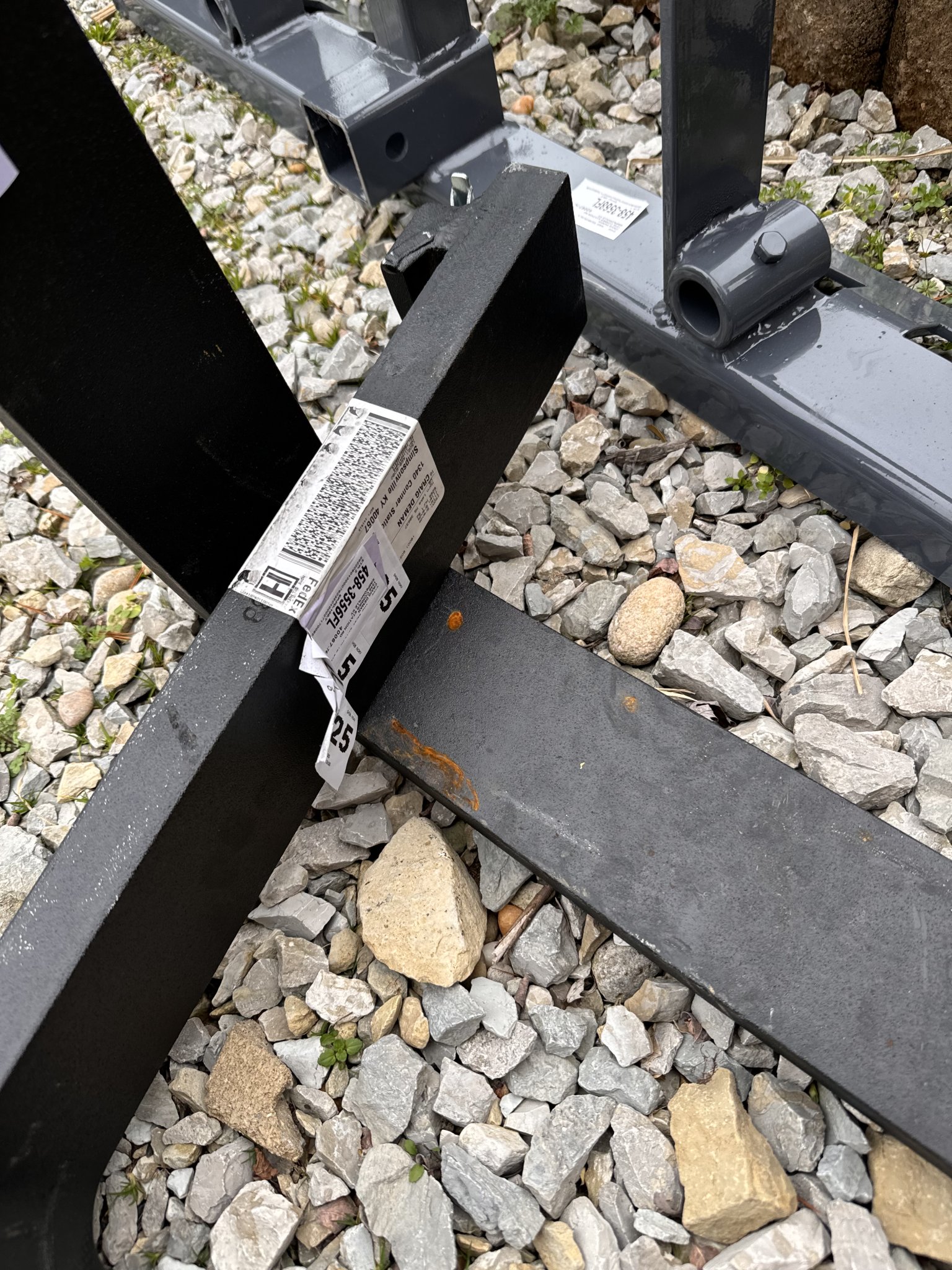

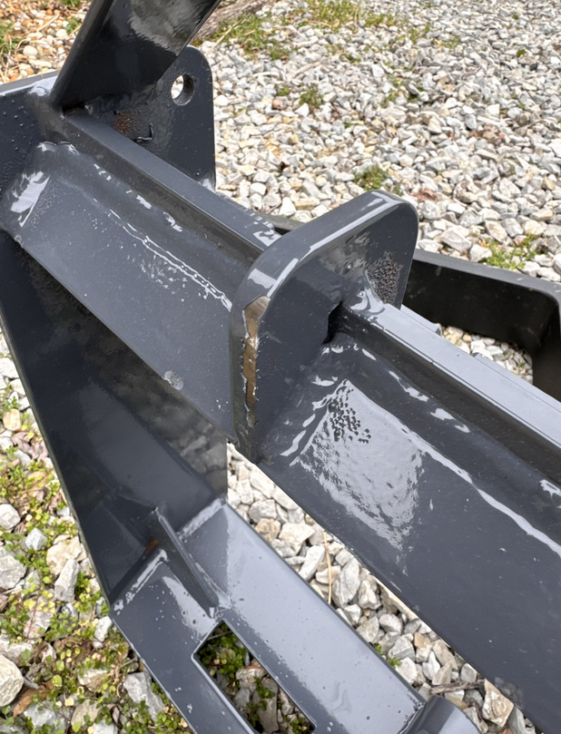

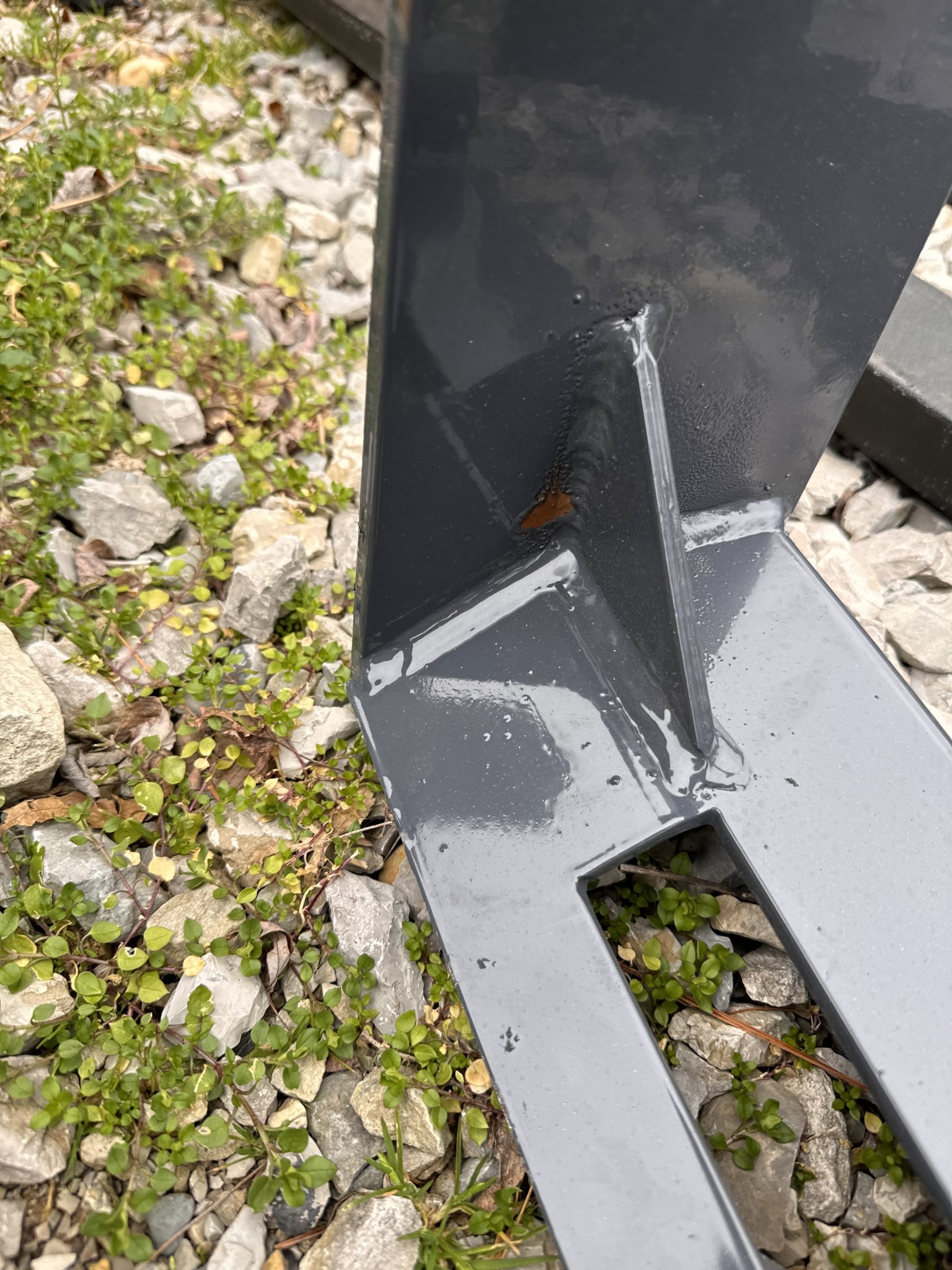

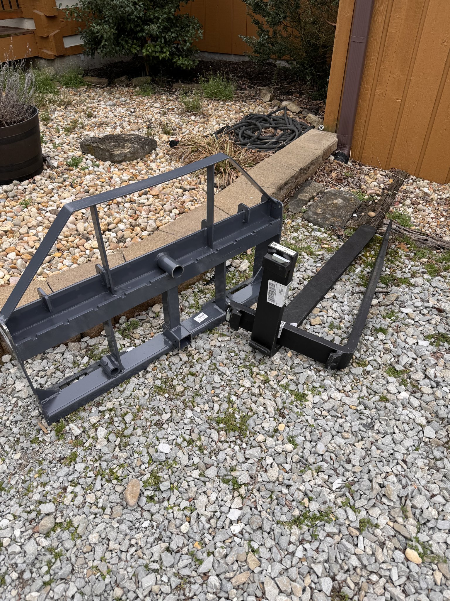

I ordered the USA made pallet forks from titan attachements. Was just delivered there was not a stitch of wrapping on it. They never even attempted to wrap it. It came all scratched up. I know that these over time will bet beat up but when I buy something new I expect the company to have some pride in their product to deliver it in good shape.

I ordered the USA made pallet forks from titan attachements. Was just delivered there was not a stitch of wrapping on it. They never even attempted to wrap it. It came all scratched up. I know that these over time will bet beat up but when I buy something new I expect the company to have some pride in their product to deliver it in good shape. View attachment 123820 View attachment 123821 View attachment 123822 View attachment 123823 View attachment 123824 View attachment 123820 View attachment 123821 View attachment 123822 View attachment 123823 View attachment 123824 View attachment 123820 View attachment 123820 View attachment 123821 View attachment 123822 View attachment 123823 View attachment 123824 View attachment 123820 View attachment 123825 View attachment 123826 View attachment 123827
Cheap powder coat....or paint?
That's frustrating for sure. Do you notice all of the weld spatter and wire around the welds that has been painted or powder coated over? That's not cool and certainly not what you expect from a quality implement manufacturer. Once you start using pallet forks and need to adjust the spacing you'll start to realize why some forks are twice the price.
The pallet forks and grapple I ordered from two different vendors were not wrapped and I did not expect them to be. That looks a little beaten but not because they were not wrapped.
