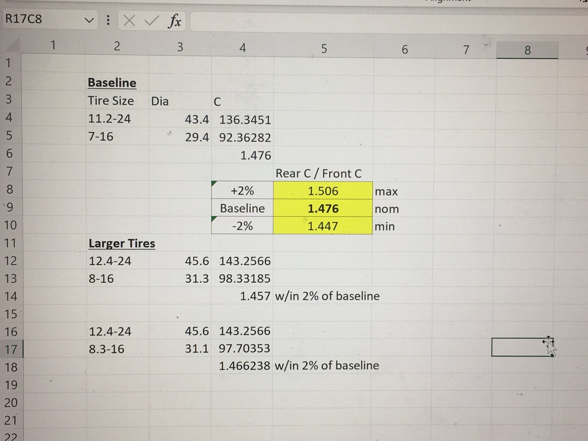

I appreciate the response/thoughts. Do you know where to find the circumference for the tire sizes to do the calculation of front to rear rolling ratio?

Here’s some circumference ratio calcs comparing the baseline to both 8-16 and 8.3-16 using manufacturer quoted diameters. Looks like either are within 2% if I’m calculating correctly (think I saw that 2% was the approximate bounds for the RC in one of the tire size thread discussions).

You've got to be careful, C is not RC, there is a difference.
And 2 tires with the same C can be different RC values.
