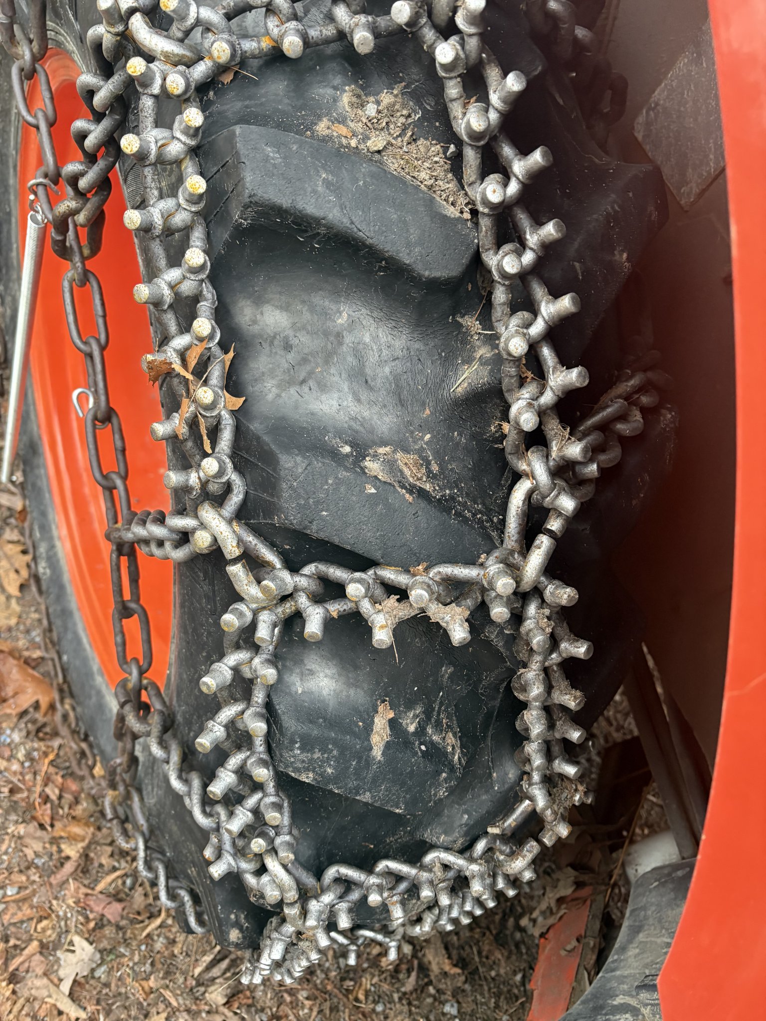

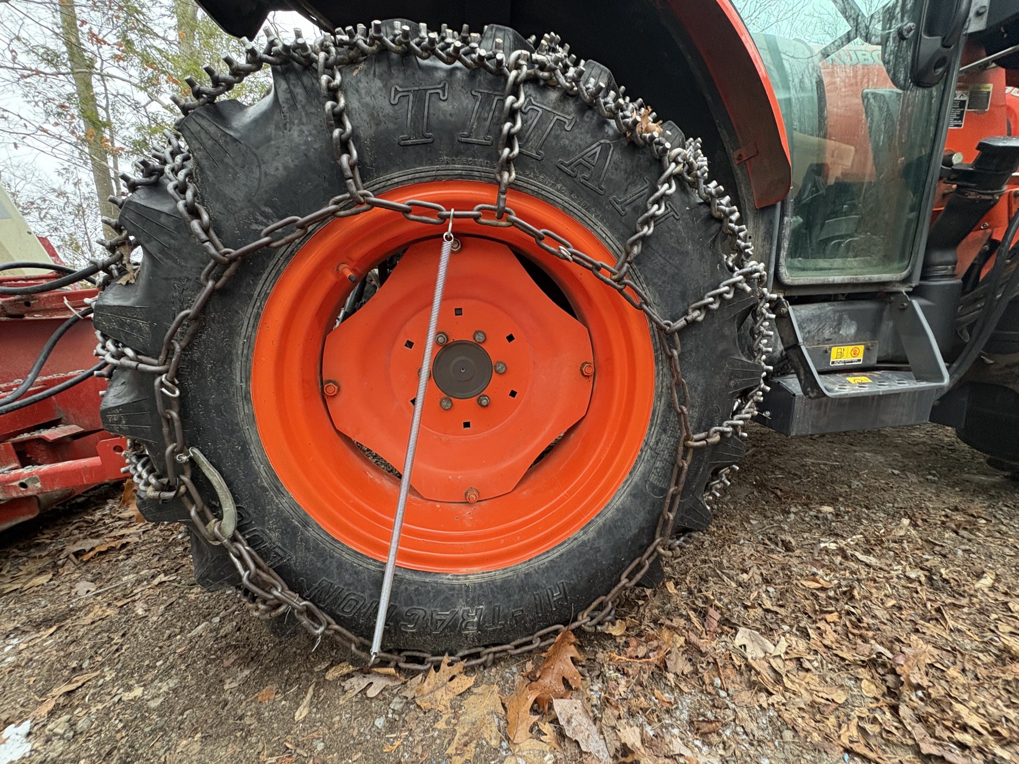

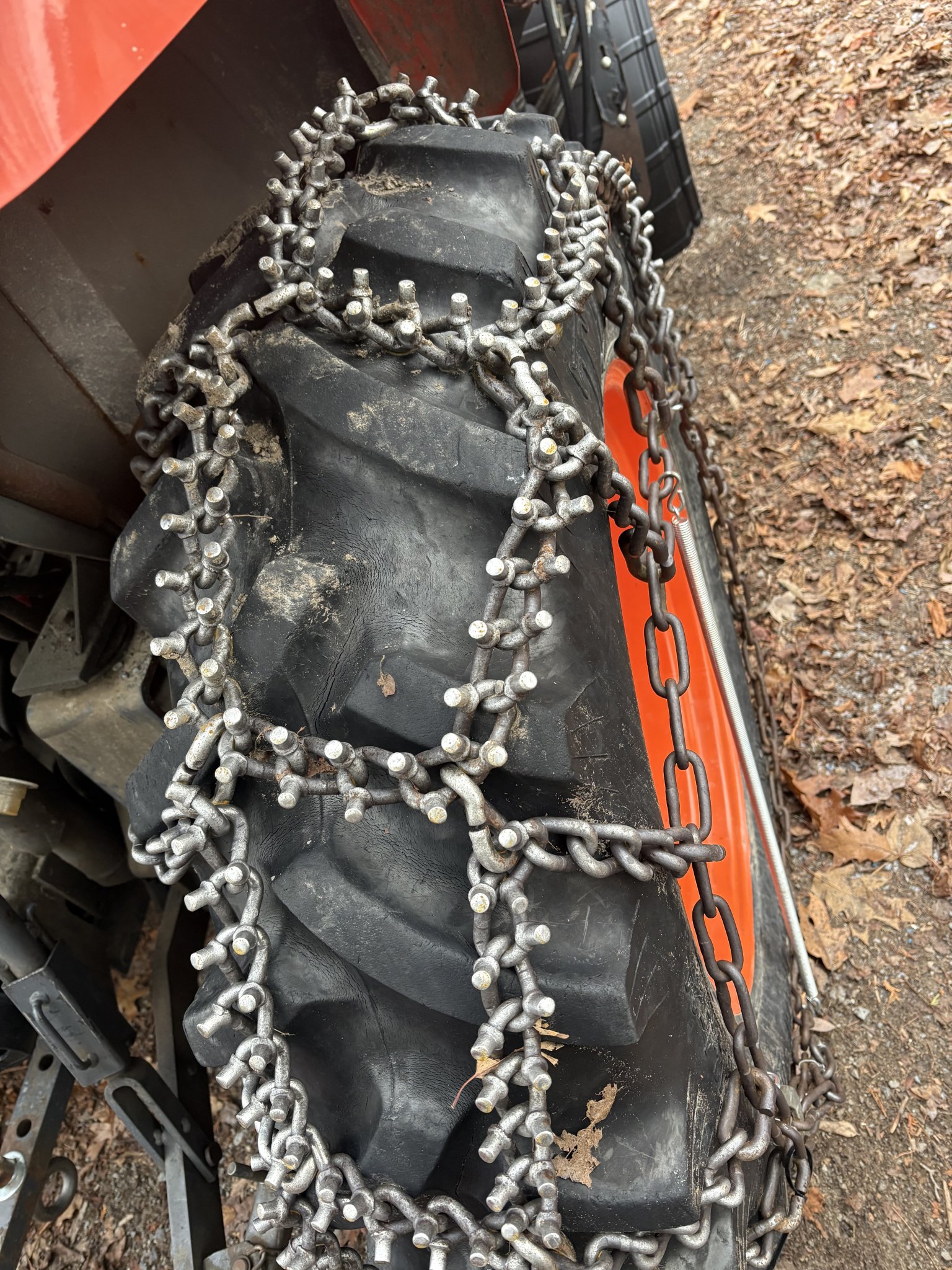

I'm having a terrible time trying to get my Trygg chains to stay straight on my Kubota 3560. These chains came from a different tractor, and I cut out some links to make them fit on the new wheels. See pics. The two rows of studded links should run straight round the tire, but after use, maybe especially hard loads like hitting a rock while plowing, I come home and find one side has slipped down, and the opposite side has climbed up. 180 deg around the tire, the same thing happens, but in the opposite direction.
Suggestions?
Get them tighter somehow?
More powerful springs or ratchet straps across the wheel?
Is the geometry wrong some how? ie certain parts of the chain system are too long or too short?
Is this Ag tire just too big and narrow?
I wonder about creating a link to a lug nuts somehow

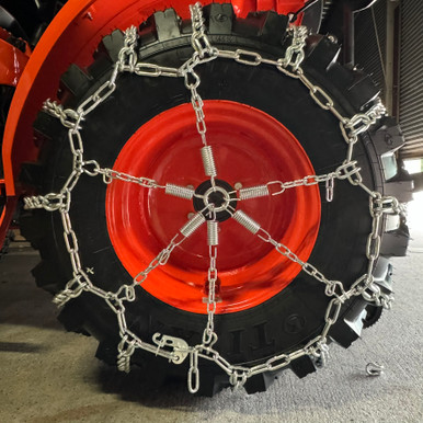

Just as a start, no expert on chains here, but with my R4 tires, and two link ladder chains I never ran in to what you are experiencing. BUT I had good chain tensioners. What you are using looks like a screen door spring...my guess is you need real tensioners.
My tensioners came from tirechains.com at the time. I don't know if they are still around or if they are, if the name is the same. Check out what actual tensioners look like.
Mine were a metal ring in the center, with something like six pretty heavy springs radiating out to the chains. I needed to use a pipe for leverage, through the center ring in order to get the last springs attached. Quite strong.

They are the wrong style and fit of chains for R1 tires.
And the tensioner is so not up to the task.
Have not used the chains for several years ...now I have rear wheel spacers so no reason not to put the chains back on.
Looks like they are still around:
Thanks Henro! I've seen those tension springs used by some dude in a YT video and was wondering... Plowing snow, we end up driving through some icy snow banks that scrape over whatever's on the side of the wheel so the tensioner has to be tough - which I think those ones are.

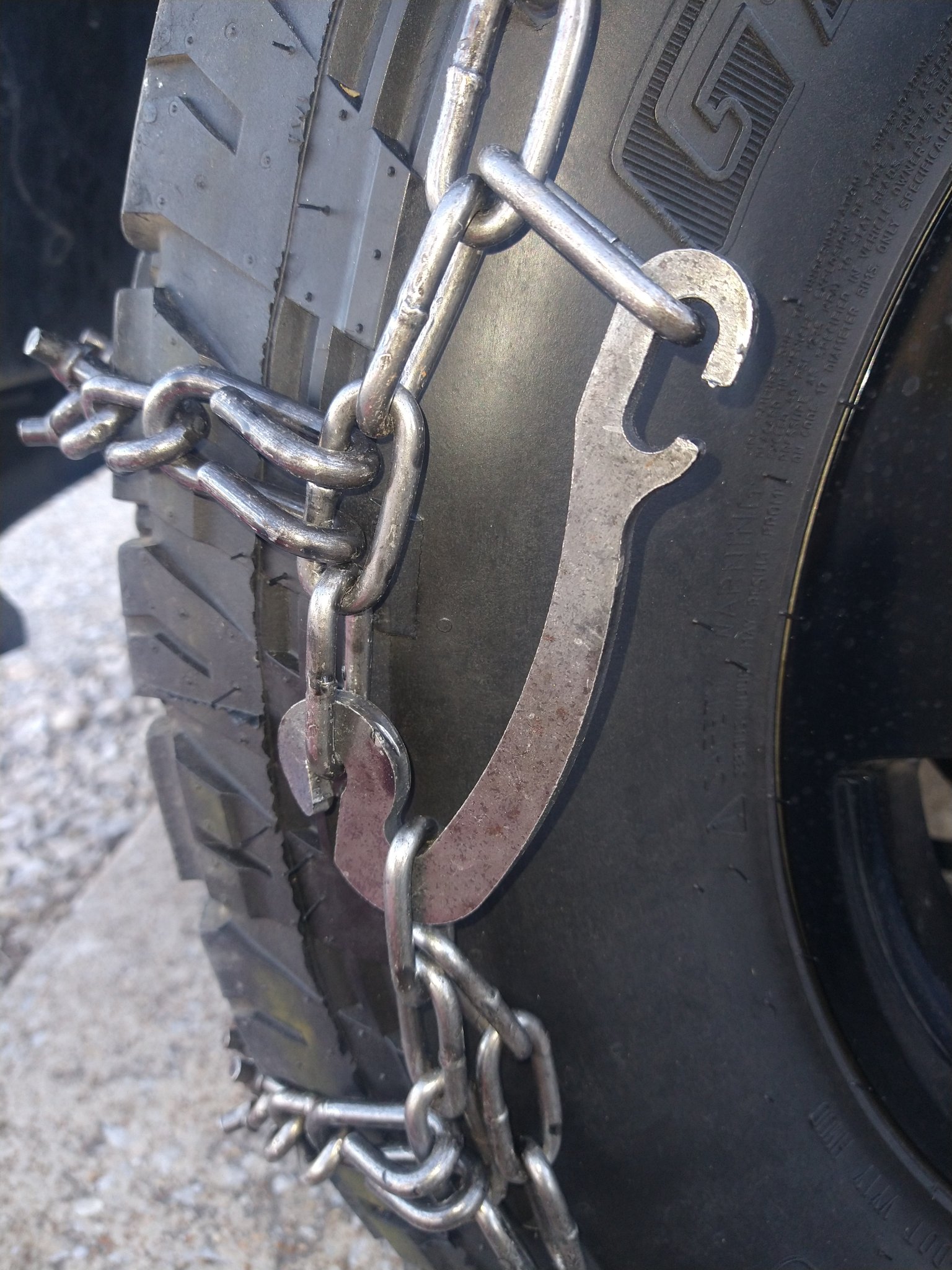

If you want TIGHT, then you need "cams" on the side rails ... These are very expensive by themselves ... https://www.tirechainsrus.com/product/side-chain-tensioning-cams/
I have them on my pickup chains (also on all my semi-truck chains) ... No real need for the tension spider, other than to hold the one end from flopping around ... You can see part of the "L" wrench at the very bottom of the picture used to tighten the cams ...
Theses have the tightening lock on each side, so the inside also gets tightened ...
The cam
Tightened ...
I prefer the "T" style wrench, over the "L" ...

Just MHO, it would seem the cross links are not long enough to fit all the way across the tire profile. Measure the with of the tire tread across the tire, that will give you the cross link length, and just looking at the pics I would say they are too short by half, so like maybe 4 or more cross links. Im betting they came off a really narrow AG tire.

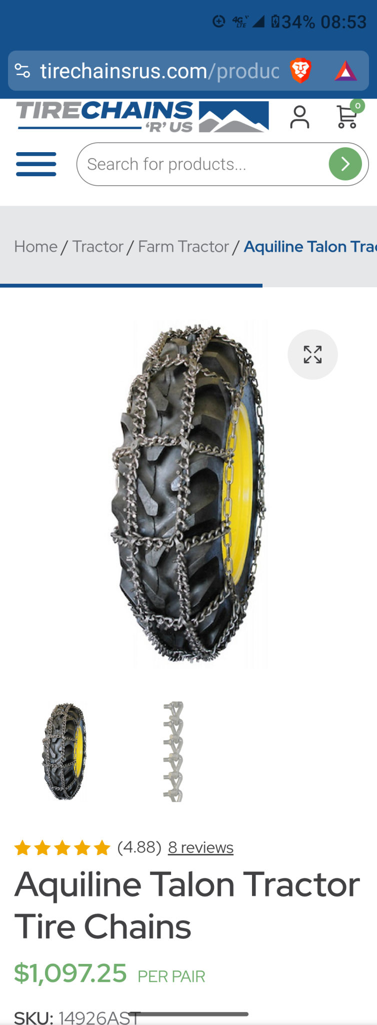

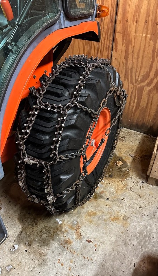

To me they look too long or wide ... This is my brother's ...
This is a stock picture on R1's...
I think if the OP centered them up, then tightened then down, that there is enough side rail to hold them on if evenly tightened both the inside and outside ...
Thanks for the comment. I will try improving the tensioner. But if that doesn't work, what are the right chains for an R1 tire? I am plowing snow on about a mile of gravel road with some steep hills.
It is cheaper to buy a different tire and keep these chains, or to buy new chains?
Thanks for the pictures! Especially the R1 tire. I will count links and see if I'm in the same proportions. Maybe the two rows of studded links need to be closer together.

I suppose they may work ok being off centre like that. But I'm afraid they're unstable and could get worse and worse. I have steep hills and it's not unusual to spin a wheel even with those aggressive chains.

I don't think too wide is the problem. More likely too loose. Inner and outer should both have about the same number of left over links, but the inner should definitely be tight. After a bit of use, tighten the outer again. A decent tensioner or heavy bungie cords will help, but starting with them tight will help the most

Wrong chains, and most likely the "mods" done made the condition worse. The "look how pretty my chains are" pictures are of much different tire designs. The chains aren't able to adjust themselves into the big valleys between tread lugs.

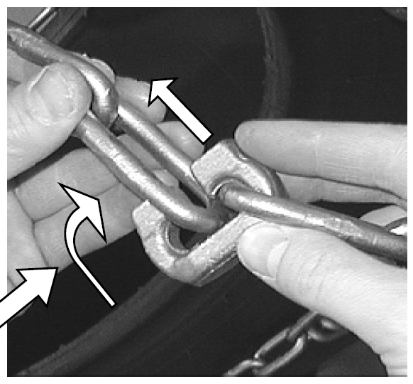

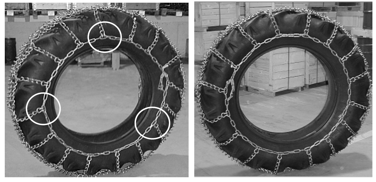

I believe this is a combination of too wide for the tire and side chain length as well as spacing of the side straps to the side chain. The side straps should be placed so that they align radially to the center of the rim. If you just shorten the side chains they side straps will align tangentially and not towards the center. The image, from Trygg, below shows this.
You could disconnect the side straps from the side chain, shorten them and rearrange how they are spaced on the side chain but that is a fair amount of work to try to make them work and it does not help that the center sections of the chains are still almost as wide as the tire tread.
The upper grades of Trygg chains allow for adjustability with links like this
