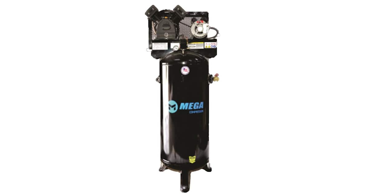

Spend the extra money and get a cast iron compressor with disk valves.
That's in my price range ($1,200) but I think a 5 Hp is bit more than I need, how about the 3 Hp?
Also why does the single stage have three cylinders?I'm pretty ignorant.... Think about what I am stepping up from.

What kind of power and amperage do you have to feed it easily?
How many CFM do you want?
What high pressure limit do you want?
2 main compressor types, yes there are many more:
Single stage, can be any number of cylinders.
Dual stage, again can be a combination of multiple cylinders.
The higher number of cylinders the quicker the recovery or CFM output.
The larger the cylinder the nosier they are, so many smaller cylinders is better than one big one.
Single stage usually means more CFM quicker.
Dual stage usually means less CFM more PSI.
Bigger is almost always better!
I have a 60 gallon 3 cylinder 5HP, High continuous CFM that runs air sanders, spray equipment and high CFM uses.

I was thinking ... 240V/20 amp circuit (12/3)but I can up that if needed.
I've been using a 135 psi but would like more for the rattle gun. I cheat it with a few drops of oil but, more power would be nice. so a 175 PSI is a big bump up
I'd like move volume than my old Craftsman, most new ones seem to have about double the CFM, there are times when I use the blow gun (cleaning house air filters) and the Craftsman runs continuously. This, in August means a lot of water and heat, and after a hour or so, I'm blowing fog. So I'm hoping the air to air radiator and more compressor will drop the wet air (and auto drain it).
I hear you on bigger. But it is just me.
So the three cylinders is still single stage, just more and smaller 'puffs'? Reasonably quiet? I wonder when they do not publish dBa readings. Pocka-poka and not BRAAAAAAAA

I personally think a 3 cylinder single stage 5HP would do you really well.
But yes you could drop to a 3.5hp 2 cylinder model.
Why Mega instead of Ingersol Rand?
I agree, cast iron oil is better than oil
When I last looked, quiet compressors generally run lower RPM and have less CFM output, but for intermittent tasks like a rattle gun or blowing off parts the quiet is very welcome. At work we run two dual-screw compressors and they're "quite quiet," although quite spendy and not as efficient as piston. At our second location we need incredible volume and 175+PSI so run a two-stage three-piston compressor and it's actually pretty quiet (though huge). In both cases we run an industrial air dryer which really extends tool life.
At home I run an American cast-iron 100% duty rate compressor with a buffer tank and small industrial air dryer, so I have air volume for high-volume low pressure painting. If you want it quiet build a sound-proof enclosure with plenty of cooling.
34,333
9,574
I was pointing at a type more than a brand.
There are quite a few good companies that make that style of compressor.
