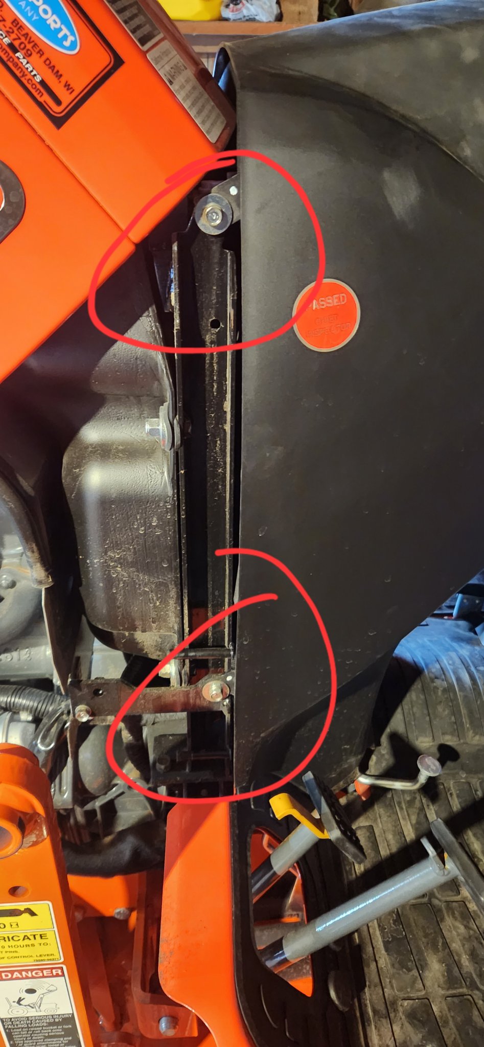

This afternoon I went out to the shop and took a look at the issue.
My sales guy said:

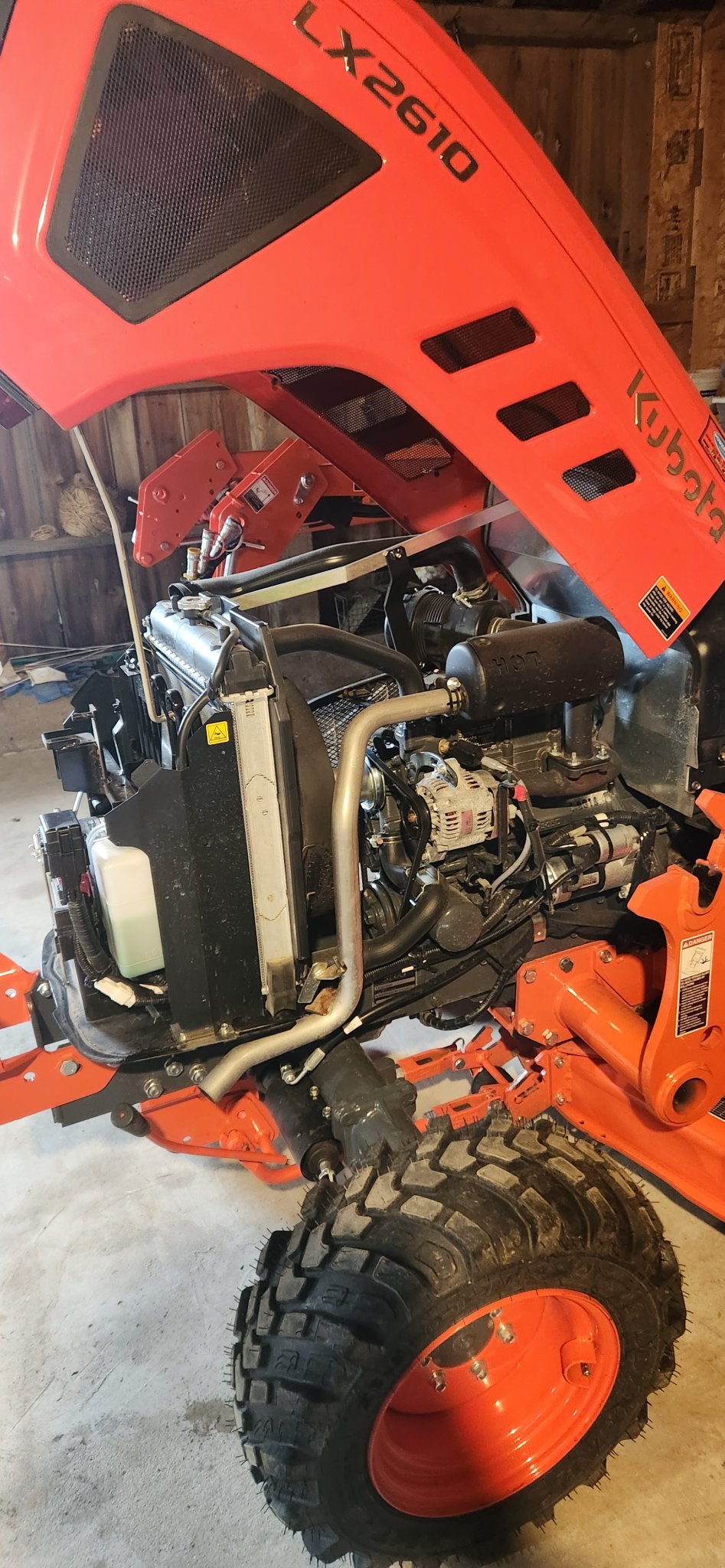

Raise the hood
Remove the side panals
Losen 4 (2 on each side) 10 mm bolts with a socket and extension.
The dash is supposed to wiggle right out he said.......it was loose and some play but didn't " wiggle right out"

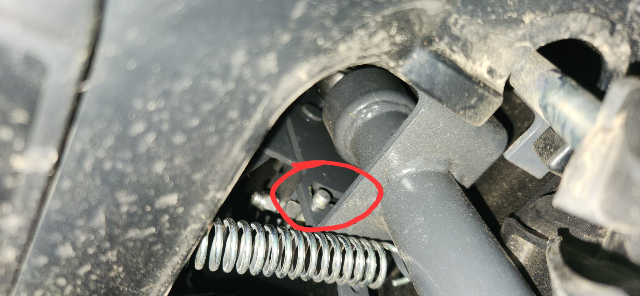

I climbed up onto the tractor and removed the steering wheel boot and the spring was right there!
The spring was a lot bigger than expected and had a ton of tension. One thing I noticed on the tractor tilting the wheel forward I let it slide through my hand and it slammed up.............I'm pretty sure I could launch a cat, or fruit or something across my property with the amount of tension the steering wheel has letting it slam forward.
Looking at the latch it seemed grooved out and no paint obstructing it.
I decided to remove the spring all together. Yes Kubota put it there for a reason but I feel like I can push a steeringing up 2 inches. I'd rather do that, then keep pulling it down every 10 seconds to 2 minutes. It was rainy so I only took the tractor for a quick 2 minute ride. I bounced around in high gear with it staying. So maybe problem solved. Too short of a spring, making tension pulling the the steering wheel up?
