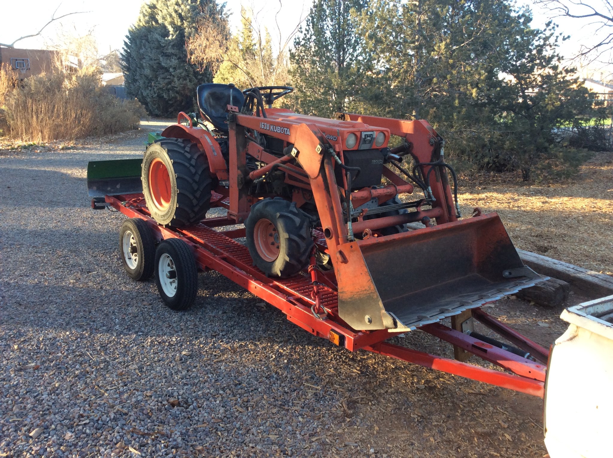

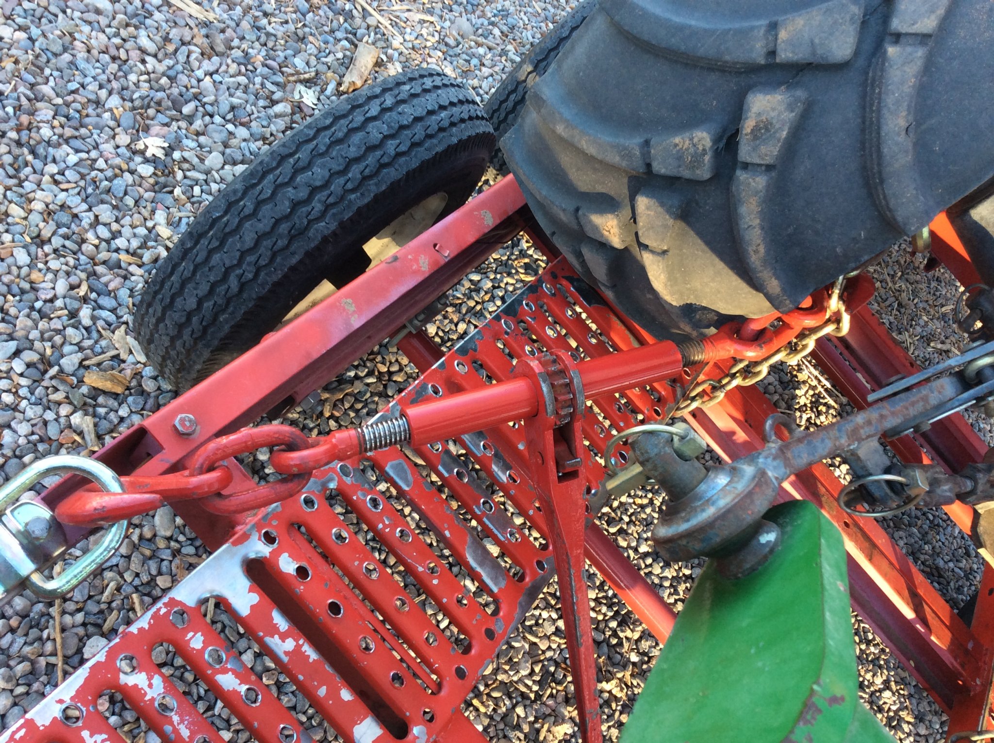

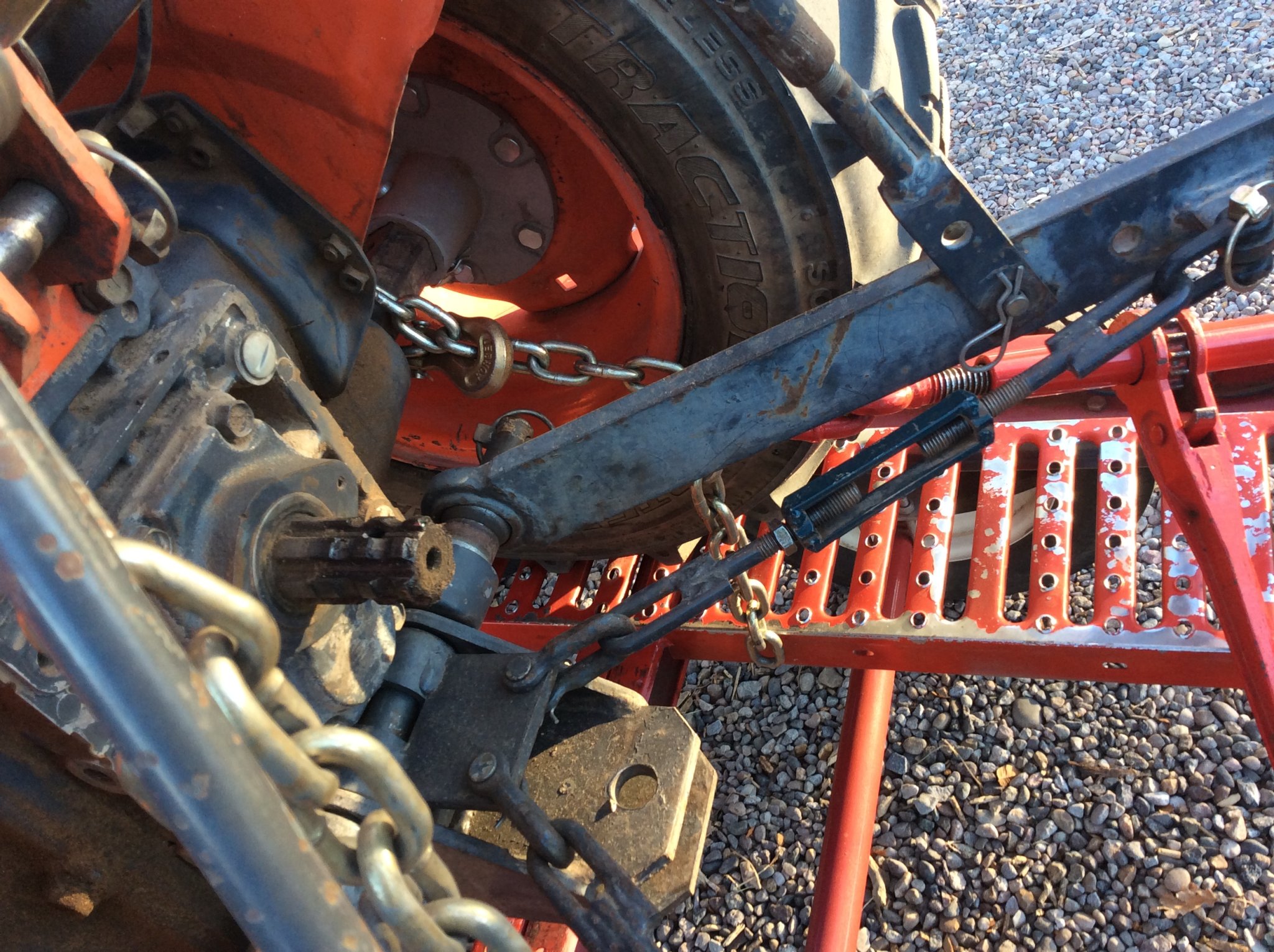

On mine I connect 2 straps to the frame in the front, and cross them making an X.
On the back I put a D ring in the tow bar and connect 2 straps.
I set the brakes and keep it in low range. Any 3 point attachments I lower onto the trailer.
Never had any movement when hauling,
