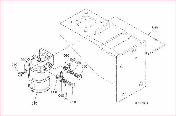

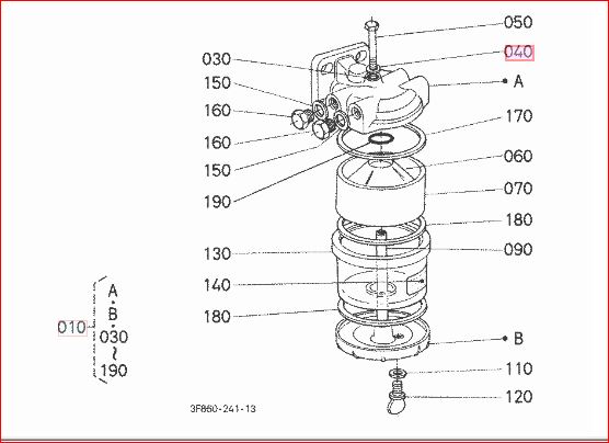

It called a sedimenter and it's in there somewhere. ;)

You correct I found it and it was clean. I started it this morning and it wanted to hunt a lot and when I stepped on the fuel it puffed white the I let it idle for 5 minutes and during this time it then stalled. I pulled the fuel filter off and it was empty. I filled the filter back up and tried ti start it but to no avail. Quick shot of fire fluid and it slowly sputtered till it finally started idling. All during this time if you tried pressing the fuel pedal it did nothing till it was running smooth and then the pedal worked. Possibly the fuel pump?
Your thoughts
