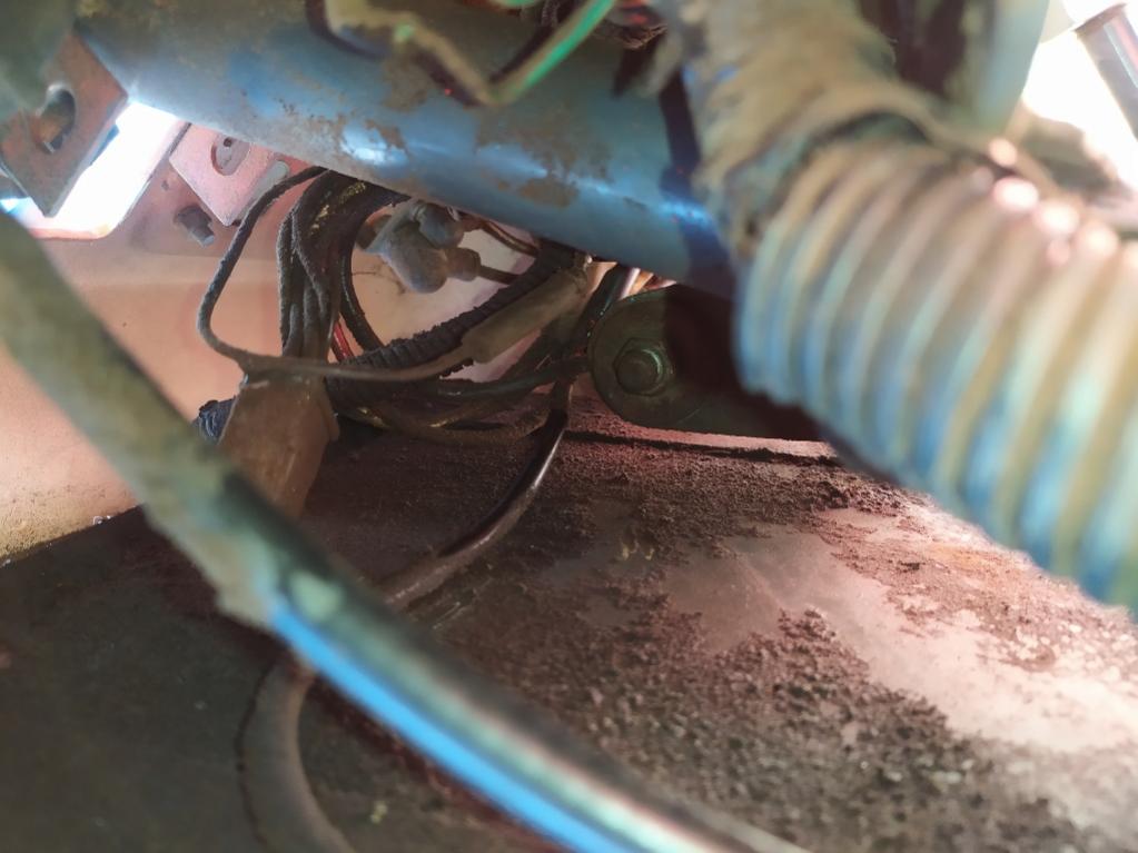

Under he dash you will find a nut a spring washer and a flat washer that control the tension on the lever. ;)

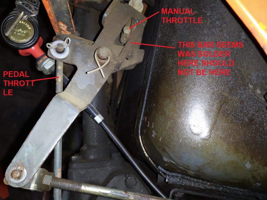

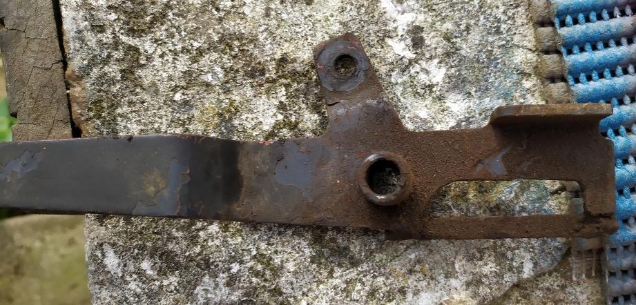

Dear All
My Uncle has the B7200 4x4.
And a few days ago I drive it and I could see that the throttle does not work well.
After inspecting the connection between pedal throttle and manual throttle, something is not good.
Can some one please confirm with the photos that something is wrong?

Carlos,
You are right, that bar should not be welded (soldered) on there.
Doing so makes the foot pedal throttle move the dash throttle, not good.
They might have done it because either the spring on the foot throttle pedal is broken and will not return on it's own, or the nuts that hold tension on the hand throttle are loose and will not hold it in position.

Sorry I don't have a good picture of it, but everything else looks to be correct in your pictures it's just the added bar that's wrong.

Dear All
Finally I could resolve the throttle.
After a hard work, because at the first I thought that I need to add a spring to fix it and it does not work.
Then I could see a nut in the other side of the throttle and after analyse it I could see the it needs to be screwed to fix the throttle
best regards
