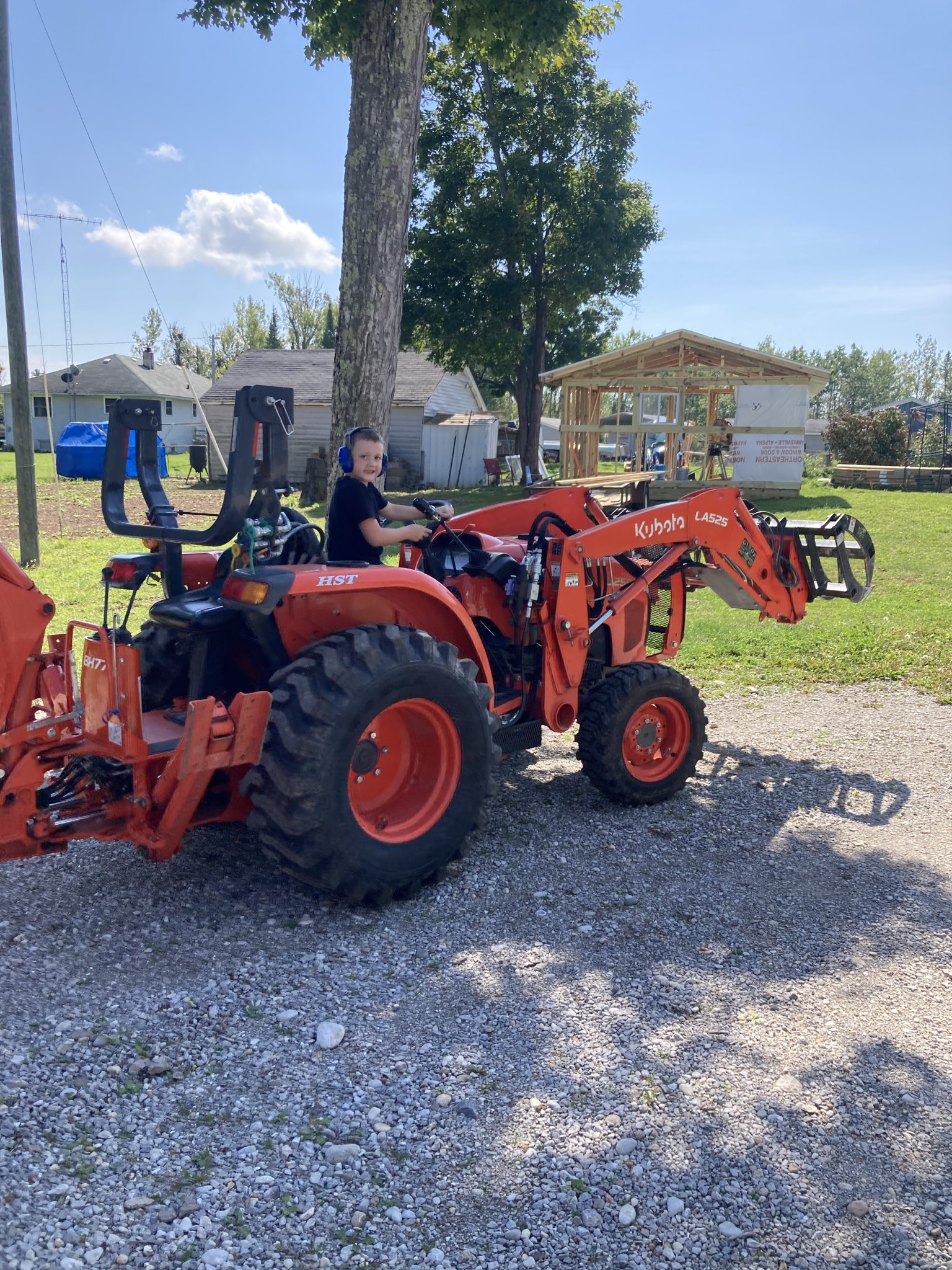

FWIW, My 2501’s throttle has always been “pretty stiff”, and since I don’t use it everyday, sometimes it “seems like” it is harder than other times…..but I think it’s just "in my head”????
I think they need to be stiff due to the vibrations they incur.
However; the terms “pretty stiff” and “harder and harder” are difficult to “quantify” so theres that too…. 🍻
EDIT: I will say this: When my grandson jumps on the tractor, he just "yanks that bitch” and is off like a rocket…….:p ;)
