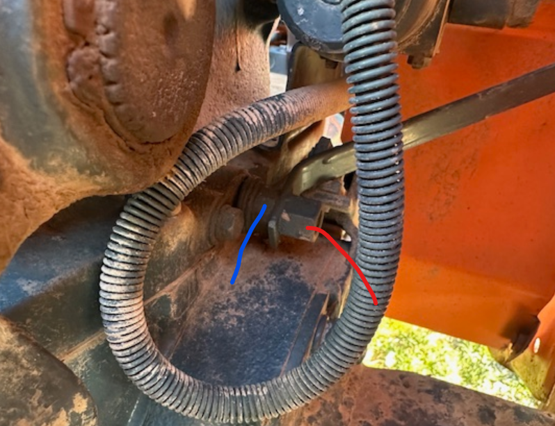

My three point lever is so loose it just falls to bottom. How do you tighten it so it can properly be used. Thanks. Its on my L2202DT
34,617
9,845
There is 2 adjustment nuts on the lever shaft that adjusts that drag function.
Take some pictures of your linkage and I'll point out the right ones to adjust.
34,617
9,845
I think on that model you loosen the red nutt then snug up the blue nut, do not over tighten it.
