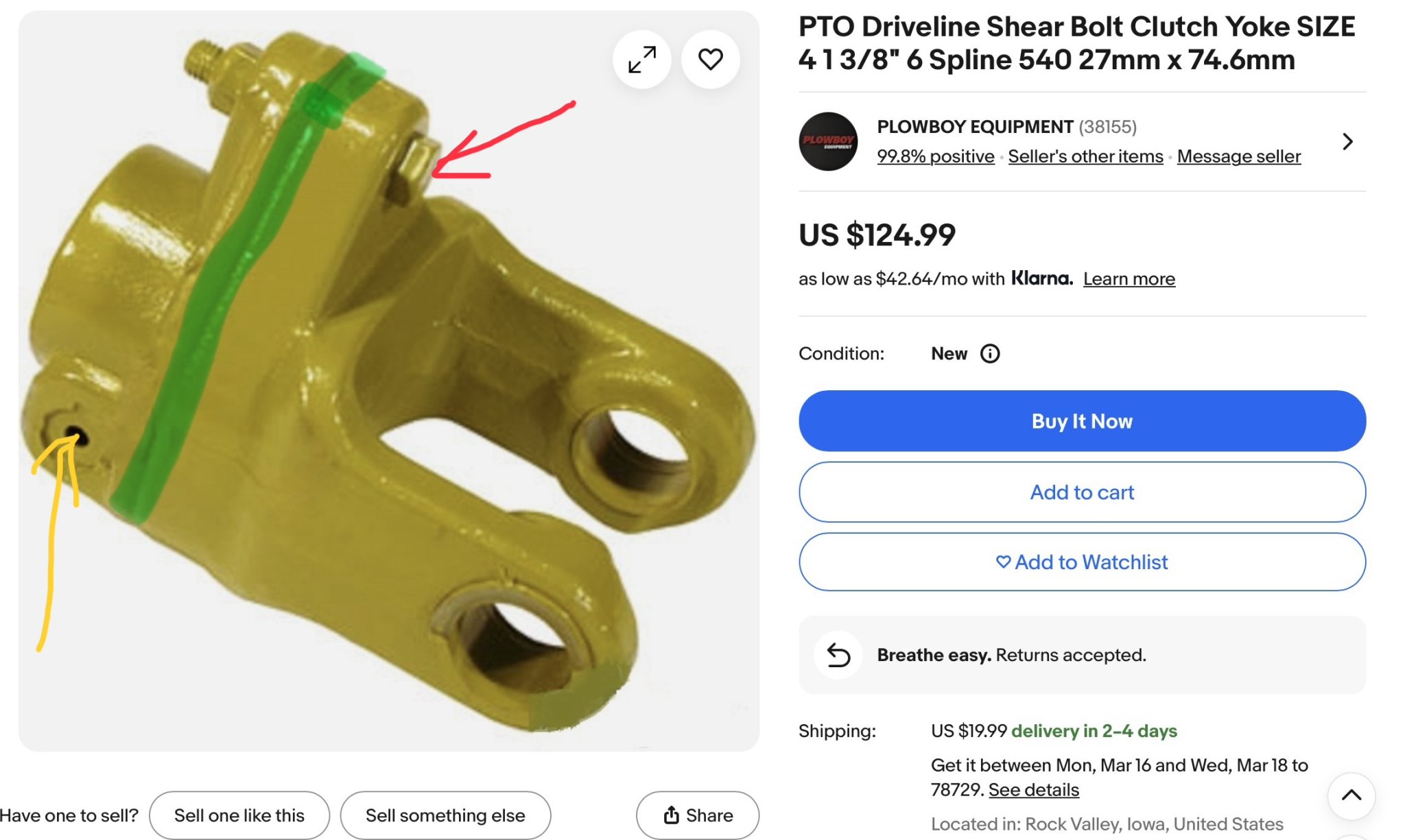

There is (probably) a shear bolt at the tiller end. See the picture below for an example of what might be there.
Red shows the shear bolt. Green shows the shear plane that probably has ball bearings inside to hold it together. Yellow is the retention bolt/pin/???. The tiller would be on the left side of this picture.
Shear bolt yokes go on the tractor side of the shaft not the implement side.
This is really useful. If i can find a shaft with this built in shear bolt - that's also the side with the larger tube, i'd be in business.
i've never tried to disassemble / reassemble the two halves of a yoke, is that daunting?
Interesting, mine was mounted at the tiller end. I guess the PTO shaft could be mounted either way though. I will read through the tiller manual to see what they say just out of curiosity. (I got the manual from the manufacturer after I purchased the tractor and tiller so the previous owner may have installed it backwards.)
The shear bolt on my shredder is at the implement end though by design of the implement.
