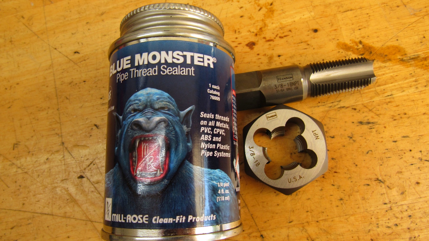

I recently did battle with some china pipe threads and found the Blue Monster thread sealer to be the solution for me. I also had to chase the the threads both male and female. Some the tap and die went in and on smooth and some took a couple turns near the end to straighten.
I used Aviation Permatex on gas and oil fittings for years with no leaks. It was no match for the inferior pipe thread fittings I encountered on my last project.
