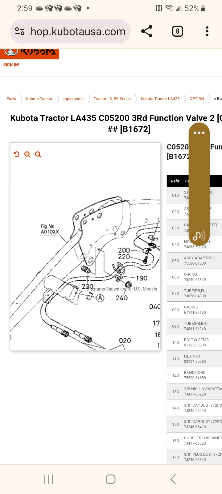

Dsn
Robert Sullivan
B2602 TLB
Jun 3, 2026
NE Ohio
Just a friendly FYI: the hard lines Kubota refers to in the B1672 kit are the lines from the tractor to the manifold, from the manifold to end of loader are molded soft lines to follow the contours of the loader.
