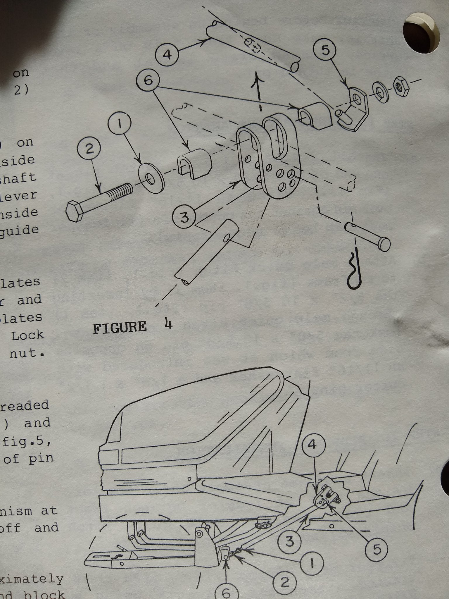

I purchased a g1800 with tg2742 snowblower this year. I am able to connect snowblower to g1800 but i can not figure out how to connect to raise and lower it. If any one has any pics or advise that would be greatly appreciated.
Thank you that is how I thought it would hook up. I am missing lifting arm and cross rod. My hydraulic lift has no power to push down. Deck goes down due to weight. I am adding a winch to the front to lift.
