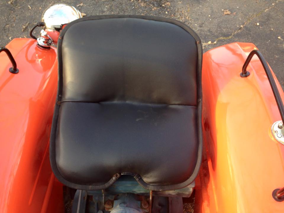

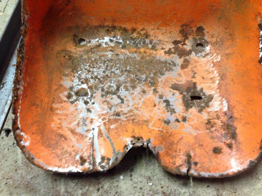

I'm in love with my gray market Kubota L2000. She needs a little cleaning up, straightening and polishing, but that's all going well. I have recovered the seat, welded and repaired the fenders and seat pan, painted the seat pan, fenders and dash (hood is next), and torched the steering wheel (like Vic showed in his video) to make it shine like new. It's not perfect, but it looks great from Ten Feet, so I'm referring to it as a Ten Foot Restoration.

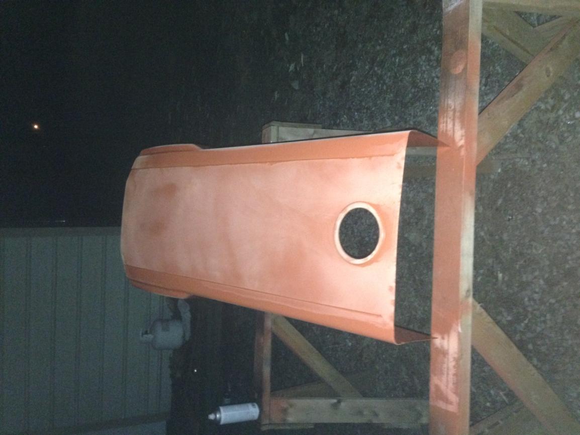

I made some more progress on the body today. Got the hood sanded down, re-welded the cracked joints, removed the rust and labels, and got a first coat of paint on. An interesting find: removing the large Kubota L2000 labels I found that the metal had rusted to the point of pitting along the letters. Not sure why, but I applied a couple coats of Vapo-Rust (awesome product!!!) to kill the rust there, along the seams and anywhere I found rust, then cleaned it all off with some paint thinner.
The first coat of paint went on well. I mentioned this as a ten-foot paint job, right? I'm quantifying that by measuring the DPSF (drips per square foot). Since this is the hood, I'll probably fine sand the couple drips I got before a final coat.

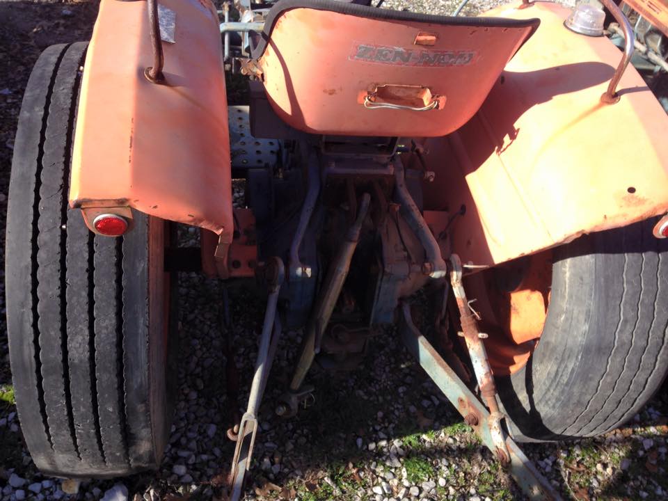

In that one load I got a one bottom plow, a 6 foot disc harrow and a hiller/bedder. All getting ready to break ground and start my garden next week (if timing and weather works).
My only concern is that the disc harrow is a one-point hitch, so will cut in while being towed from place to place and at the end of each row. I'm working on a mock-up that will allow me to use my hydraulic lift arms with chains connected to the far corners of the disc frame to at least lighten the load. Of that won't work, I think I'll put some 12" wheels on the disc frame with cam arms so I can lock them up or down for use.
I'm also drawing up plans to put auxiliary hydraulics on the tractor, thinking the main shaft that extends from the front of the engine would be the best place to drive a hydraulic pump. I want versatility from the hydraulics so I'm looking at a 6 GPM unit and a control valve for two functions. My question is: is the hydraulic universal fluid in the transmission sufficient for supplying this auxiliary system, or do I need to add an auxiliary storage tank?
